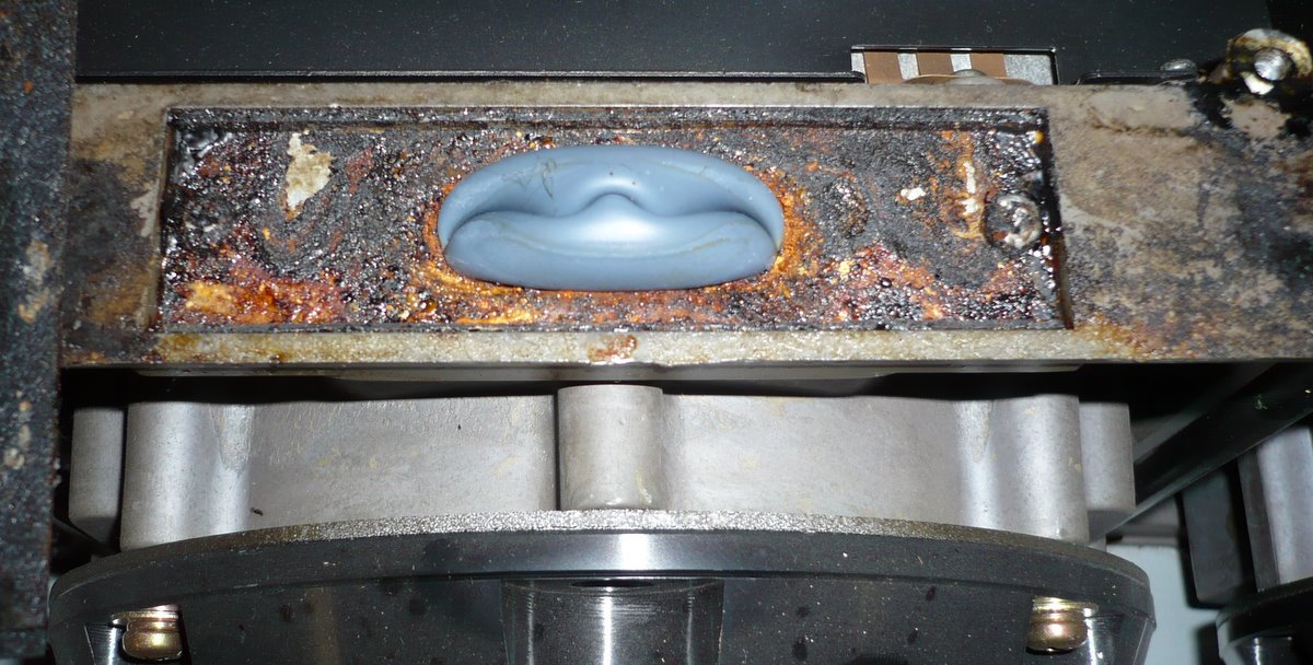

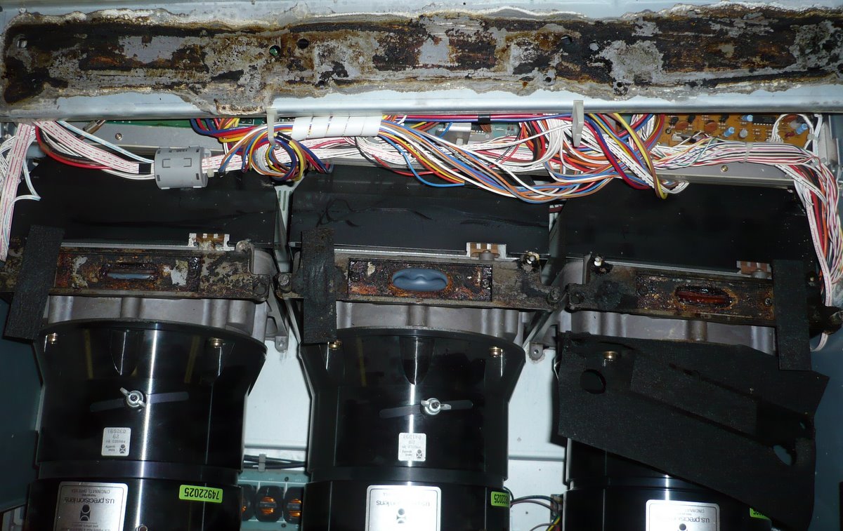

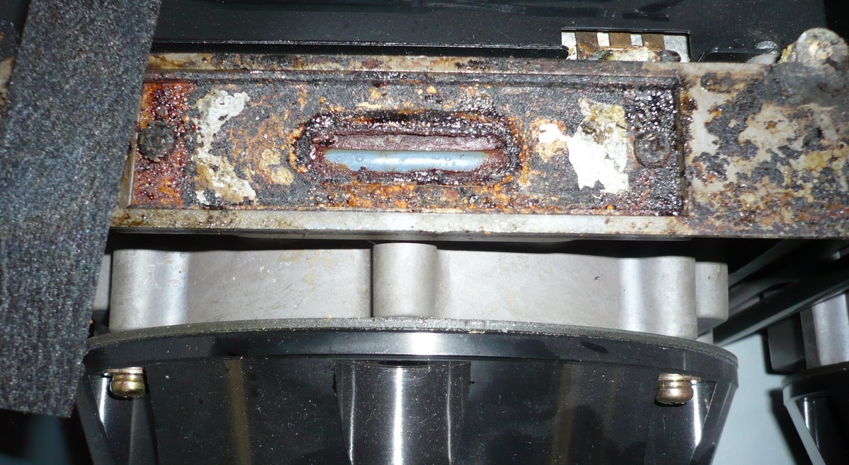

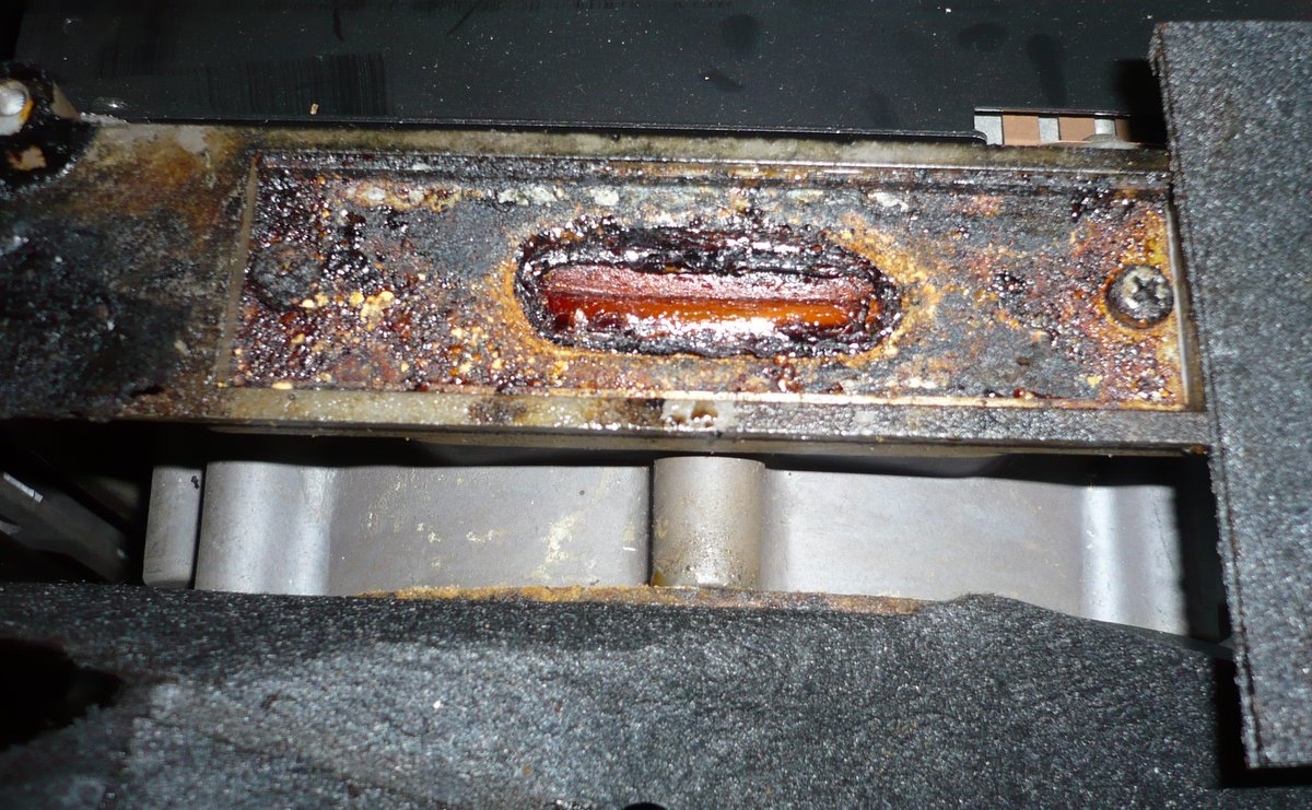

During downloading the service manual of GP-3000, I start looking around again in the Pj and then I found this...
I am not familiar with LC Projectors, but what the **** is this?

Posted: Wed May 12, 2010 5:25 pm    Post subject:
that's glycol which has leaked from the bellows and has potentially caused corrosion on any circuit boards it may have spilt on.

Posted: Wed May 12, 2010 6:47 pm    Post subject:
Yes, of course... but why are these LC-tubes so leaky? Boards have no corrosion...

Posted: Sun May 16, 2010 9:46 pm    Post subject:
There looks to have been some significant amount of leakage. If there is no signs of corrosion on any of the boards it's because the projector was mounted on the ceiling when it happened. Is there stains on the inside of the top cover? Take a flashlight and look in through the lenses for signs of a large air bubble. That's the one that leaked. At that time, also look at the condition of the tube faces. If there is signs of wear, I'd cut and run. If the tube faces look OK, I'd continue on with trying to get it running. I would not spend any money on re-sealing the tubes if it can't be made to run.
