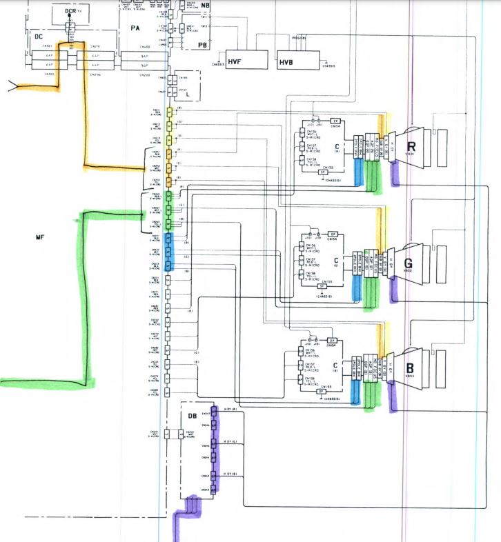

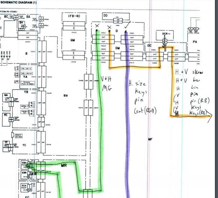

OK, G70 community. I have a puzzle to figure out.
Most of my convergence controls do not work. As I change the value on the screen, the physical picture does not change.
For each tube, its the "Sub DY" and "MG Focus" on the tube neck.
I have narrowed it down to only a few possibilities of what is wrong.
So far, I have replaced the D board (Focus), replaced the 2 large convergence chips on the DC board, and have resoldered all connecting pins on both boards.
Possibility #1: Either the connector between the D and DM board or the connector between the DM and MF board is messed up.
Possibility #2: My DC board and EB boards both have total failure of their control functions and is just two separate problems.
[/img]
Anyone have any experience with this issue?
Purple: everything works except H. Lin
Green & Orange: none of these controls work
 Filesize:  101.02 KB
 Viewed:  6685 Time(s)
 Filesize:  79.91 KB
 Viewed:  6687 Time(s)

Clearly, an oscilloscope would be the greatest help here.
Diopter_Doctor
Joined: 24 Sep 2019
Posts: 36
Posted: Mon Nov 09, 2020 2:26 pm    Post subject:
Any good resources where I could learn about using an o.scope with video equipment? I've used one before and know how they work in general but need a little help knowing what to look for and how to fix a problem.
I just took my G70 apart and made sure the connections were good with continuity check.
Is it possible that it could be a control issue (Ya/Yb boards?) even though the screen shows the values changing without the picture moving?
Posted: Tue Nov 10, 2020 6:58 am    Post subject:
The idea would be to follow the generated convergence signals by the oscilloscope. Usualy each correction signal is generated separately around the CPU board, then they are summed together. These summed signals are sent to the convergence power amplifier board. An oscilloscope would be helpful in tracking down these signals.

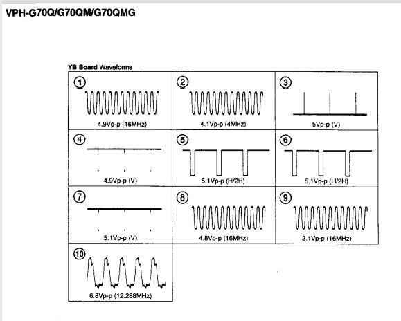

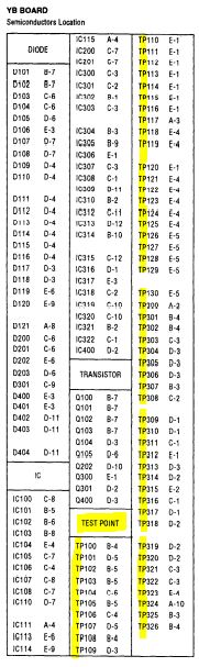

On the service manual it shows a few waveforms to check for but there are many more Test Points that I don't see what value they should be when checked.
I'm looking at the Yb board which contains the CPU chips. I don't see any controls labeled for convergence on the board although it connects to the D board (focus) (those points ARE working) and to the DC board (convergence) (those controls AREN'T working.)
