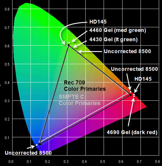

Person99 wrote:
The funny thing is he is talking about how great a CRT is on HD and they can't even do proper HD colors, they all fall short of Rec 709 color points!!!!!
OK, if you're gonna start calling bull****, so am I. Mr. Green
The Rec709 coords are:
Red: 0.64 / 0.33
Green: 0.30 / 0.60
Blue: 0.15 0.06
The coords on my Marquee 8500 with color-filtered HD145 lenses (as measured by 2 colorimeters) are:
Red: 0.668 / 0.330
Green: 0.304 0.588
Blue: 0.133 / 0.051
The pic below shows my measurements vs. the SMPTE-C coordinates. I've added the Rec709 coordinates (black dots) so you can see how they compare.
You can see that the green coords are a near-perfect match, while the blue and red are comfortably *outside* the Rec709 coords. There is nothing that prevents this projector from displaying all Rec709 HD colors, and the same should be true for any properly color-filtered CRT.
