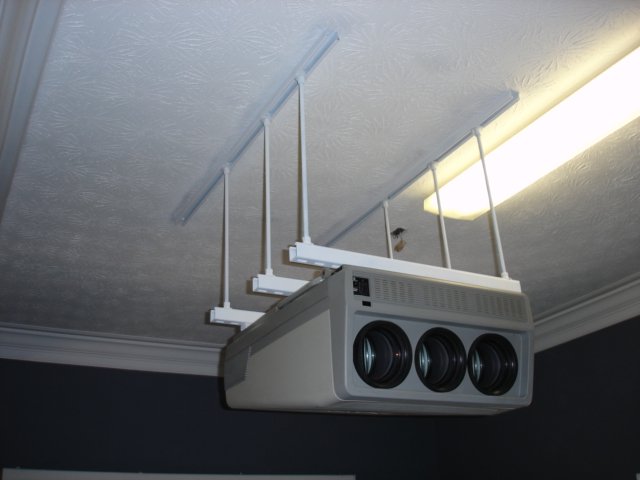

Posted: Tue Mar 30, 2010 2:34 am    Post subject: this ok?
I got this from Mr Mad H from the Uk not specifically directed to me but for another guy just wanted to see what you guys thought. There will only be two unistruts on the pj though going from side to side I dont think you can attach three and I cannot find 50mm Unistrut only 41mm slotted. What do you guys think, on the right track? The picture below is what MR H was trying to explain.
2 x Ceiling mounted "DEEP SECTION Slotted 50mm UNISTRUT" 1-2m long each.
3 x PJ mounted "DEEP SECTION Slotted 50mm UNISTRUT" width of projector
6 x "10mm Threaded rod" length to suit drop required
Ceiling sections
6 (or 8) Number 8 size x "Coach Screws" - mount unistrut to ceiling approx 150mm long IF used through the unistrut, 100mm Long if bolted within the unistrut, within looks more tidy BUT you need a socket set that will fit within the unistrut channel.
Either 6 "Square Washers" for mounting "Coach screws" above the unistrut OR 6 normal washers for mounting within unistrut.
6 x M10 "channel nuts" - Go witin the unistrut, threaded rod fits into these
6 x M10 "Square washers"
6 x M10 "standard nuts" (NOT! Nylock type)
Projector Unistrut section to threaded rod
Projector Unistrut section to Projector
6 x M10 "Set bolts" - length could be 25mm to 80mm depending if you want to bolt within the unistrut OR have the final "Nylock Nut" on top of the unistrut (easier to work with)
6 x M10 "NYLOCK nuts"
12 x M10 "Washers" if inside the unistrut - OR 6 x M10 "Washers" AND 6 x M10 "Square Washers" if final nut is on top of Unistrut
