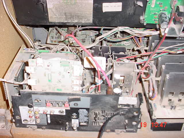

Posted: Fri Jan 21, 2011 10:13 pm    Post subject:
Hello Curt:
I dont know it..
but first all Im going to perform a step by step check list & review in the main power supply & Auxiliary power supply operation Shocked

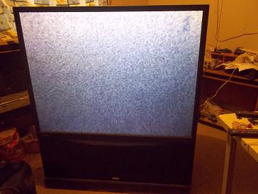

Posted: Wed Apr 11, 2012 1:23 am    Post subject:
Well..here is my little black beast coming to life..like Lazaro ..stand up and walk!
sympton: Bad SMPS,U14101 damaged,Q14101 and various resistors burned and shorted diodes..also capacitors in the secondary stage.

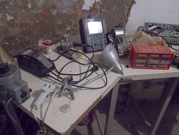

tools to troubleshooter: oscilloscope,multimeter,variac,clips,capacitor tester
