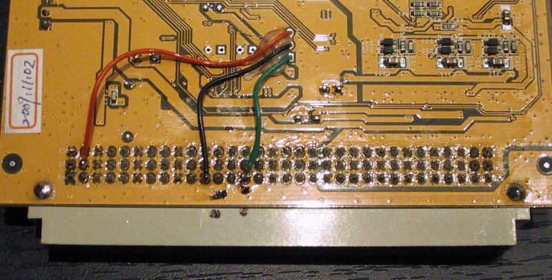

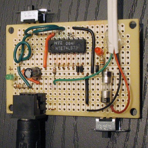

We have been working on this for months now and Lumagen (Pat) sent me the first real functional 3D frame sequential firmware about ten days ago. This FW is working 3D on my G90 very well at the moment with my rigged up sync dongle for glasses output.
Pat finished the timing application in the firmware yesterday. Jim is shipping me a hand built Lumagen sync dongle on Monday that will work with the Radiance alpha firmware for glasses output. Pat already has a timing delay in the software so that glasses timing can be adjusted for any setup.
The Samsung glasses are my favorite so far (I have not tried the X103 yet), but Samsung built a timing delay into their glasses. This results in the top 1/5th of the screen on my G90 not showing 3D (just both frames). Pat tested the new timing adjustments in the Lumagen and he says we can now fully correct this for the Samsung or any other glasses. Lumagen is using a PC monitor for CRT 3D testing in house.
I will have test results on the 26th as I will be in California for ten days starting Monday. Look for the first Radiance CRT 3D release and the availability of Lumagen sync dongles in mid-February. The Lumagen glasses sync dongles will go inline with the HDMI cable. They can go on either output 1 or 2 and they can be used with video only, audio only, or audio and video on the HDMI cable. So you can use the dongle on either HDMI output no matter what the output is sending or not sending Smile

Yes you will most likely need the Lumagen 3D sync dongle for correct 3D even with the Moome. I haven't spoken with Moome in a few weeks, so I am not sure what he decided. I will say that Jim shared the information with Moome on their Lumagen 3D glasses protocol through HDMI. Jim even gave Moome the circuit design to build his IFB to support the Lumagen sync protocol. However, I don't know if Moome decided to incorporate the design in his new IFB or not (I need to call him).
Originally Moome planned to only get sync timing of the Vsync plus... just like I am doing now with the little board pictured in my last post. This will work, but is not a fantastic solution because there is no polarity data in the Vsync pulse (Vsync looks the same for left and right eyes). What this translates to is that the polarity is backwards 50% of the time (50/50 chance of getting it right). So when you first start a movie, you have to pause and manually toggle the polarity with a dip switch back and fourth until you are sure it is correct. Also, if you fast forward, pause into screen saver, or drop a frame at any time during the movie, you have to redo polarity. This is a real drag.
The Lumagen protocol supports polarity so with their dongle the polarity will always be maintained and can't come undone. Furthermore, with the Lumagen protocol you can adjust phase (delay) to correct for inaccurate glasses timings like with the Samsungs (or to help with ghosting). And with the Lumagen protocol you can toggle polarity in the Lumagen menu when you use your glasses for the first time. This is cool because different brands of glasses need their polarity switched with respect to other brands.
So if Moome does decide to incorperate the Lumagen timing protocol into his board than you will not need the Lumagen sync dongle. But if Moome doesn't use the protocol I can't imagine using 3D long term with the PITA polarity adjustments that are constantly required. You will also be limited to only some brands of glasses unless Moome has a timing delay on the board (which he may do anyway with a trimmer resistor where the gamma trimmer is now). Moome and I have thrown a lot of ideas back and forth over the past several months and I don't know where he landed at the end or if he has even finalized his decisions.
Just an FYI, the Lumagen Dongle will be less than $400.
