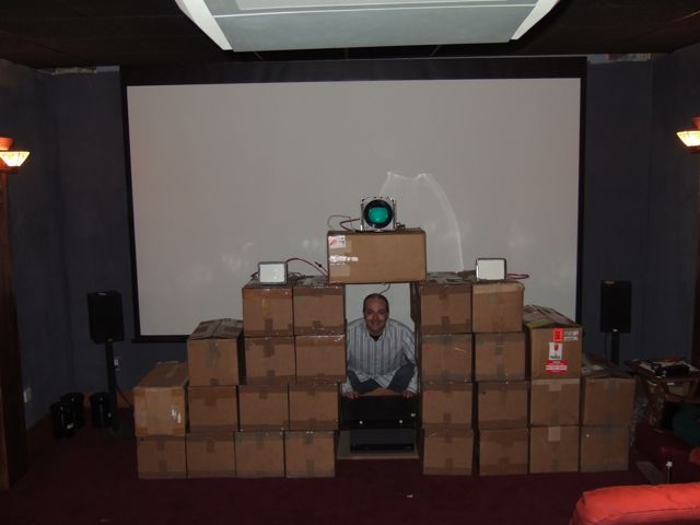

Posted: Tue Jan 12, 2010 2:26 pm    Post subject:
Nope, I bought the remaining stock of new tubes, and a bunch of used ones.
http://www.curtpalme.com/forum/files/got_tubes__175.jpg
Very Happy

Posted: Wed Jan 13, 2010 2:26 am    Post subject:
Your projector is not perfectly level to your screen.
My noting that setup error is a service I have just provided to you. It will cost you one set of those tubes. Very Happy
So, what, did you buy them directly from Thomas?
CJ
Posted: Wed Jan 13, 2010 2:41 am    Post subject:
CJ
LOL, that was my old set up, and actually the way my room was built its elevated off the basement floor, there are 2x10's as floor joists and one end of the room is bolted to the foundation wall along with the back, the other side I had on Blocks. Well i live very close to a main road with lots of truck travel so the fill settled and the floor lowered about 2 inches ( i have 10 feet of fill and 20 foot high foundation walls!!! ) So i need to jack up that corner of the theater every so often.
Regarding the tubes, a guy on AVS posted he had some High Rez tubes used ones that he wanted to get rid of cheap.
Everyone gave him the business telling him only LUG's were high rez. Well I got a few used ones and according to CRT Ben these were the same tubes you sold to him to try , all they needed was a neck board mod. well this guy told me that the company they did simulator service for were retiring the custom Triton 1080HD projector and if i wanted to buy some new thomas tubes he could get me in contact with the owner, well I made a deal and got them all and bought some used ones as well. Chip got the best of my used greens to test with his ampro.
I want to save four sets for my self, not sure how many more I have after that, Cliff might take two set if I have enough so for now I am not selling any till I do a complete conversion for one of my PJ's

Posted: Wed Jan 13, 2010 2:48 am    Post subject:
So, ah... how many lifetimes of tubes would that be? Looks like the beer bottle box forts I used to build as a kid! Cool

Posted: Wed Jan 13, 2010 3:15 pm    Post subject:
Wow...soome of those WERE mine at one time!
Man, I've got to say it...when you don't even remember that you had that pile of stuff yourself once, you've been pretty busy!
I honestly don't remember much about them. Practically nothing, as a matter of fact. Except I do recall rewiring an old 8000's neck
board to run with them and actually ran one briefly without an LC assembly on it. I was just very careful to ground the dag to the
chassis. It looked good but it was hardly a precision test.
I'd really forgotten all about them.
CJ
