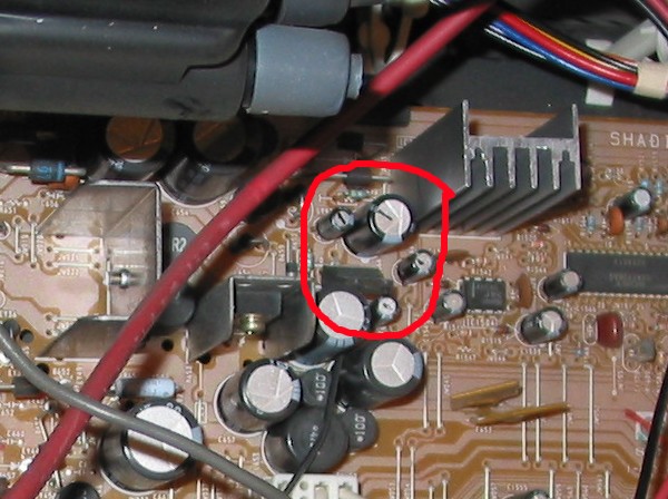

macgyver655 wrote:
The caps I PM'ed you to change stated, change them, dont look at them, dont test them...... change them. Then I said just look around for any visual things.
DOH! Sorry. I miss read that then Embarassed OK I'll go pick up some tomorrow if I get a chance.
Ok I got the visual part right Laughing
do I get 50% on this test? Very Happy
 Filesize:  82.31 KB
 Viewed:  108 Time(s)

OK, see I took an inspection mirror with me, verified that those were the correct values, looked for leakage and swelling including all the surrounding bits and no signs of anything burnt. SO I guess I DID follow your instructions Laughing

By the way, any recommendations on how to fix my oops with the broken bit? I'm thinking a thin wire and lots of hot melt glue ohhh and some solder of course.
Hard to say without seeing what you have but whatever works.

To fix the PCB issue, use superglue for gluing the busted piece back onto the board, let it dry, then scrape some of the laquer off the broken contact and solder the busted connection back together. It will be good as new again.
Superglue hold the PCBs together extremely well. I had to use some to fix a board on my AVR 5805, and also on a 1272Q for the rear infrared sensor (we busted the sensor while mounting the projector, 8 pieces all back into one thanks to Loctite superglue Very Happy)
