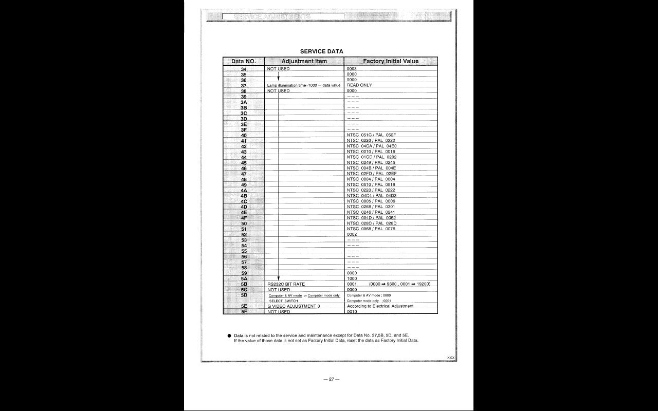

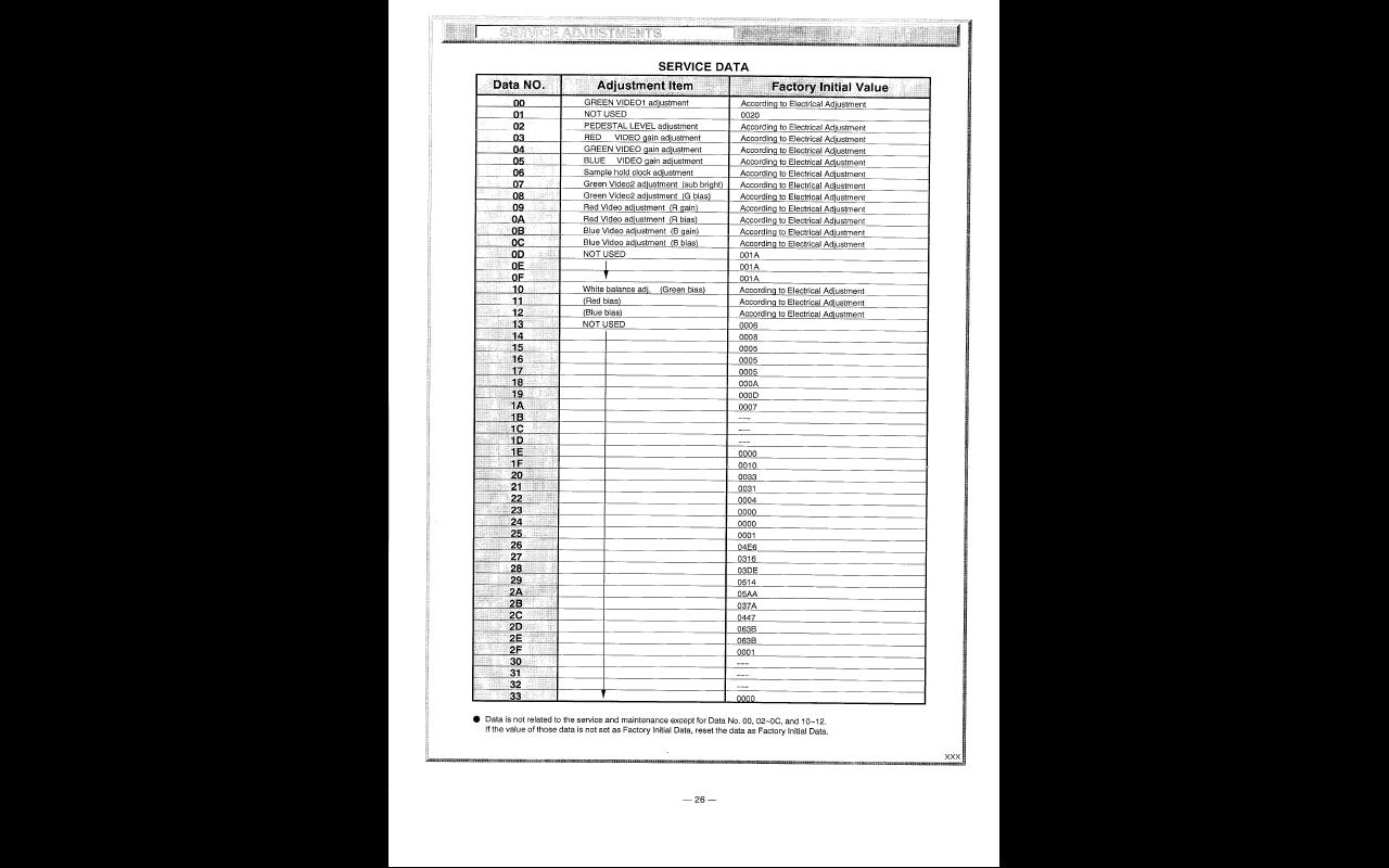

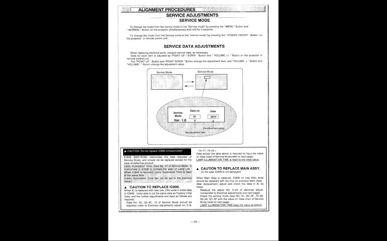

Here is the relevant section pages from the service manual
Page 2 of 2 service data

Service Mode Access - Sanyo PLC9000

Posted: Wed Jan 06, 2010 12:34 am    Post subject:
Thats a pretty lame menu selection. I can show you the Sanyo RPTV service menu with over 200 data selections. There has to be a ghost adjustment section. They are just not revealing it in that manual if thats all the choices you have. Try calling Sanyo.

Thats all there is in this service manual...I guess Im screwed...my bet is Sanyo would not know much about this old dino.
Some Tech somewhere may remember doing this for a Sanyo PLC9000 once before I wouldnt mind betting.

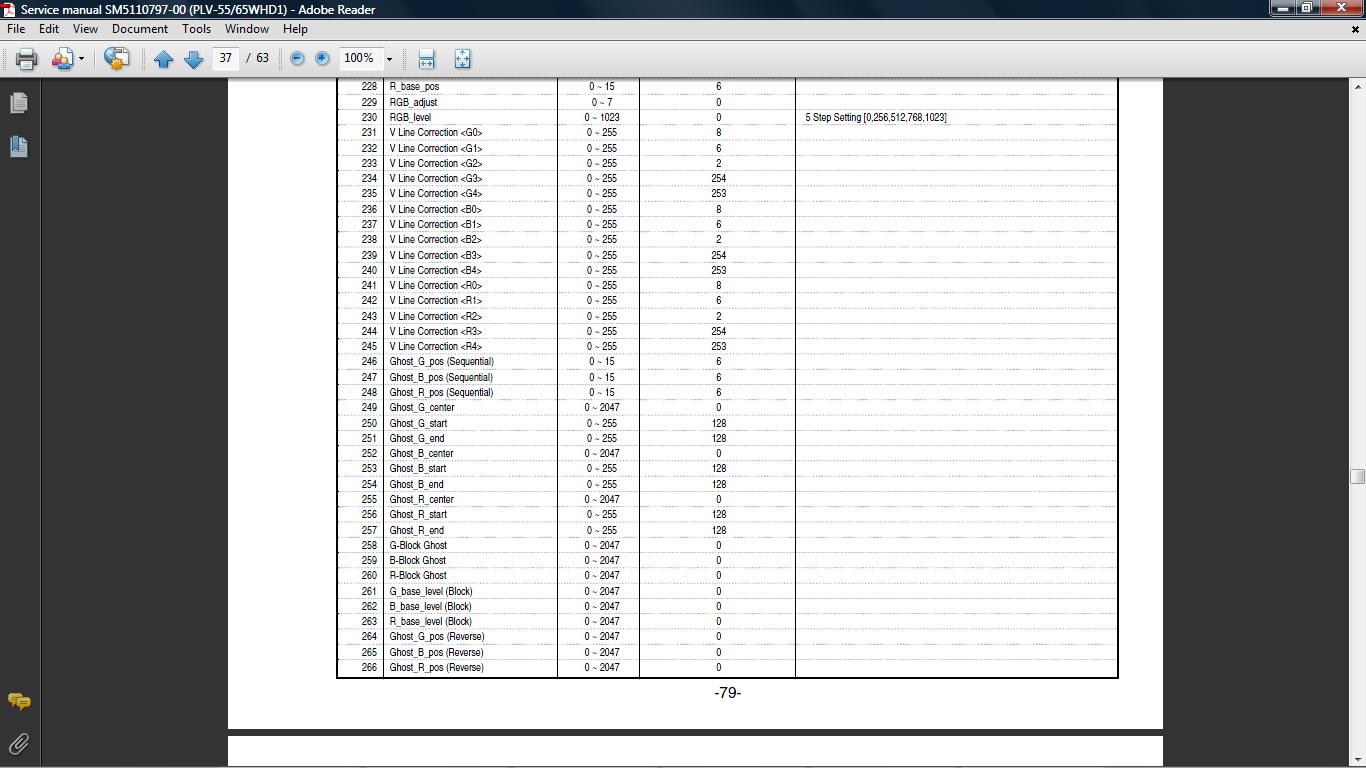

 Filesize:  132.47 KB
 Viewed:  33294 Time(s)

macgyver655 wrote:
Yes, seriously. Ghosting is a common anomaly in LCD projection displays.
Weird. I had no idea. What exactly is that controlling? Is it a timing adjustment in the LCD driver circuit or something? What causes "ghosting"?

Posted: Wed Jan 06, 2010 3:15 am    Post subject:

I have not read what the specific cause is but I've read parts where a new polarizer film helps reduce ghosting so I'm assuming its may be a type of reflection. If I get some time I'll check some training stuff and see if it explains ghosting.

I did a quick, short read and apparently its has to do with the speed that the pixels are switched on and off in the panel. I'll assume then that the adjustment would alter the speed and based off the page I posted above it may also alter the speed in various locations of the panel. But like I said. I just did a quick read.
