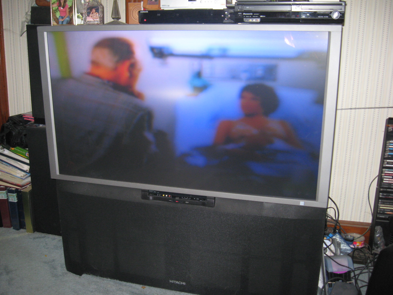

Posted: Wed Dec 23, 2009 5:09 am    Post subject: hitachi 57f500a pictures
pictures

Posted: Wed Dec 23, 2009 5:42 am    Post subject:

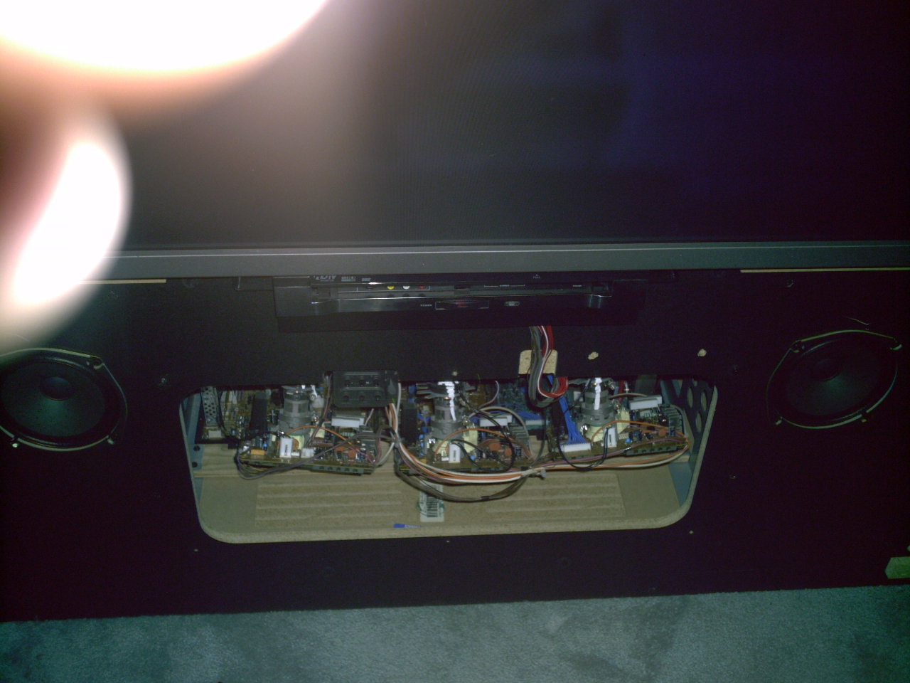

Yep, looks like focus problem. Without getting real deep in this just yet, try adjusting the electronic focus adjustments. Pull the front grill off. There is probably a door there that is screwed on. Remove that and at the top center you will see the screen and focus block. Bottom row of adjustments are the RGB focus, in that order. Go into the magic focus and set it to manual, then separate the red and blue grids from the green. Now go to the focus adjustment block and see if you can focus all 3 color grids. If there is not enough adjustment to bring in the focus then post back with the results. I'll check back in the morning.

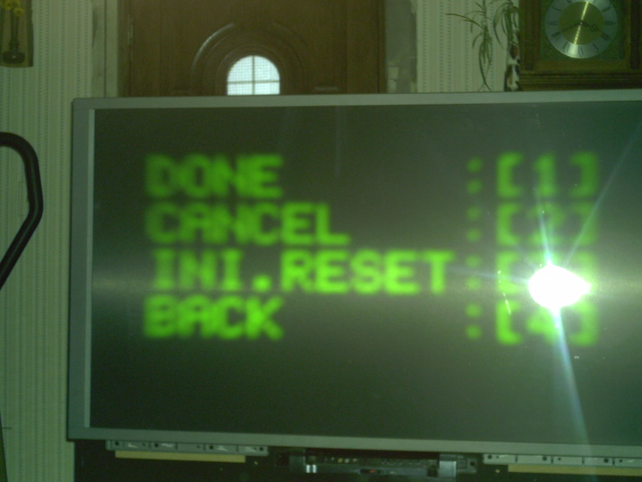

I need help. I'm into the manual focus and see a white grid. I can move the cursor around while it is white, but when it is red or blue I can't move it around the grid. How do I separate the red and blue grids from the green. I don't see the grids changing color. If I press the select button, the cursor changes from white to red, then blue and back to white. I don't see any color change in the grid and not even a green cursor.
I see the six controls, is it the bottom row that I'm working with?
thanks for you help. I'm attaching a picture. Mad
ED

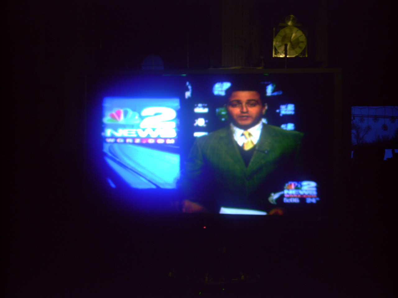

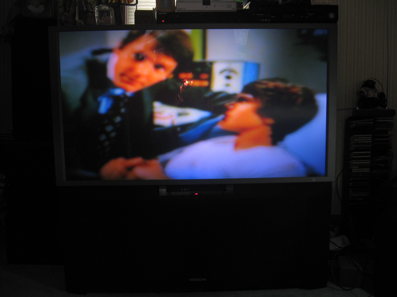

Posted: Wed Dec 23, 2009 9:07 pm    Post subject: hitachi 57f500a
thanks mac ..... 95 percent better .adjusted red blue did not see a sperate green grid .pic attached.is there a way to go back to factory settings. changed these manual when the blurry problem started want to go back to factory setting???

Posted: Wed Dec 23, 2009 9:21 pm    Post subject: hitachi 57s500a
thanks mac your the best tv watch able now thanks again. i have one other ?what the purpose of the top row of control there mark screen r g b do they need to be adjusted???
thanks for your time and help

To separate the colors in the grid you put the white block in the center, then change it to red or blue. Once it is a color you use the 2,4,5,6 buttons to move the parts of the grid. This is how you converge to 3 colors on top of each other correctly.
As for that green focus, is the adjustment turned all the way in one direction to get it there? Or is that the best it gets without getting to the end of the adjustment?

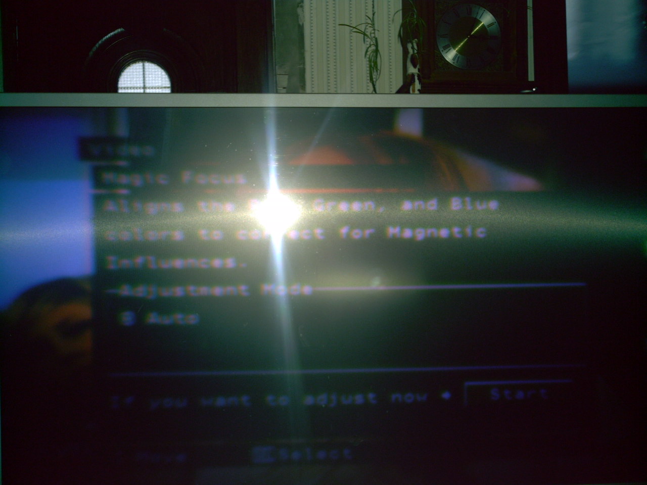

Did you try running the magic focus with it set on auto?
bigedtheman
Joined: 22 Dec 2009
Posts: 14
Posted: Wed Dec 23, 2009 11:12 pm    Post subject: hitachi 57f500a
magic focus work fine when tv 1st started get blurry i adjust contrast color etc with remote .want to put back to before i change them . is the auto color what does that ??? tv looks good ad just green control some more.
thanks mac thank you
