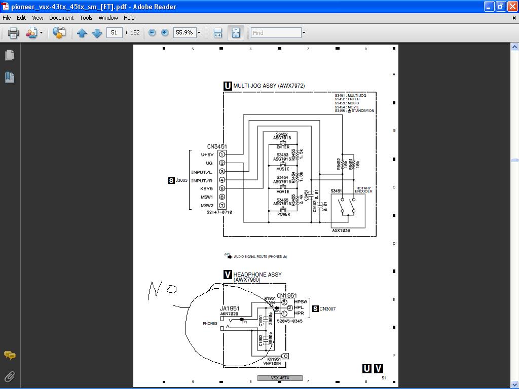

I dont know where you read that in the manual Wan but that receiver does not have a disconnect style jack. And that is also why there is a speaker on/off button right next to the headphone jack.
Give me the page number where your read that.

I think I found where you read that Wan but it doesn't make any sense.

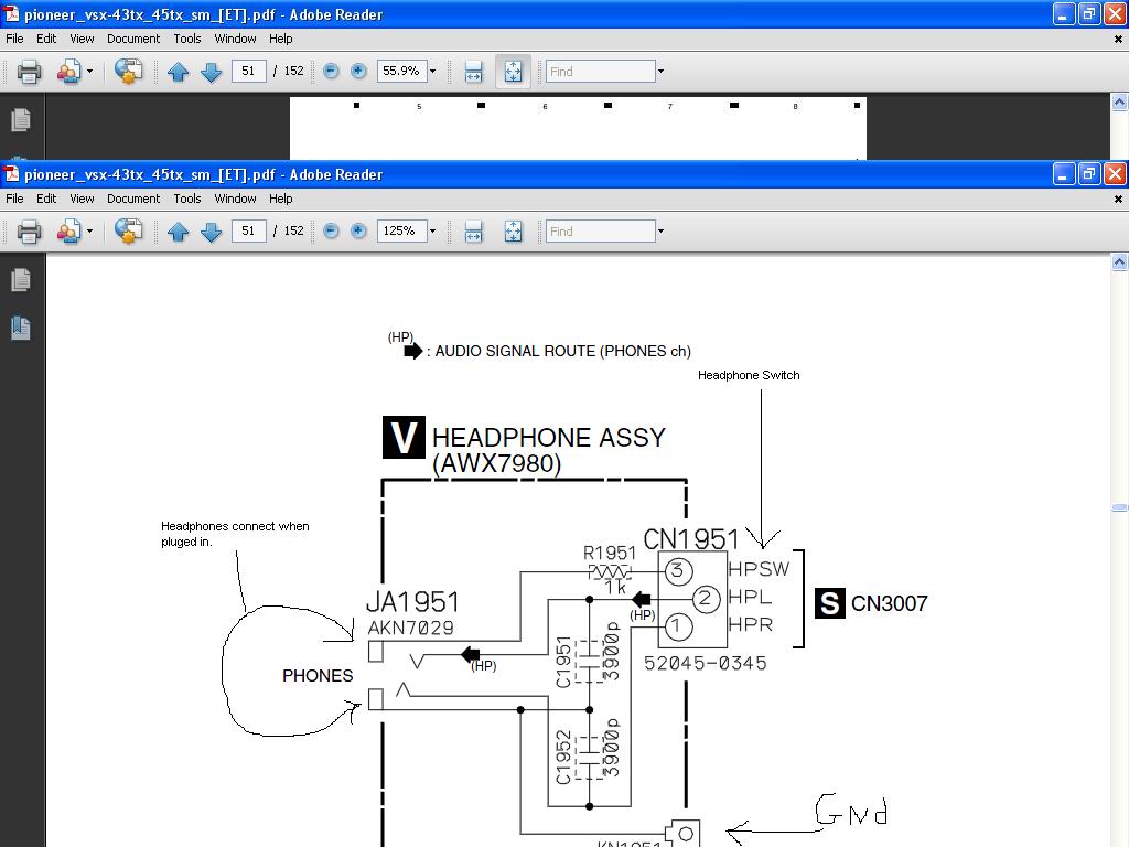

In looking over the schematic more it appears as tho it should shut off the main speakers when the phones are plugged in. If its not shutting them off the maybe the gnd screw is loose, the headphones are not making enough contact to connect the switch line to gnd, or the circuit is not functioning properly. With the phones inserted it should connect the switch line to gnd.

Yes there is a button and I pressed it. Each time it displays HEADPHONES but doesn't kill the speaker output. BTW, page 55 of the owners manual:
Plug headphones into the headphone
jack on the front of the receiver.
No sound will be audible from the speakers when
headphones are plugged in except in MULTI CH IN
mode or when using the pre-outs. In MULTI CH IN
mode the subwoofer will be audible even if the
headphones are plugged in.
I could be mis-reading this. Oh, and thanks for the assistance Mac, much appreciated. Thumbs Up

Interesting. So your not using the preamp outputs with separate amps, and headphones wont shut off the speakers and the speaker switch wont shut off the speakers.
Sounds like it needs the bench. The speaker switch should definitely shut off the speakers.
Posted: Mon Jan 24, 2011 1:51 am    Post subject:
Palm to face. Yes, I am. And thank you very much for reminding this brain of mine. Ok, so the simple (ahem, moron) solution is to just turn off the multichannel amplifier.
Dear god can I be dumb! Embarassed

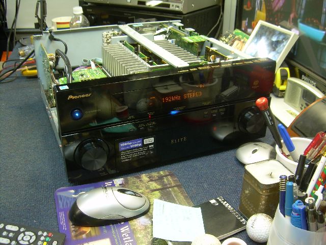

Ahh, doesn't this just look purdy sittin there just purring away?
A shame its just going to be a test unit. I like buying broken stuff. Very Happy

Posted: Wed Jan 26, 2011 12:15 am    Post subject:
Hey!!! That looks just like my old unit!!!!
Thanks again for fixing mine!!!
BTW, I could come up with about 500lbs of "broken stuff". Let's make a deal!!! Laughing
wallace
