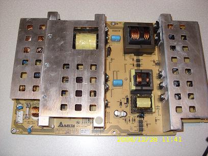

Can you post a pic of the power supply and any numbers on it. I may be able to get a print by comparison. The main manual doesn't have a print.
Posted: Sat Jan 16, 2010 9:52 pm    Post subject:
Is this what your power supply looks like?

Posted: Sat Jan 16, 2010 10:05 pm    Post subject:
Disconnect the harnesses to the 2 inverter boards and see if your 24v comes back up.

Posted: Sat Jan 16, 2010 10:06 pm    Post subject:
Not exactly. my part number is 0500-0507-0260. there is also a part number by the line input. DPS-47APA REV: S3

here is my power supply

Posted: Sat Jan 16, 2010 10:18 pm    Post subject:
It should be: DPS-475APA
Is that what it is?
Did you try disconnecting the inverters?

your are right. I forgot the 5 in the part number. I disconnected all ouputs of the power supply and checked the 5v 12v and 24v. I got the same results. Only the 5v worked.
Posted: Sat Jan 16, 2010 10:38 pm    Post subject:
Dont disconnect all wires, just the harness from the power supply to the inverter. How many inverters does your set have? This model actually has over 3 variations with different supplies and inverters.
Also does the 24v come up for a few seconds when first plugged in and/or turned on?

Posted: Sat Jan 16, 2010 11:17 pm    Post subject:
Your model should have 2 inverters, a master and a slave. They would be the long skinny boards, 1 to the outer left side and 1 to the outer right side. Dont touch these boards when the set is plugged in. Just disconnect the power supply harnesses to these boards. The connectors should be marked with 12 or 24v, 5v, gnd, bl on/off and PWM dim. Here are some pics.

i plugged the power supply back in and connnected the audio board (i think) and the main board. I left the two inverters unplugged. I did not get 24 v out of the power supply to the two inverters. the 12 volt out does not go to the two inverters it goes the main board only according to the power supply board writing.
Posted: Sun Jan 17, 2010 12:10 am    Post subject:
Some inverters run off 12v and some off 24v. So that's why I said either/or.
It does seem to point to the power supply. If you heard a pop sound then it could be a cap or a regulator/fet.
If it was a cap that popped then it should be visual like a vented top or split case. If no evidence of a cap then you should be checking the regulators. You should be able to easily find a bad one with your DMM.

Posted: Sun Jan 17, 2010 12:40 am    Post subject:
thanks for the help. I am going to go ahead and order the power supply board. I will let you know what the outcome is.

Good news,
I replaced the power supply and am currently watching TV on my 47in Vizio. I may troubleshoot this board to component level. If I do, I will let you know what the bad actors were. thanks for all the help
