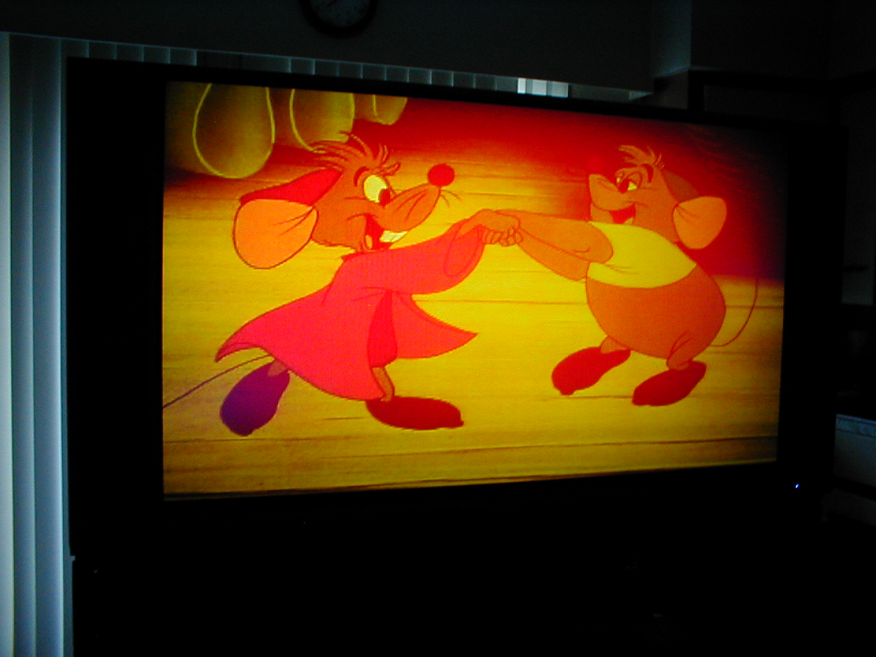

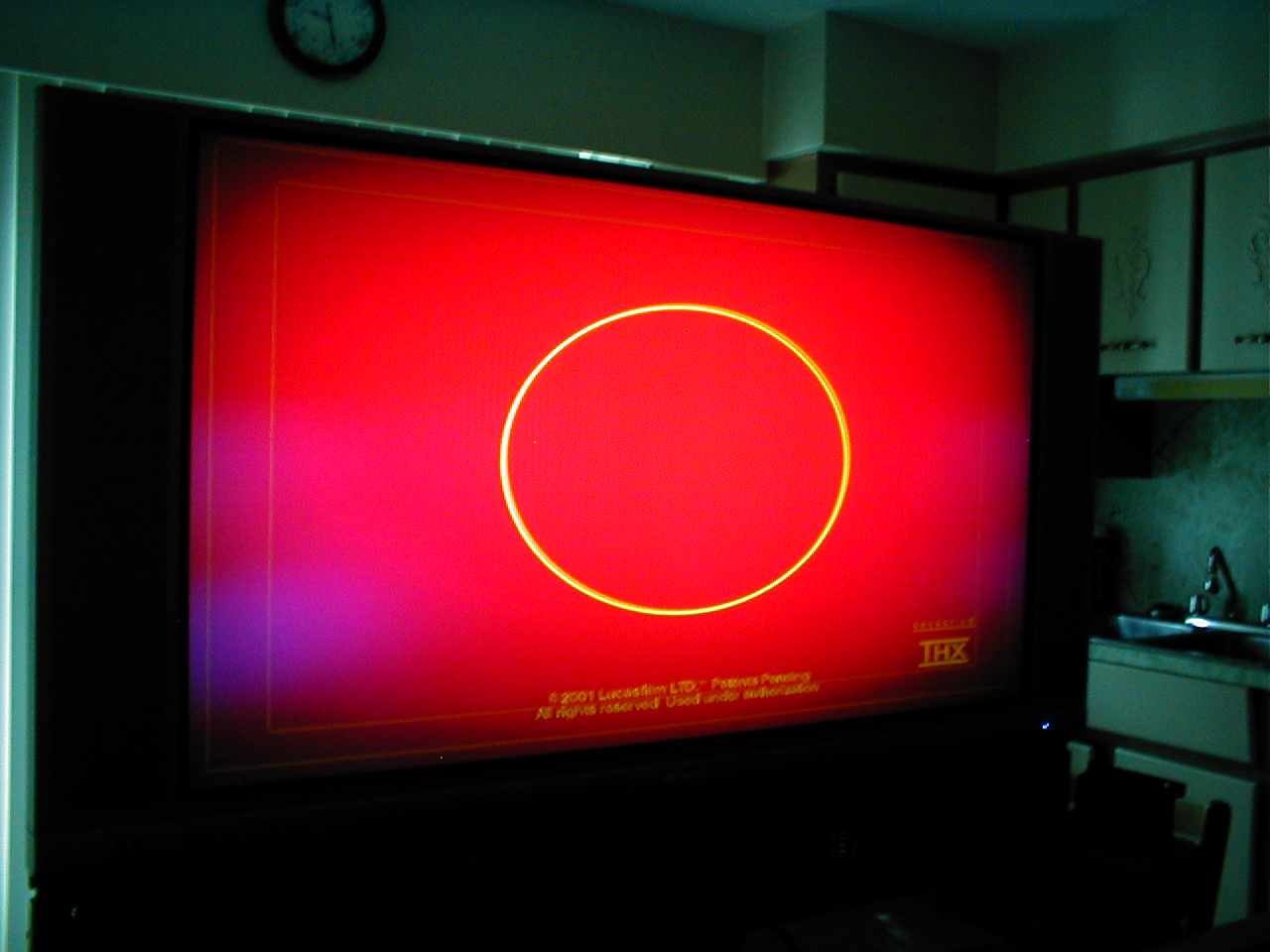

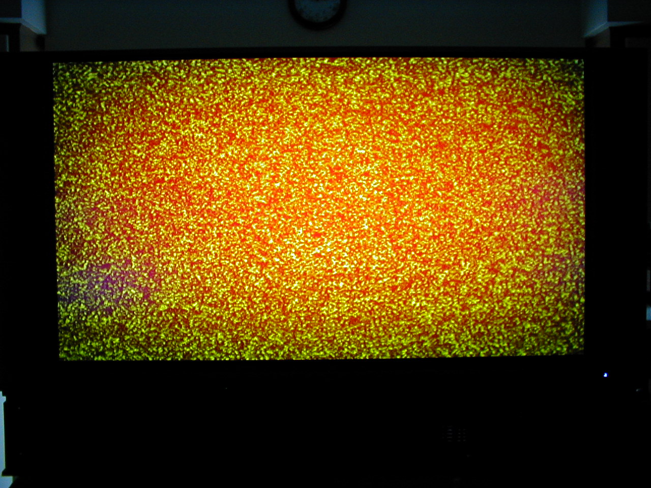

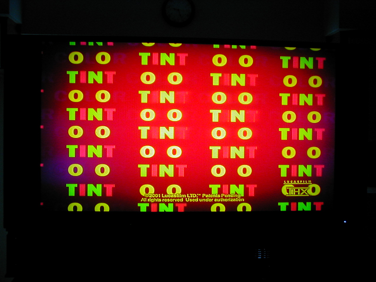

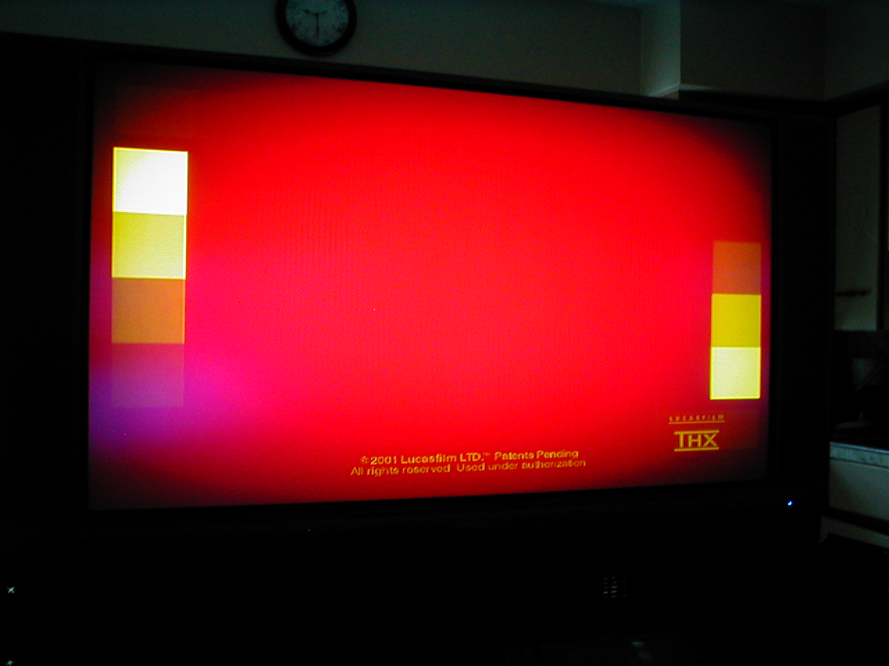

Havn't been able to do any more troubleshooting for a couple of weeks ( been recovering from "laser colon surgery" Wee! Confused ), but here are some pictures showing the almost total lack of blue in the raster - there is just a couple of fuzzy hints of it on the left side, like a partial halo in that area, and one patch on the right side. Green and red rasters seem pretty complete/consistent.
....Dave

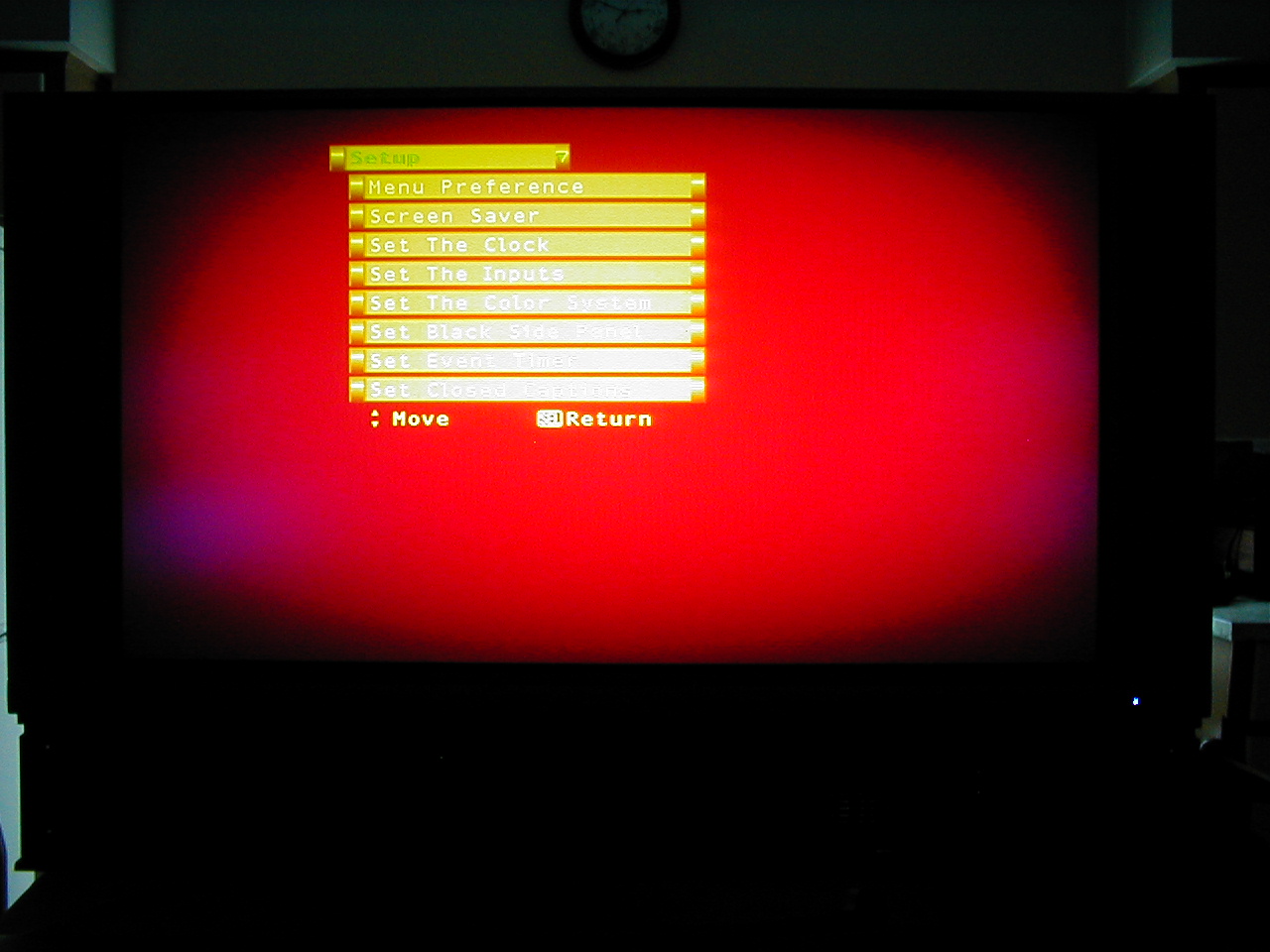

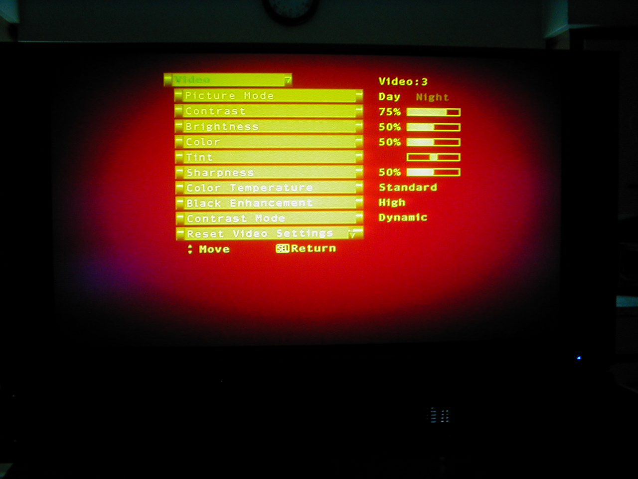

Hi Mac! ...glad you're still lurking. Here's some menu screenshots and the Ant A input snow...

Thanks, Mac! ...saved them both...so is the implication from the first pic that the blue is missing cause of the burnt filter ? Or is the blue missing because of the missing fan duct or ?
I've got a bit of mottled blue, so I don't think the latter pic applies, but who knows...
