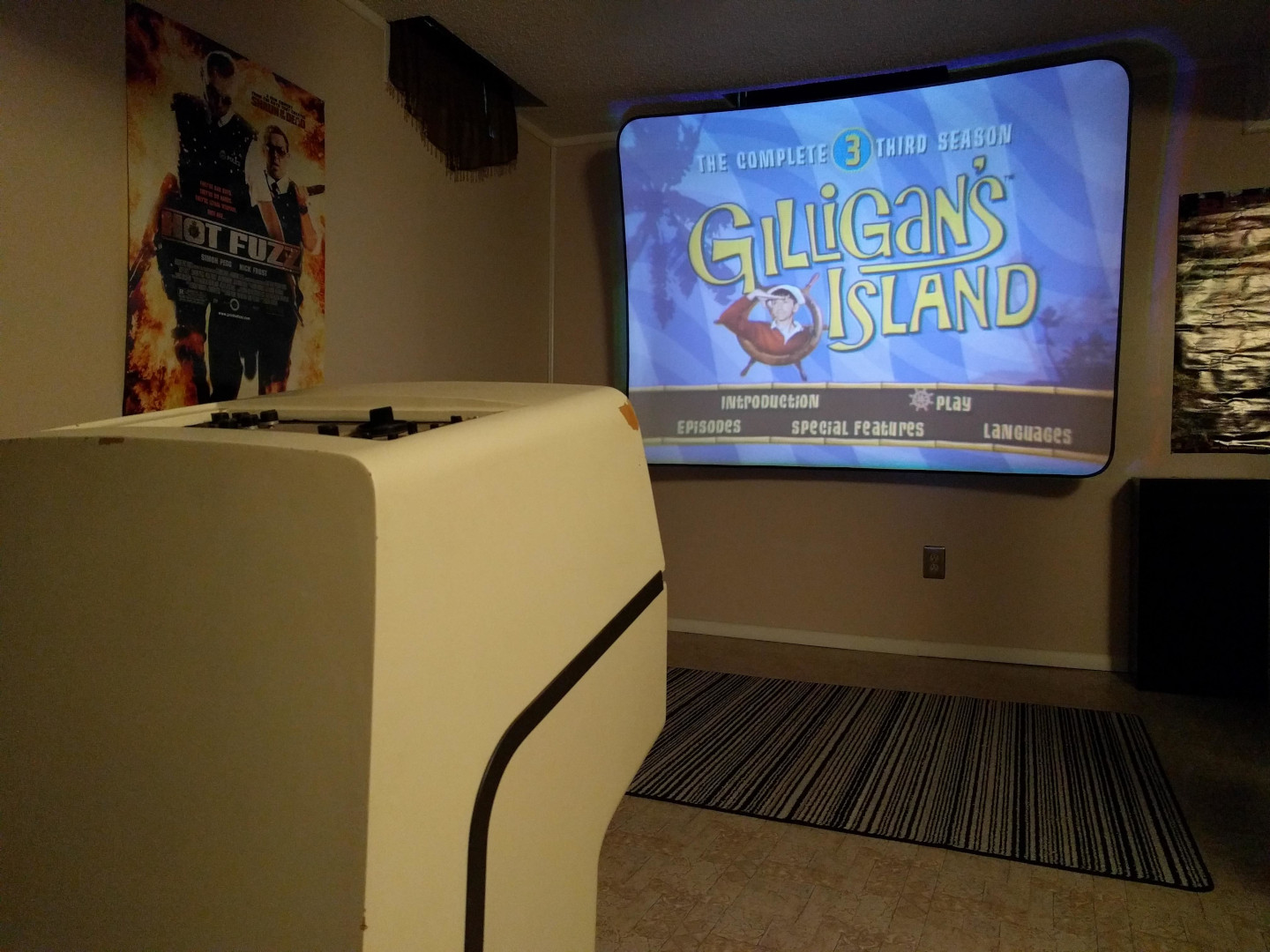

Posted: Fri Jun 22, 2018 12:44 am    Post subject:
It's alive!
 Filesize:  327.83 KB
 Viewed:  5429 Time(s)
barclay66
Joined: 27 Jun 2011
Posts: 1304
Posted: Fri Jun 22, 2018 8:34 am    Post subject:
That looks awesome! I wouldn't have believed that the picture quality would be that good. My experience with this kind of technology didn't produce such a sharp and well-defined picture.
