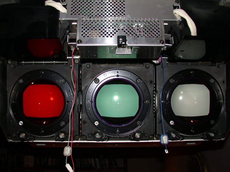

How come the green doesn't have a (lightly) filtered C-element?
YEAH!!! WTF???
Does it just look green and the photo didn't get it?
Umm.... I thought G90s always have the lighter/brighter C-element for a better brightness spec... Don't they all have to have the green C-element replaced for HT duty for correct green primaries. Question

CIR Engineering wrote:
YEAH!!! WTF???
The G90 green C element is about half as "green" as a fully filtered one.
The one in the photo appears clear.
I just thought it was odd.
Is the red "red"?

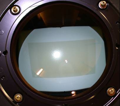

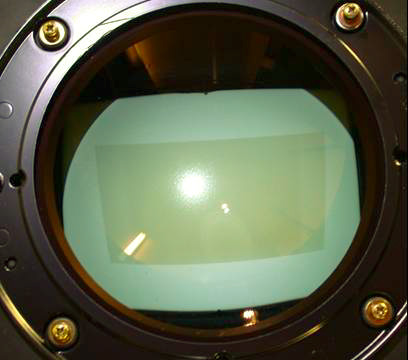

Is the red "red"?
The image I posted is not a good representation for the color. In reality, the green is more evident although it is very light. The green on my G70 is noticably darker.
The red is very red.
Posted: Thu Sep 24, 2009 1:50 am    Post subject:
Ah, THAT'S what you guys were talking about... The photo! That was the automatic color balance in the camera... The flash coming back from the green-tinted c-element got balanced back to neutral. You can tell because the white flash on the lens mounting flange (where it actually would/should have been neutral) is all magenta... It's funny... I see stuff like that, and my brain balances it back without even thinking about it.
Here... I tweaked it back toward neutral on the mounting flange, and it made the c-element go back to pale green.
Original version...
 Filesize:  19.97 KB
 Viewed:  6732 Time(s)
Tweaked version...
 Filesize:  30.2 KB
Mark_A_W
Joined: 15 Mar 2006
Posts: 3068
Posted: Thu Sep 24, 2009 2:38 am    Post subject:
Ah, that explains it.
And yes Steve, your tweaked photo looks about right to me, maybe a touch light still, but close.

Posted: Thu Sep 24, 2009 4:21 pm    Post subject:
C-element looks right to me. The OEM filter is REALLY light.

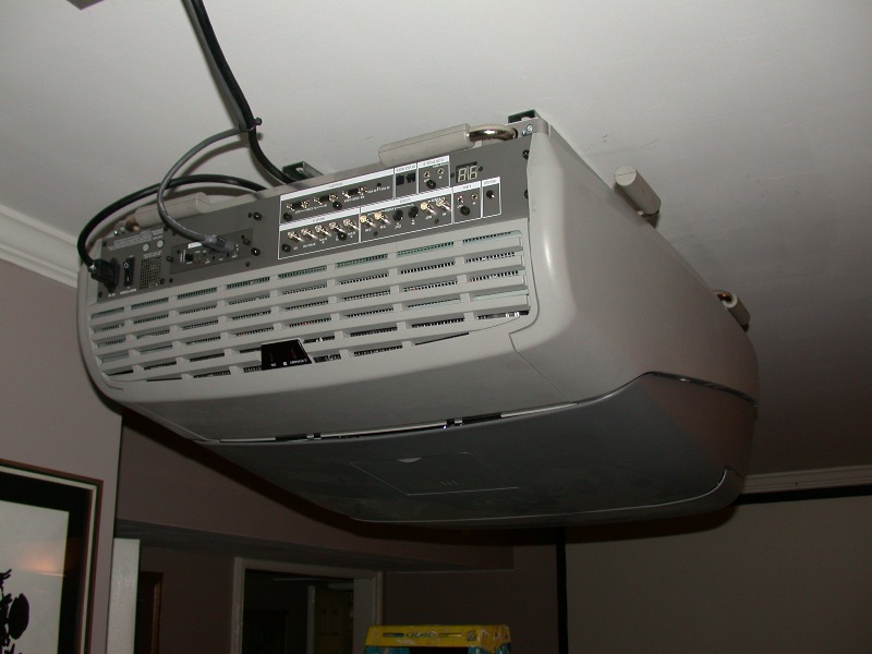

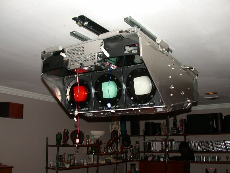

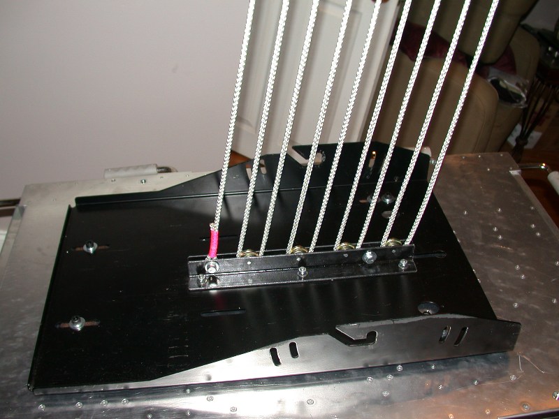

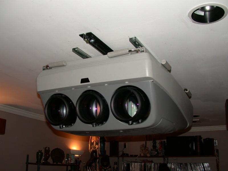

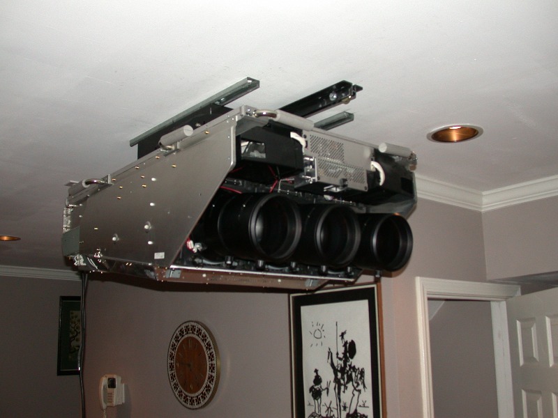

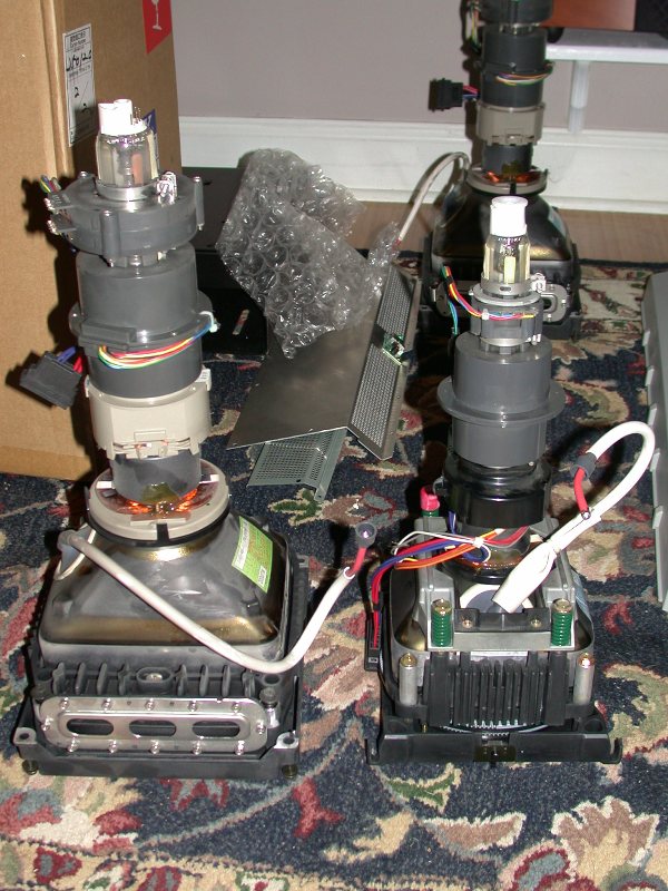

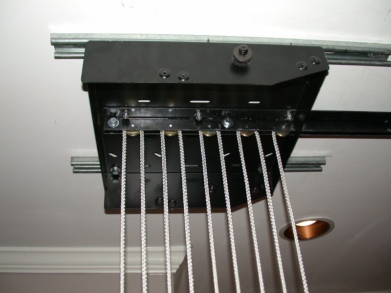

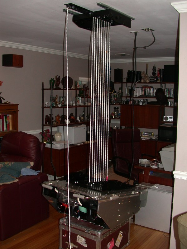

Finally got the the replacement tubes & DALLAS chip installed and hung the projector. I've attached a few images showing the installation. You may notice my mod to the mounting bracket to allow a single person to hang a crt.
Those fasteners Sony used to attached the lenses suck. Two of the screws heads stripped when I removed them. I replaced all the lens fasteners with stainless cap screws.
Now to work on the registration to see how those replacement tubes are going to work out.
BTW: The replacement green crt's coolant color is noticeably darker than the original.
Just a bit of wear on the blue tube. Hopefully it won't be too noticable in the image.
 Filesize:  115.68 KB
 Viewed:  6551 Time(s)
All dressed up.
 Filesize:  49.23 KB
Moome card installed.
 Filesize:  104.42 KB
Lens mounted.
 Filesize:  102.25 KB
Bolted to the ceiling!
 Filesize:  110.25 KB
Ready to lift into position.
 Filesize:  112.04 KB
Modded lower ceiling bracket.
 Filesize:  111.65 KB
Modded upper ceiling bracket.
 Filesize:  102.95 KB
Comparison of G70 and G90 tube. What a difference 1 inch makes in size!
 Filesize:  134.08 KB
CIR Engineering
Joined: 25 Aug 2008
Posts: 4269
Posted: Sun Oct 18, 2009 4:43 pm    Post subject:
I LOVE your lift!
craigr
JETI 1211 Spectroradiometer
Klein K10-A Colorimeter
Phone: 865-405-6892
betel
Joined: 20 Apr 2006
Posts: 448
Posted: Sun Oct 18, 2009 5:06 pm    Post subject:
Thanks for the compliment Craig!
Posted: Sun Oct 18, 2009 6:30 pm    Post subject:
I LOVE your lift!
craigr
Looks Familiar Wink
Those Lifts do make it sooo much easier, i put an Eye hook into the floor and attached the rope while i was on the ladder connecting the two halfs.
MikeEby
Joined: 24 Jun 2007
Posts: 5237
Location: Osceola, Indiana
Posted: Sun Oct 18, 2009 6:58 pm    Post subject:
That is nice...I love my lift too...I think I've only used it twice in 7 years....Probably a good thing.
Mike
