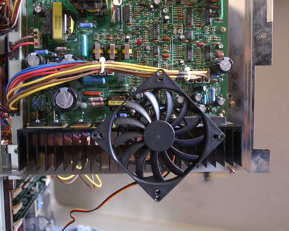

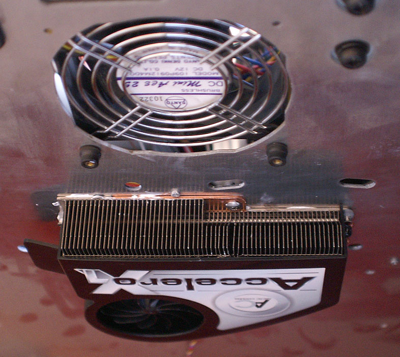

I've installed 2 additional Fans on the NEC:
Hi there
In that second photo, the output of both fans are aimed at the same airspace. That will raise the static pressure that each fan "sees", and reduce the airflow produced by each fan.
Re-aiming that Accelero fan 180 degress from its current position or toward the nearest PJ side would be better.
Regards
Revox
Joined: 13 Feb 2008
Posts: 158
Posted: Tue Oct 06, 2009 8:00 am    Post subject:
I know, the problem was the orientation of the screws. Because the STK's are just above the heatsink.
I think it's enought to run the AC Fan @ 6V so the static pressure after the heatsink is very low.
It was hard to manage a good contact between the Fan and the bottom plate.

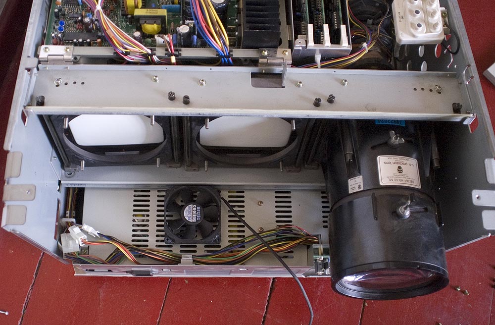

Next step is that i install another two Fans on the top Powersuply. It seems not very professional i know.
Yesterday i noticed a mask on the tubes ;-( I hope it is not visible to much.

Elaine Benes
Joined: 25 Apr 2006
Posts: 1416
Posted: Thu Oct 08, 2009 12:01 pm    Post subject:
If you pull that power supply out you'll find factory cut holes designed to hold fans for it in the back panel. I don't know why NEC chose to leave the fans out...
