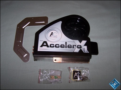

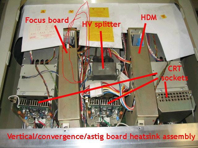

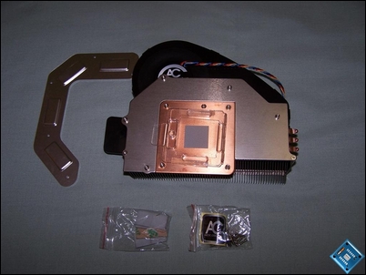

Are there information aviable of the NEC cooling Concept.
As i saw the STK screwd at the bottom without a heat sink are a problem.
What i'd like to try is put a graphic card cooler at the bottom of the PJ.
Eventally this cooling device fits between the focus module and the tube of the M as well. I need 3cm.
http://www.arctic-cooling.com/downloads/compatibility/hgt_restr_aclrox1.pdf
Cost: with shipment 7€
The Fan for the tube driver circuits is only to cool those ones?
How is the power supply cooled?
How to cheat on the "fan Guard" ?
