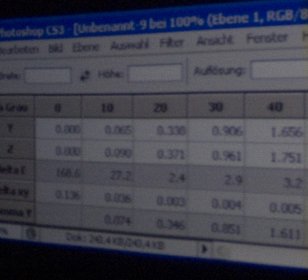

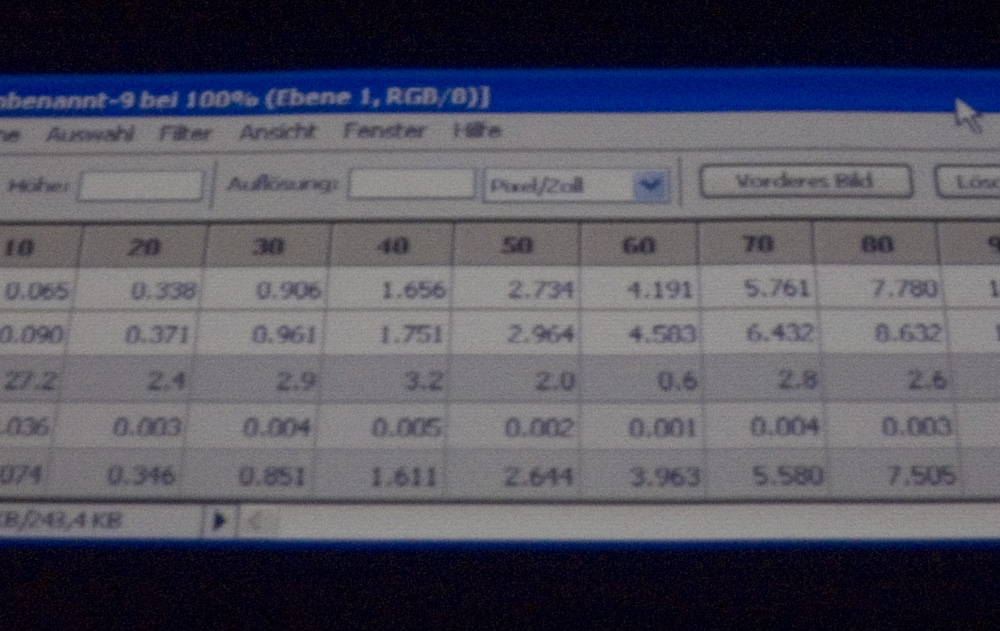

I defocused totally via picture controls , and then under service controls i let the center as it was. Then i looked at the size of the dots in the center (with a sheet of paper i made a model of those) and focused in the corners.
So last time i arranged the convergence. I think with my PT 65 lenses there is not much headroom of sharpness left. green is slightly less sharp than red.
Am i right, that the PT 65 are slightly better than HD8 rev. B.?
Screenshot at 1920x1080 @ 75Hz i
left corner
middle screen
 Filesize:  216.37 KB
 Viewed:  4439 Time(s)
Posted: Fri Sep 11, 2009 6:34 am    Post subject:
a little soft , grainy, and noisy but that's normal for a stock Marquee, especially an older one.

I think a 1998 model isn't older? The noise comes from the camera. It's interesting, pictures always look softer than the original.
Is it normal that the sharpnes on green cannot be as good as the sharpness on red?
Stock, you mean untuned with new caps and so on..
