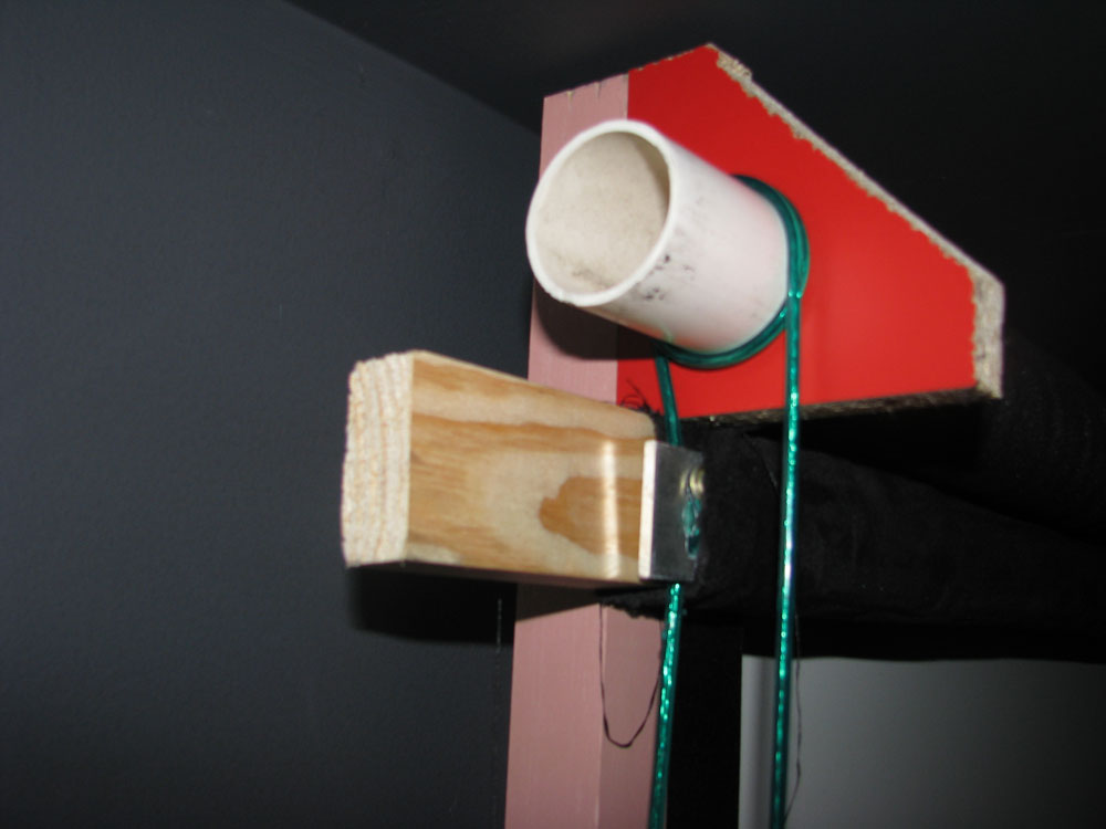

OK here's some pics of FRANKENMASK
Now that I know this works,I'll tear it down and do it properly,so it looks alot neater and not so half assed,but I'm very happy with the results.
OH but the best is yet to come Wink
The timber batton behind the aluminium plate it there for stability as the aluminium strip was too wobbly on it's own.

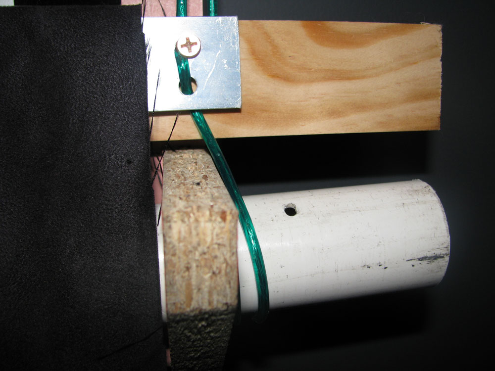

This is the bottom pipe,as you can see,one cable goes under while the other over,this way one goes up and the other down.I've also used an uluminium plate with two hole drilled to feed the cable,making it easy to adjust as its only held by friction.
 Filesize:  131.98 KB
 Viewed:  18687 Time(s)
As you can see in this pic,I've just cut a 40mm hole in a corner of some chipboard I had lying around.This allowed me to slot the pvc pipe through,allowing it to move freely.
 Filesize:  81.86 KB

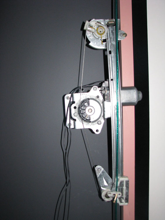

Update,well I just came back from the wrecking yard and got myself an electric window motor,screwed it to the frame and linked the cable with a screw and WALLAH.......Motorised masking.
Here's the vid.

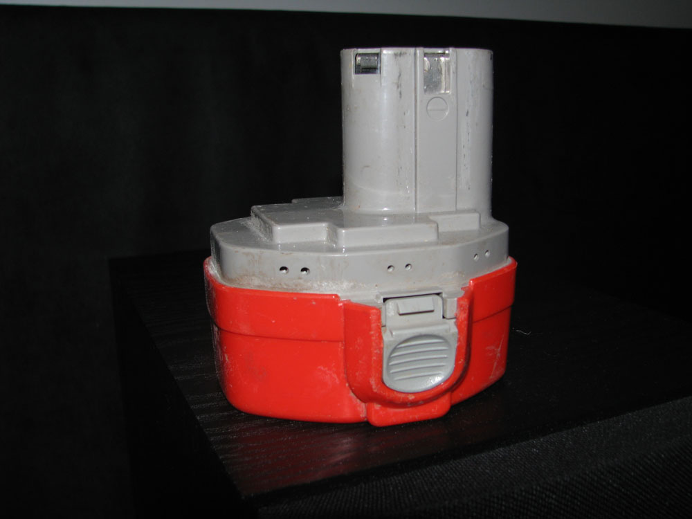

Here's the Temporary Power Supply 14v

Here's the motor

Are you using limit switches?
Can you stop in between? Not all movies are the same...
And it's very nice, better than mine.
We need a video showing how the window mech works!

I can stop anywhere I like afterall I'm just running two cables to the battery to get it to work,what I do need is some advice as just how to hook up a permanent power supply running 14v that I can also access via Ir.

Here's a vid of the actual motor in action(its actually on the side of the screen),it's a bit quicker than I'd like but it does the job just fine,but like I said I need to add a power supply with IR,somehow.
