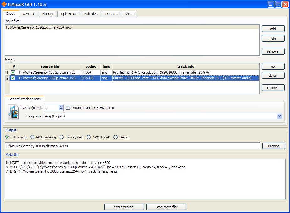

Posted: Wed Feb 24, 2010 6:59 am    Post subject:
jmike wrote:
yes, those two problems.
The core track is not there either selecting hd with core or using command line.
To get core track, use command line then only select hd and core. That produces a DTS Master.dtshd file that only contains core dts track.
So to sum up, selecting video + hd and core produces mkv and audio with only hd.
selecting hd audio and core without video produces the core audio.
The issue with chapters.txt is that mkv merge produces an error with invalid filetype and error code 2.
Also checked with mediainfo
If I may I'd like to possibly shed some light on this issue with a question as I'm still trying to get my head wrapped around these HD audio formats. First, I don't think Mike's tool has an issue with DTS-HD (MA) + Core unless you want the Core as a separate track where you could select either one in a player. However, if you're only wanting to include the Core as a separate track for equipment compatibility purposes then I don't see any issue with the tool because the Core is included Mr. Green. In my case I only run the "Add batch" and don't use the command line method.
Here's why. Below is the audio portion using MediaInfo from my Serenity MKV created by Mike's tool.
Audio
Format : DTS
Format/Info : Digital Theater Systems
Format profile : MA
Codec ID : A_DTS
Duration : 1h 59mn
Bit rate mode : Variable
Channel(s) : 6 channels
Channel positions : Front: L C R, Surround: L R, LFE
Sampling rate : 48.0 KHz
Resolution : 24 bits
Title : DTSMA
Language : English
Notice the bitrate shows "variable". I would think MediaInfo should show it as variable/1510 Kbps similar to what MediaInfo shows for TrueHD + its Core of AC-3. Might be a MediaInfo bug or...who knows.
Anyways, here's the partial Eac3to GUI log:
eac3to v3.17
command line: "C:\Tools\RipBot\Tools\eac3to\eac3to.exe" "D:\BDMV\STREAM" 1) 1: "C:\tmp\Serenity - Chapters.txt" 2: "C:\tmp\Serenity 1080p VC-1.mkv" 5: "C:\tmp\Serenity - 5 DTS Master.dtshd" 17: "C:\tmp\Serenity - 17 English Subtitle.sup" 34: "C:\tmp\Serenity - 34 English Subtitle.sup" 39: "C:\tmp\Serenity - 39 English Subtitle.sup" 45: "C:\tmp\Serenity - 45 English Subtitle.sup" -log="C:\tmp\Serenity - Log.txt"
M2TS, 3 video tracks, 12 audio tracks, 32 subtitle tracks, 1:59:02, 24p /1.001
1: Chapters, 20 chapters
2: VC-1, 1080p24 /1.001 (16:9)
3: VC-1, 480p24 /1.001 (3:2)
4: VC-1, 480p24 /1.001 (3:2)
5: DTS Master Audio, English, 5.1 channels, 24 bits, 48khz
(core: DTS, 5.1 channels, 24 bits, 1509kbps, 48khz)
6: DTS, Spanish, 5.1 channels, 24 bits, 768kbps, 48khz
Next is the MKV file imported into TSmuxer (image attached). It has both DTS-MA + Core which allows the Core to automatically play on my analog setup. I'm not sure how Mike's tool is muxing both Audio tracks into one but, I think this is by design for DTS-HD (MA) unless you ONLY want the Core.?? So, for me this is a feature and not an issue. Please correct me if I'm completely confused or have confused the whole issue here.
 Filesize:  95.12 KB
 Viewed:  19716 Time(s)
