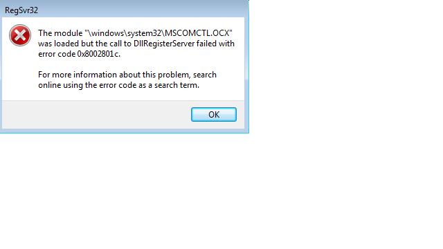

Posted: Tue Feb 02, 2010 10:47 pm    Post subject: Re: great program Mike
datman wrote:
I just got turned on to it. Thank you for the GUI a few problems aside it's working great.
For a long time I have just settled for pdvd7&8, I refused to buy 9. I’m one of those few people that won’t be upgrading in order to bit stream. For a couple of years EAC3TO has been around I could not get the commands down.
Across the Universe was the 1st successful MKV/Flac conversion. A very noticeable difference. I can only guess that this is equal to bit streaming.
The problem I’m having is after anotherea3togui muxes the streams apart and converts to mkv/flac. An error in anotherea3togui stops mkvmerge from completing the operation. I didn’t write down it had something title of the final folder being wrong, I will copy the error on the next pass. When I run mkvmerge manually subtitles are not an option so on the first few I skipped them.
I’m looking for a better player tried zoomplay it was very choppy unwatchable. I’m using nero showtime it seems to work. The audio is on par with zoomplay both were much more detailed than pdvd, musically speaking.
I have done several and everyone has this error. I end up manually muxing the files together. One of the films I most want to do will not process the video it's 29fps. Is that the cause and is the a work around?
edit; both vista32 machines have the same error

Posted: Wed Feb 03, 2010 2:16 am    Post subject: Re: great program Mike
datman wrote:
Is the account your running the app with an Administrator? If not try running as an Administration. It may only take one time to run as Admin to work then the DLL will be registered properly from there on.
You may want to look at this thread.
http://social.msdn.microsoft.com/Forums/en-US/vbgeneral/thread/3c582b05-1e68-4ca9-a84f-9425289c01cf
Mike

Posted: Thu Feb 04, 2010 1:23 am    Post subject: Re: great program Mike
MikeEby wrote:
datman wrote:
Mike
Thanks Mike, I followed the link and there is a free program to monitor your registry. I monitored it right up to the error and looked for the correct code to tell you the truth this is way over my head. If there is not a simple way I can live with it, maybe an update will fix it.
edit; I tried to run as an adminitrator One computer I was able to check the always run as adminisrator under properties and the other I could not, both still had the error

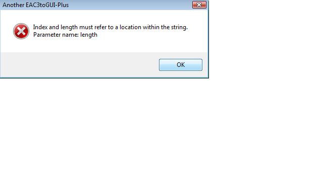

Posted: Thu Feb 04, 2010 3:39 pm    Post subject:
My bad that was the wrong error picture Embarassed I was able to register the file on each computer, so I got that going for me.
this is the correct error

Posted: Thu Feb 04, 2010 3:56 pm    Post subject:
Ahh..Ok...what version of Haali are you using? Make sure it's not the 12/19/09 release. I've edited the original post with more info about Haali, and a link to a version that works.
http://www.curtpalme.com/forum/viewtopic.php?p=198542#198542
Mike

Mike,
Just want to point out - I just noticed this - the error I'm getting with the AAC test version is the same as described above by the other posters. So it's probably not even related to your AAC option implementation but to whatever fault is causing their crash as well.
The debugger result (under tools show last eac3to run) only shows the successful completion of eac3to's job, the error appears to come when your program goes to do somthing with the forced subs it finds.
When I left home earlier today (i'm still at work) I popped in another blu ray to see if that one will work (this time District 9)
