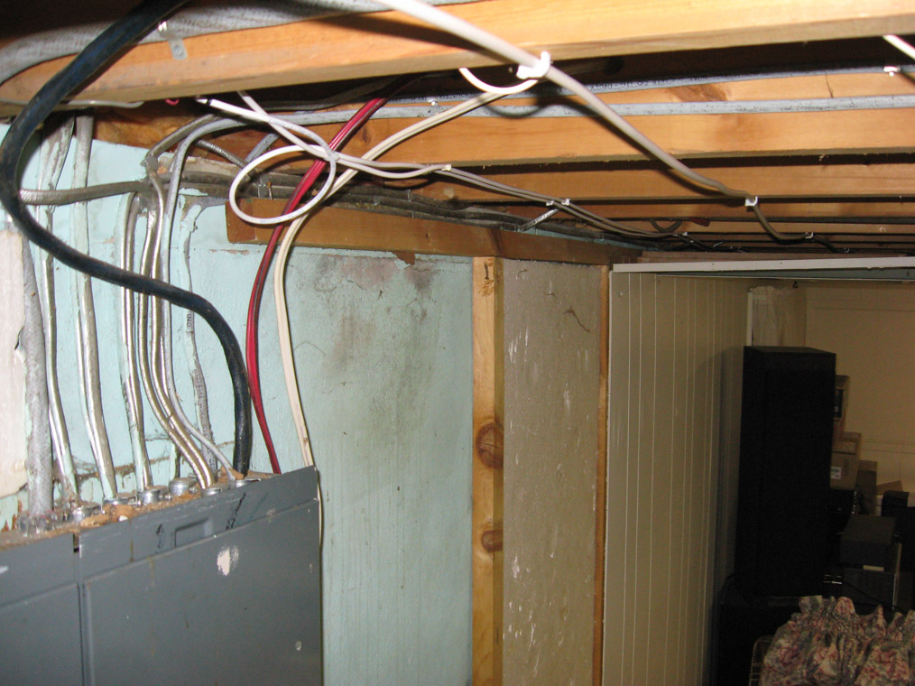

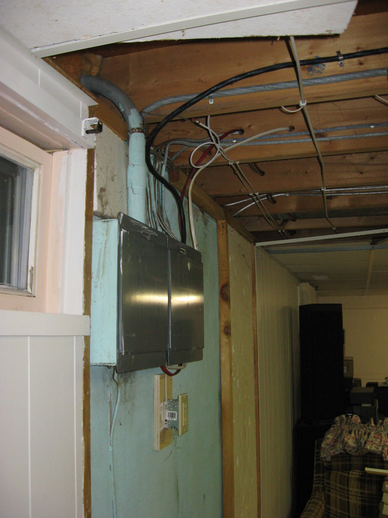

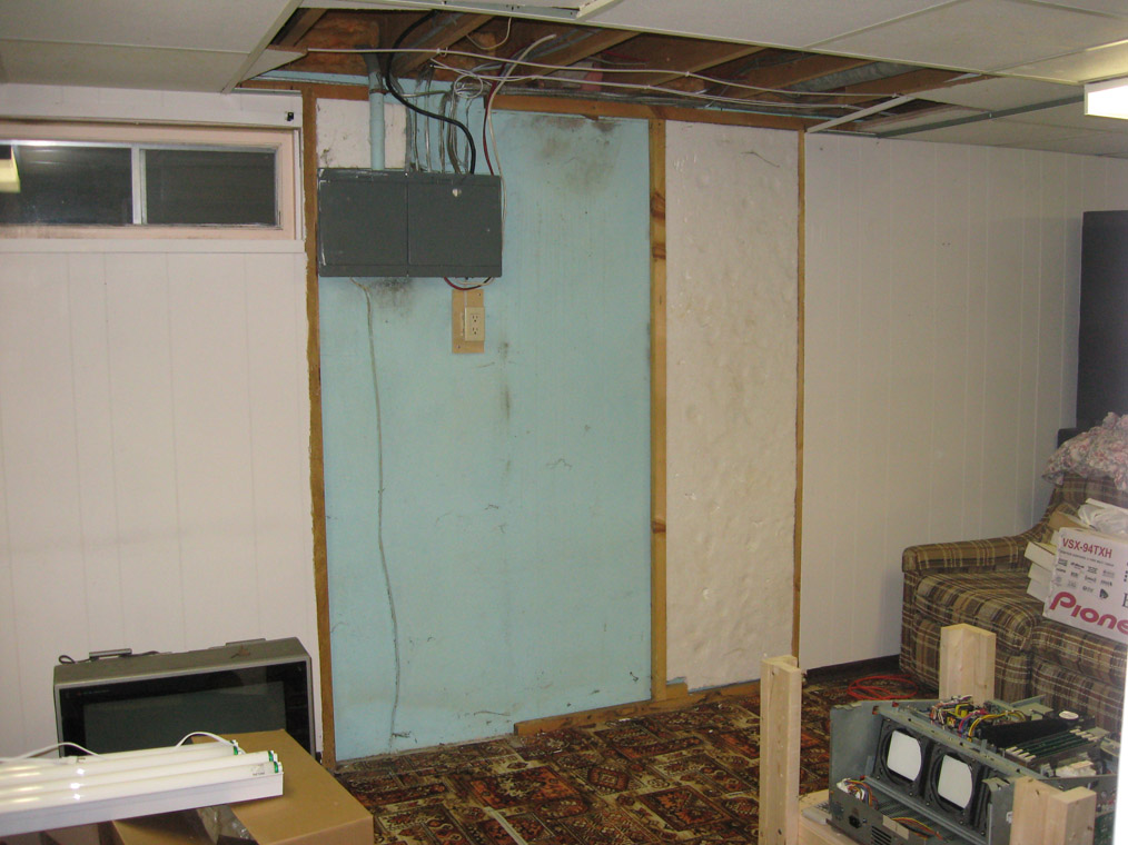

I've attached a few photos of the area around the panel showing the opened wall, existing insulation, and 2x2 framing.
Cheers,
Dan
View of top 'plate' - note it is not attached to joist, but to wood member on top of foundation. I assume that Option C (above) would require securing a plate to the bottom of the joists to secure the wall framing.

Different view, 2x2s are against the foundation (for the most part). Wall is somewhat uneven so there are gaps.
 Filesize:  203.46 KB

Basement wall - white styrofoam insulation (original), 2x2 framing. Some HT components around waiting for me to get my a$$ in gear and have the room set up
 Filesize:  203.85 KB

Posted: Tue Jun 30, 2009 1:07 pm    Post subject:
Id go with 2x4's, one reason it will give better sound by being able to add the fiberglass sound grade insulation.
