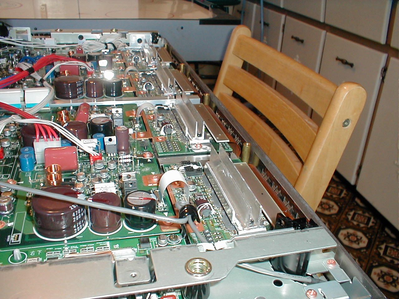

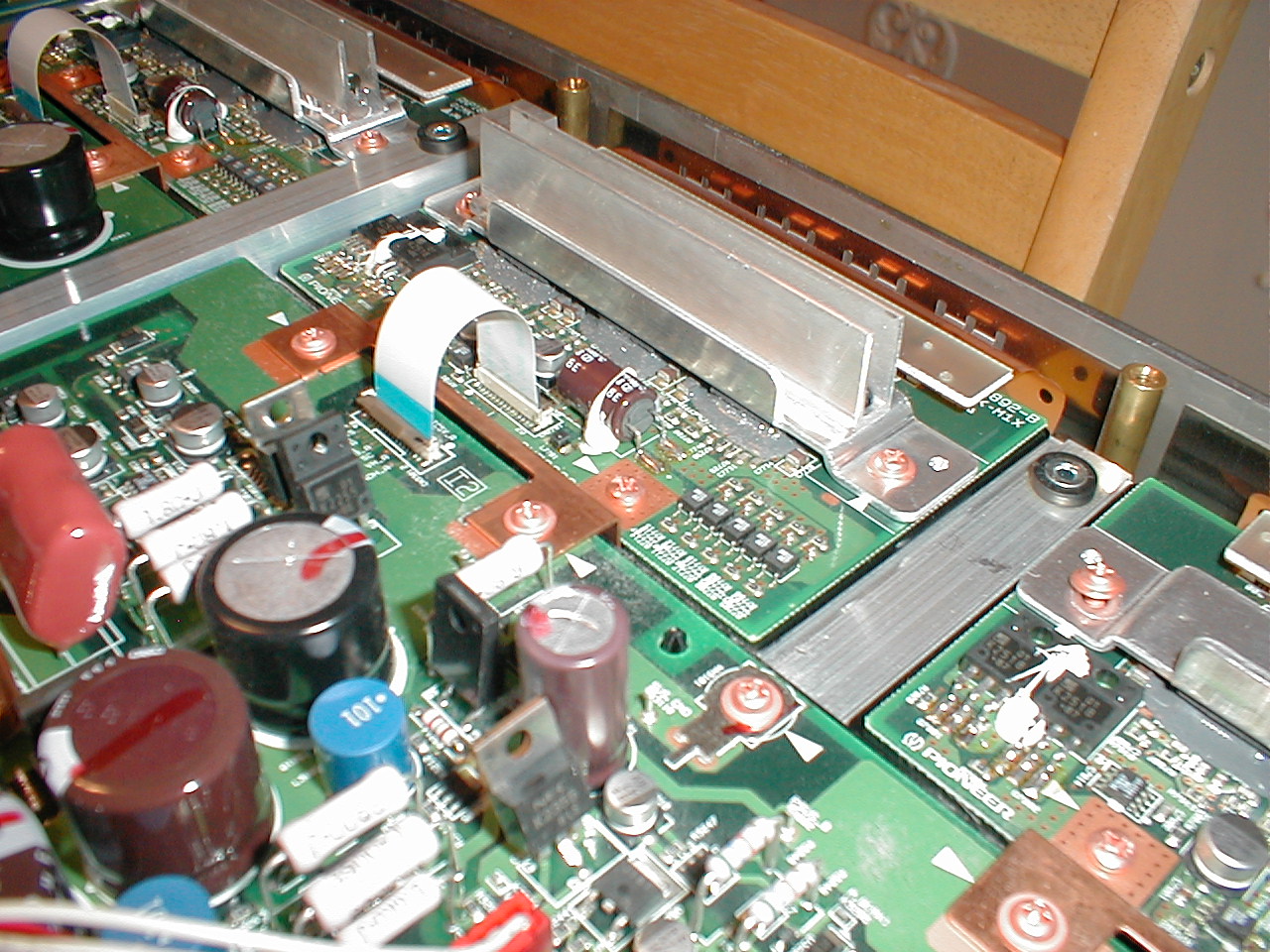

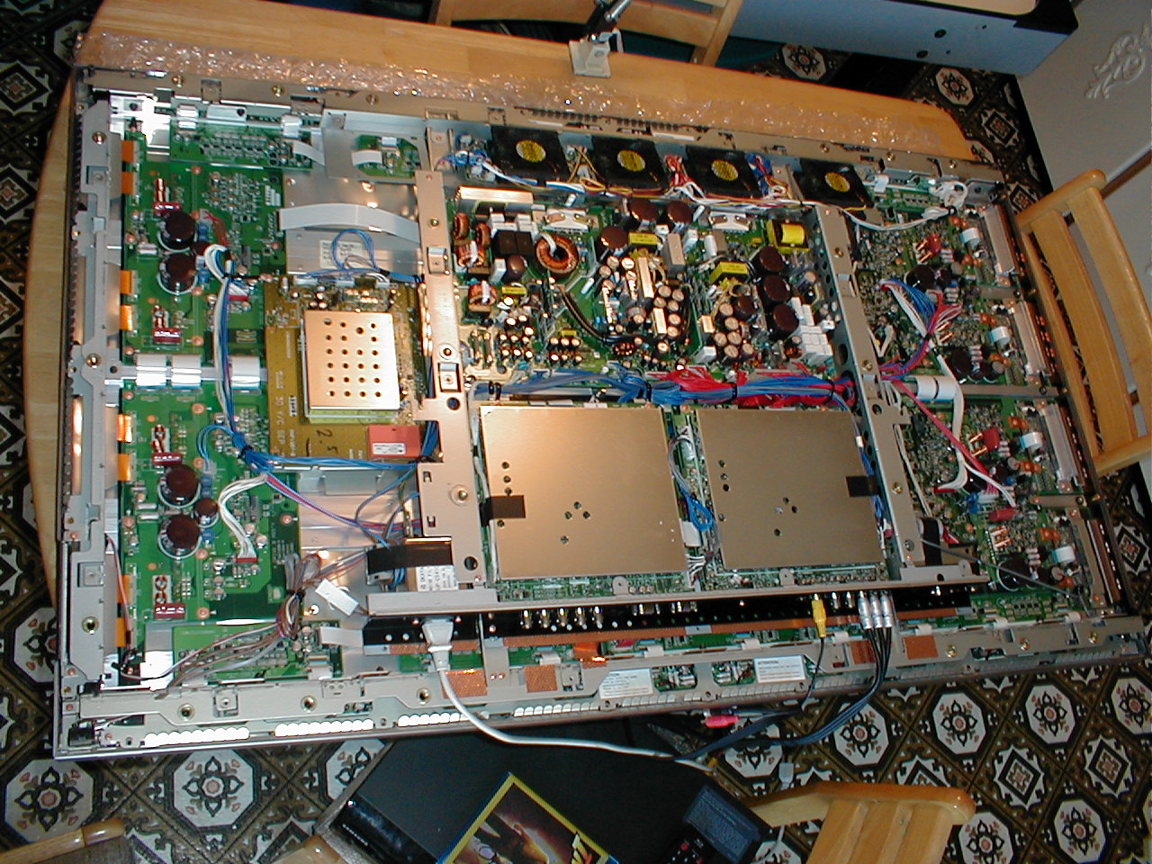

Posted: Wed Nov 11, 2009 6:46 pm    Post subject:
Hey guys & girls, so much going on over the past two months, I never had a chance to update this thread: the good news is my free "vintage" Plasma is still humming along nicely. Once in awhile there is a slight greenish edge tint on the "trailing edge" of fast moving objects, which disappears once movement stops, but after awhile my brain tunes it out. Perhaps this is a "plasma characteristic" ? What I did want to mention was my cooling upgrade to the SCAN boards: I noticed these boards (4) got pretty darn warm after a 1/2 hr or more of operatiion, and only have a thin flat piece of aluminum overtop the three IC's per board. What I did was take some large power supply heatsink fin assemblies and custom cut them to bolt onto the existing heat sink. Here are some photos.... I highly recommend this, I think it will extend the life of these crucial components in the set.
