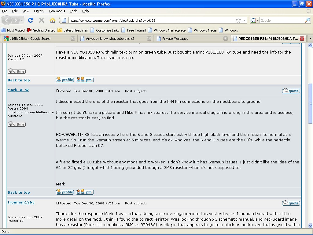

Isnt this you?

Mark_A_W
Joined: 15 Mar 2006
Posts: 3068
Posted: Sun May 10, 2009 9:16 pm    Post subject:
Ok, if you read it, you'll see I am unsure.
If you do it without removing the resistor, you are grounding G1, through a 3M3 resistor. Not sure if that is a good idea or not.

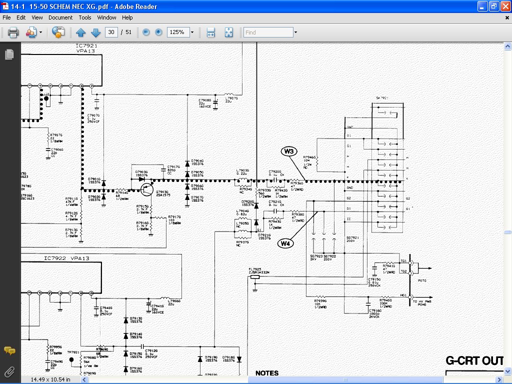

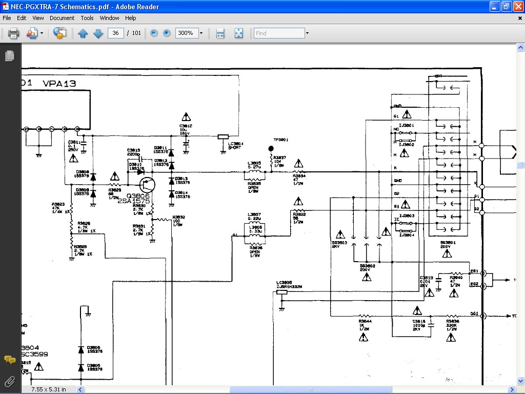

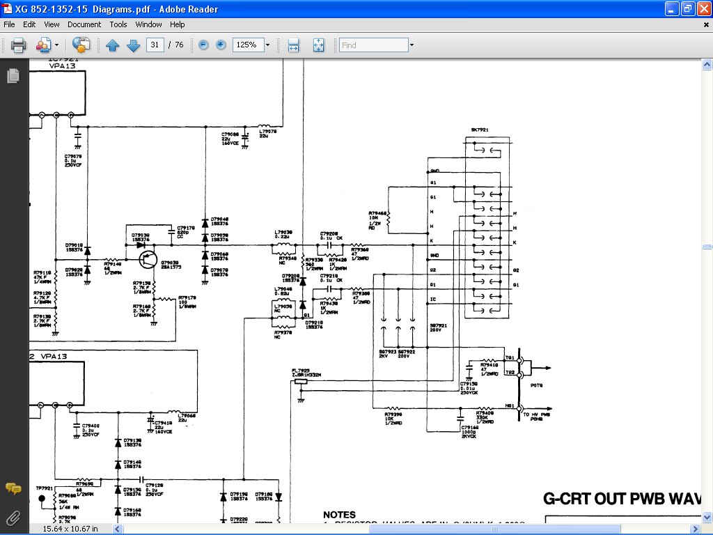

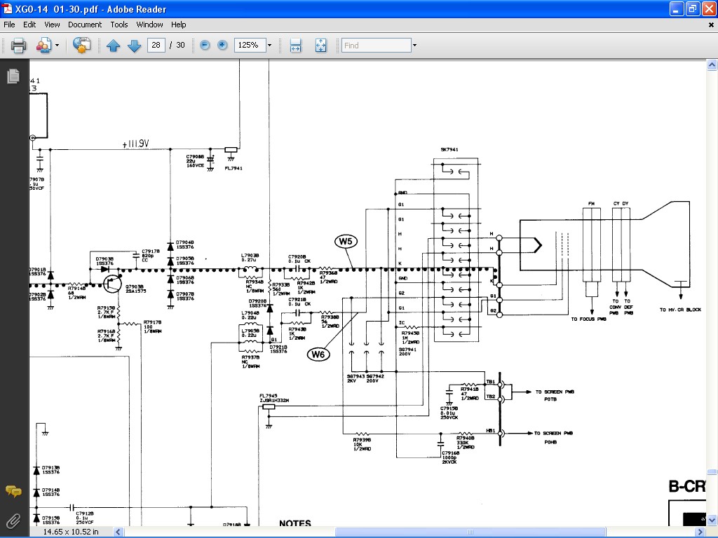

So I guess your final answer is your not sure. Lets see if we can find an answer with some facts. These facts are from NEC service manuals.
First lets see what tubes are used in what machines. All facts pertain to the green only for this issue.
6/9 PG EXTRA....P16LJE08HKA
XG750,1100,1350......P16LJE07HKA
XG751......P16LJE07HKA
XG1101,1351(LC's)......P16LJE06HKA
XG852.......P16LJE07HKA
XG1352(LC)....P16LJE06HKA
As you can see the PG Xtra uses an 08, XG non LC's use 07 and XG LC's use an 06.
So now lets look at the neck boards to see whats up. Pics will be attached below showing what projector the schematic is for. First, if we look at the PG Xtra schematic we see the (2) G1's are tied together, have a spark gap and then you can see the incoming G1 line.
Next we look at the 750,1100,1350 schematic. Huh, same design for the G1. Both tied together, spark gap and incoming line. But wait, thats an 07 tube. Same as the 08 tube. Guess that should be a swap no problem. Hmmm, but the 07 was also used in the 751 which the neck board has a different design with 2 amps and (1) G1 line through a resistor going to ground. So I guess the 07 tube will work with either type of G1 system design. So the 08 also works in the 1 amp neck board so it should also work in the 2 amp board.
Now the 751, 1101 and 1351 all use the same neckboard but the 1101 and 1351 use the 06 tube. So these tubes will swap no problem. Then we have the 852 and 1352 which is the same neckboard as the 751,1101,1351.
So when we put all this together, all these tubes should swap without any issues. I'll leave it at that unless any comments require further discussion.
