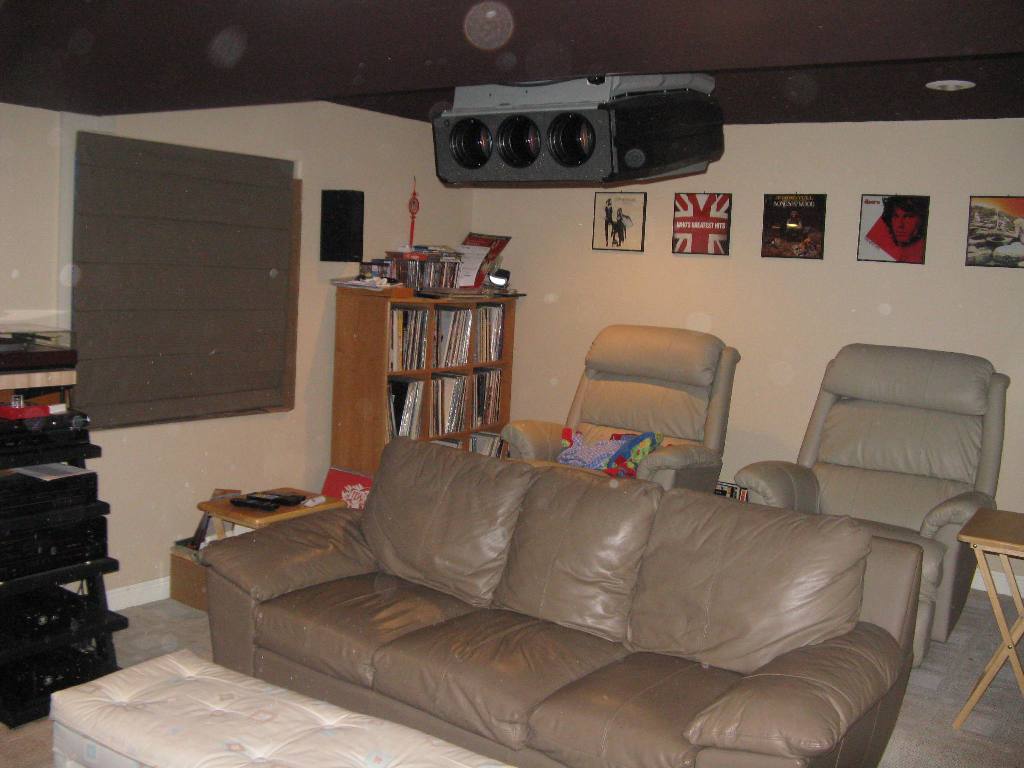

Hi Dragan, I received them on Friday and installed them back right away. I had to do the convergence, so I have reset the convergence. Did the source setup again, and did focus, stigmator, etc.
The picture looks very good. Contrast is much better and 1080P black looks close to when I set it up at 960 x 1440. No more black tinted with slight gray tone. I don't know why but I think color saturation has also improved. Now I see excellent color depth and tone.
I also think the resolution has increased a lot when watching movies, though I can't verify it on my computer screen (I am using an HTPC). Part of the reason I am not getting maximum resolution could be that I am using 110" wide screen with HD10L lens. Corner focus is slightly off though I don't notice it when I watch bluray movies.
Slight green spilling to the bottom of the screen is not fixed. I think the problem may be in the tube. Thanks for your excellent work! I think it's worth every penny and I recommend it to any marquee owner.
this machine might have an issue with fungus in the green tube, not sure yet but all the results are pretty mcuh what I would expect video performance wise.

oh one more important thing to mention and that's return shipping. All boxed up with rear heat sink, HDM, FCM and 3 x VNB it's 21 pounds. it's pretty cheap for the lower 48 but Alaska , Hawaii , Canada is 60 bucks, EU is $100. , and Australia /New Zealand is $140. I know it's a bummer but I looked all over and those were the best rates I could find with US postal service.
Make this experience all that it can be with HD mod's
