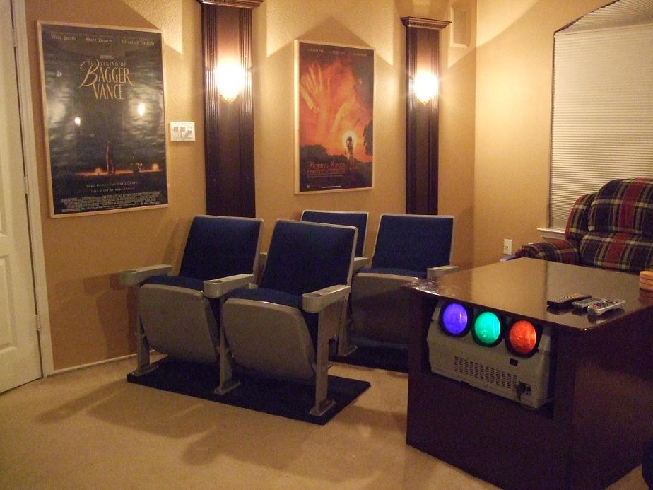

Lori my screen is 92" wide (120" diag?) and tip of lenses are approximately 9 feet back from screen.
drice1234 wrote:
I will go by what everyone says about a ceiling mounted PJ throwing a better picture than a floor mount because I have nothing to compare it to but I will not agree that having a 140 lb box car that is not somehow recessed or hidden hanging from the ceiling is more attractive than a floor mounted unit in a half-way decent enclosure.
Dan
you have a really nice room and a very nice hush box, looks nicer than a ceiling mount. However it wasn't the looks of my floor mount that bugged me. I had mine on the ground for a year and what eventually got under my skin was having this big Lawn-mower sized Marquee PJ hogging up the best seats in the house.
