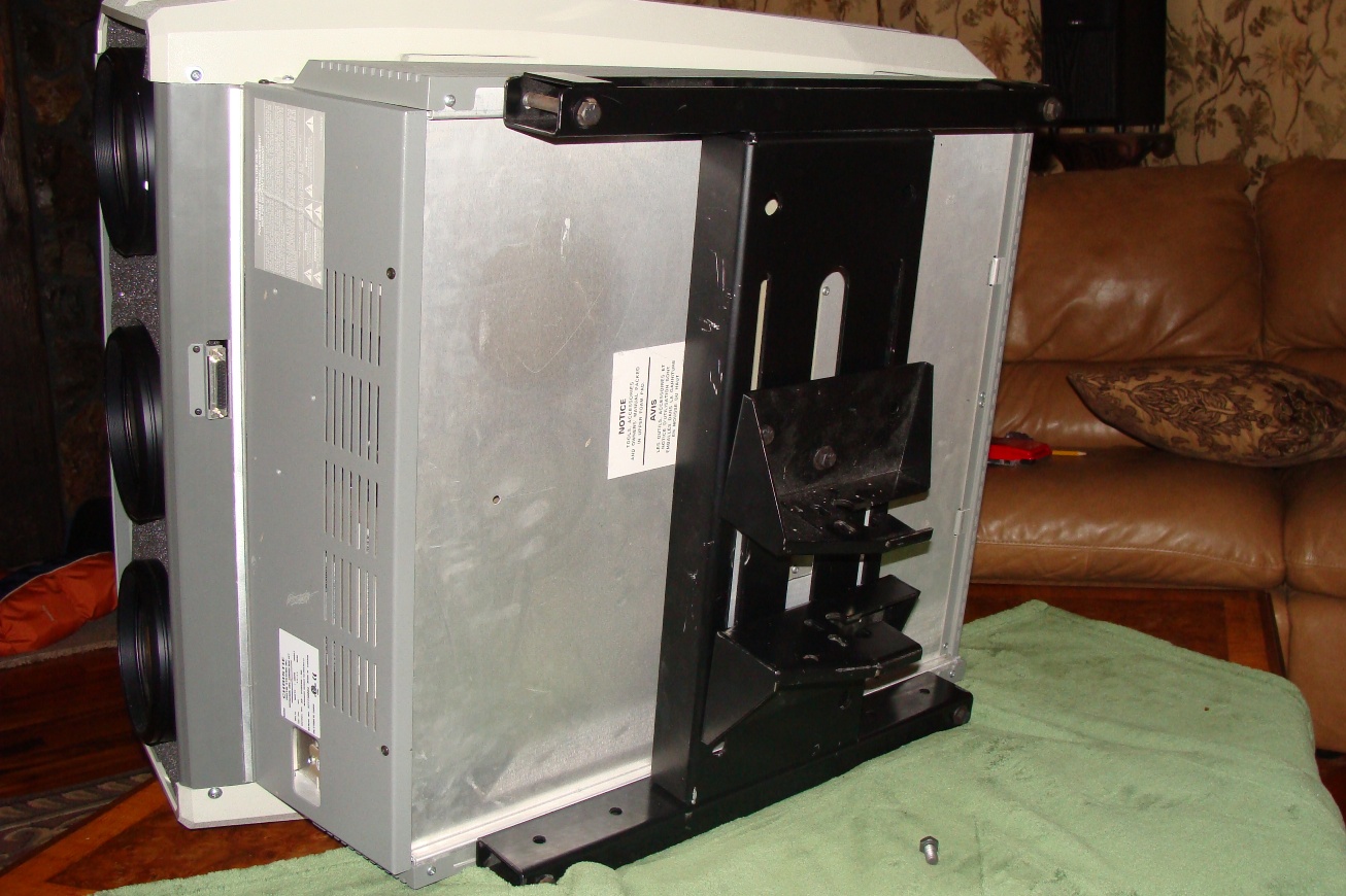

Posted: Thu Apr 16, 2009 10:56 pm    Post subject: better more complete picture
here is a better more complete picture

Posted: Fri Apr 17, 2009 12:15 am    Post subject:
That looks to me like the projector side of a mount, like one I have in my garage. I was told by the guy who gave it to me it was a "Monger" mount. They are an aftermarket maker of mounts...or were, I don't know if they still exist...
bccole23
Joined: 14 Apr 2009
Posts: 27
Posted: Fri Apr 17, 2009 12:26 am    Post subject:
thank you does any one have the ceiling side
