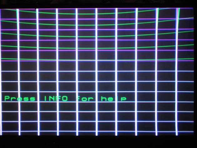

I have a similar issue with my misubishi 1080 mod wt46805. It was working good then I noticed that it would have the issue below looks like the convergence problem. Powered the TV off and back on in a bit and it would go away. But not any more it's consistent?
If the picture is not attached under menu and advanced convergence under the grid alignment, the lower half is great, but the upper green gun seems to not align and dips like a smile on all lines the red and blue are close. Unsure what is the issue. Can anyone help? I tried to upload a .jpg not sure that it will post. file size is 83.8kb.
Thanks in advance
Mark

I dont know, that image looks more like you lost a convergence chip more then it needs adjustment. Of course it doesn't hurt to try.
That 960i is for the internal line doubler setting, its not an input resolution. The internal doubler can be set for 480p or 960i.
The DVD video input is only capable of handling 480i or 480p. Nothing else. The HDTV Video input can take 480i, 480p and 1080i.

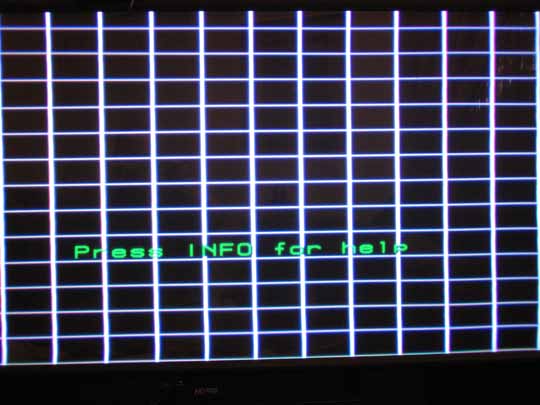

Mac,
After closer following of what you said to do, I entered into menu 1270, DTV PORT did not have a 1080 selection but rather HD,480P, AUTO, SD 4:3, SD 16:9. I selected HD which was a clean view, no green gun distortion.
Went to the advanced convergence menu and using the Audio key went into the block alignment which also was clean and white? All other inputs had the same distortion at he top half of the screen although.
Next I lost the ability to change Format now that DTV is set to HD... I would be happy to stop hear if I could affect this under DVD component. But that Input is still distorted.
Do you have an idea what is?
Thanks again for your help!
Mark

Posted: Sat May 22, 2010 1:47 pm    Post subject:
Hmmm, interesting. Based off that last pic I'd say convergence chips seem ok. And 1080I convergence looks ok. You are going to have to select 480p and do a convergence adjustment and see if you can correct that.
There is a selection for green convergence.

Mac, it's very odd I performed the convergence alignment on the DVD Input. the RED on the right side - about 3/4 up from the bottom is a little curved up and is not adjustable bout over all it's much better. My family is happy!
Thank you for your expertise.
