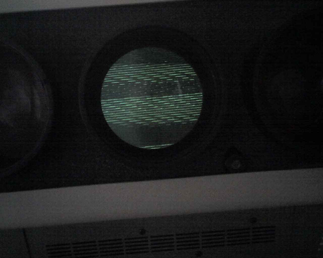

Well, tried to sync it again and the picture shows what appears on the green tube. I have turned other tubes off. Any help would be really appreciated.

Posted: Sun Apr 05, 2009 8:58 pm    Post subject:
You sure the cable is good?

Posted: Sun Apr 05, 2009 9:01 pm    Post subject:
I used to use this same cable with my Barco 808 before (three months ago) and it used to work fine then. I am tearing up what little hair I have left in frustration at this machine. sorry for the rants..

Posted: Mon Apr 06, 2009 2:28 pm    Post subject:
What input card do you have on that projector?
The input card is in slot 0 and has two columns of 5 BNCs for RGBHV (input 1 and 2 on slot 0). I tried both and same thing. When I hook up the computer and I ask it to "identify" the monitor, the tube shows a difference. So, I know that some sort of signal is coming to the pj from the computer. I seem to be having a locking problem on the signal. Someone on the AVS forum said that the PJ could be in the manual locking mode instead of automatic. So, I tried resetting by pressing the reset button on remote and then the large red button on one of the cards in the card cage. When I did this, the pj shut down, which I am told is what is supposed to happen when you do a total reset to get it back to default values. Now, it should be in automatic lock mode, right? So, it should be able to lock on the signal, but still no luck.
Posted: Mon Apr 06, 2009 2:31 pm    Post subject:
Do make sure that both H and V syncs are in auto mode. You should be able to see the menu flash up in sync. Also make sure the RGB card isn't a passthrough, in which case the second set of RGB 'inputs' are actually outputs to go to another card.. and need 75 ohm termination resistors on them. If the card says 'input 1 and 2', then the termination resistors are already there.

Hi Curt,
Thanks for your reply. I am getting very frustrated with this machine. In any case, no menu flashes up to indicate sync function. Nothing (no words or anything legible) appears on the tubes when I turn it on. I have no clue how to make the H and V sync go to auto mode. There is nothing displaying - no words or anything. I press * and it does not even tell me the software version like the manual says it should.
My input card says input 1 and 2. So, I know I have a good input card. As I said earlier, when I hook it up to my computer and ask the computer to identify the displays/monitor, I can see a discernible change in the image rolling across the tube, even though it looks like horizontal lines rolling up the tubes.
Any clues what is happening here? Thanks

Posted: Mon Apr 06, 2009 2:53 pm    Post subject:
Forgot to say, but no MENU flashes up. Or if it does, I can't see it.
What button do I press to get the menu? I tried pressing * to see software version, but nothing shows up.
Posted: Mon Apr 06, 2009 3:02 pm    Post subject:
Do a hard reset. Push the 'reset' or 'recall' button on the keypad, then press the 'reset' button on the CPU board. If the reset 'took', then the contrast will be reset to about 3, and all other controls will be set to 5. If the CPU glitched, that could do it.

Posted: Mon Apr 06, 2009 3:07 pm    Post subject:
Curt, I believe I already did a hard reset but no luck. The reset button on the CPU board is that large red button, near the green LED, right? Still, no menus show up. What could explain this?
