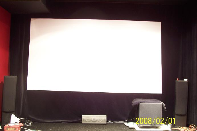

Posted: Tue Apr 14, 2009 2:04 am    Post subject: screen
I have veleveteen on left and right walls, same material completely surrounding the screen (fixed with 1.5" valcro) and to finish I painted the pink rigid foam (from Home Depot) flat black and merely screwed this to the ceiling ahead of the screen.
All easily removed if so required, such as a house sale. ometimes even I wonder whether the pj is still working when pic ftb in movies.
 Filesize:  30.05 KB
 Viewed:  5040 Time(s)

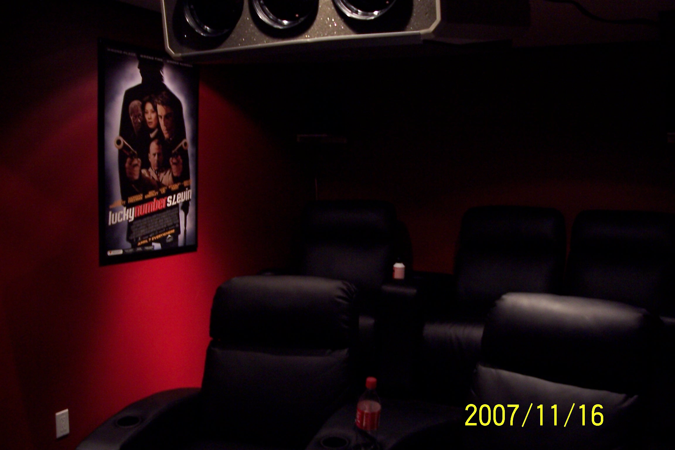

Posted: Tue Apr 14, 2009 2:13 am    Post subject: walls
Maybe the walls should be darker
 Filename:  HD DVD 2 013.jpg
 Filesize:  291.25 KB
 Downloaded:  383 Time(s)
