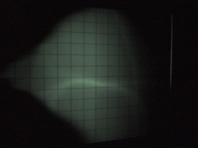

Here is a pic of what its doing, I enhanced it in iPhoto to so you can see what its doing. It is definitely a short of the video to ground , if i touch the red video cables pin to the outer part(ground) of the connector i get the same image.
Now i need to some how find the short , but I think its in the PCB Sad I tried shining a bright light through that section but can't really see anything. Scott what should I do!!!! can I swap over the mods to another 02p board if it shot? this Sucks!!!
edit: this pic is when I am only touching the video to the center pin if i make a full contact the video goes out completely.

Posted: Thu Apr 09, 2009 10:57 pm    Post subject:
No, it's VERY unlikely that there's a short in the PC board itself. at least, from all of them that I've worked on and have modified, I've never seen a problem with the PC board tracings.
You're going to need to fire up the scope, and put that VIM on the extender. And from there, let's look at the signal before and after AD835.
And before you start, remove those 1.5's and make sure all is well with where they were soldered..

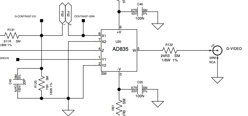

Ok getting closer!!! So I am thinking the short must be in the video socket somewhere. So i decided to lift the end of the 24.3 ohm R132(pic attached) that goes to the center pin of the video socket, this would put the short out of the equation and if i touch the center pin of the cable to the lifted end of the resistor i should get video. Well nope I got the same distorted image as before. Damn!!! So now I touched the video center pin to other areas on the video path as i did before lifting to see what would happen and find where there might be a problem if my theory of the short in the socket was correct.
So i touched the pin before R132, same, i moved to pin 5 of AD835, same, then i moved to the green input solder spot to AD835 that goes to pin 1 on that chip BINGO!! Video!!! So now i think its the AD835 chip my have been shorted out
when the socket shorted from the older socket. I think that socket is ok since i am getting no continuity between the center pin and the outer Ground. On the old socket i must have shorted to ground just enough to possibly send a short to the AD835 chip and blow it( I think its blown). So now what do i do? this is where I need advice as these chips are 34 bucks. do i remove the possible bad chip and put it on a known working board to test, if its bad should i put the good chip on this board even though i am not to sure about having fixed the short in the socket area or if was even the socket that was causing the issue. it may have been the octal dac , but i can't see if its in the same circuit for sure.
Well I am getting closer none the less.
Just read your post mike while i was typing this.. I beat you to it Wink i too did not think it was in the PCB I have not heard of that ever with low voltages.
EDIT: Mike would those 1.5 meg's cause the AD835 to go bad if not installed correctly?

Thanks Mike And Scott, Yeah the board doesnt seem to have the short now in that area. No continuity between the center pin and the outer section or to any of the ground points on the baord. I'll pull one off another VIM and order a new part to replace it. I am out the door now but will let you all know later tonight if this is the last chapter to this story.

No, those resistors are fine, it's just that I've found they could have done better on a few of the boards when they did the re-working of the board.
The AD835 is pretty robust, though it is sensitive to static and arcs. It's one of the main reasons to hold onto 02 VIM's.
Also, the 24 ohm resistor has been known to develop a hairline 'crack' - check that as well.

Athanasios, measure what it contrast control voltage to that green AD835 chip. If it is negative, then there is protection going on..Also test this: Start projector, when you got picture to tubes rapidly turn it off and on again. I have seen this thing happening with one of my vims. Turning it on again brings all tubes back to game, i never have looked what is culprit to that..But when contrast controll was negative AD835 had low/faint negative output. If that is case, then test if removing those variable caps+ resistors helps.

Ok I decided to first measure the contrast as Jarmo suggested and I planed on doing also while thinking about it all
last night while trying to sleep. he was right it was Negative voltage. so i looked at the schematics for the amp that outputs
contrast tot he AD835. U8 pin 7 negative so i went back to the next op amp that feeds U8 which is U9 pin 1 when i touched that pin the green grid came up!!! i did not solder the pin well when i replaced the chip the first time i was looking for the issue. That is why when i was pushing on the green socket it was intermittent coming in and out, the last push must have flexed the board enough to break the weak solder joint and cause it loose complete contact.
So i checked all controls and it all works. AD835 is still bad and must have been shorted some how since it doesn't work on my other board... Hmm I bettter check the solder job on that chip too now Wink
