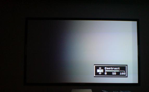

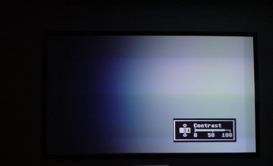

Do you remember who it was who had weird black level issues recent?? Mr. Green Me. I had to use 2035-02p vim to get rid all "brightness elevation" problems.. proper colorbalance was easiest to get with non modded 2035-02p vim.. Then i decidet to test that variable cap mod to that non modded vim-> troubles with colorbalance again. Those BW boosting things seems to made allkind of weird issues to low end (dark parts)
Mine acted that way when picture had much bright parts then blue background elevated, with testpictures i got pretty good results ( 10,20,,,,100 ire fields) but with real material blue background was "moving" along picture content.
Edit. here is two pictures how my projector behawed when i had those problems with my blue..
Notice that another picture contrast is lower and colorbalance is pretty ok and second picture contrast is higher and that made background bluish..
Those horisontal bars are from camera..
