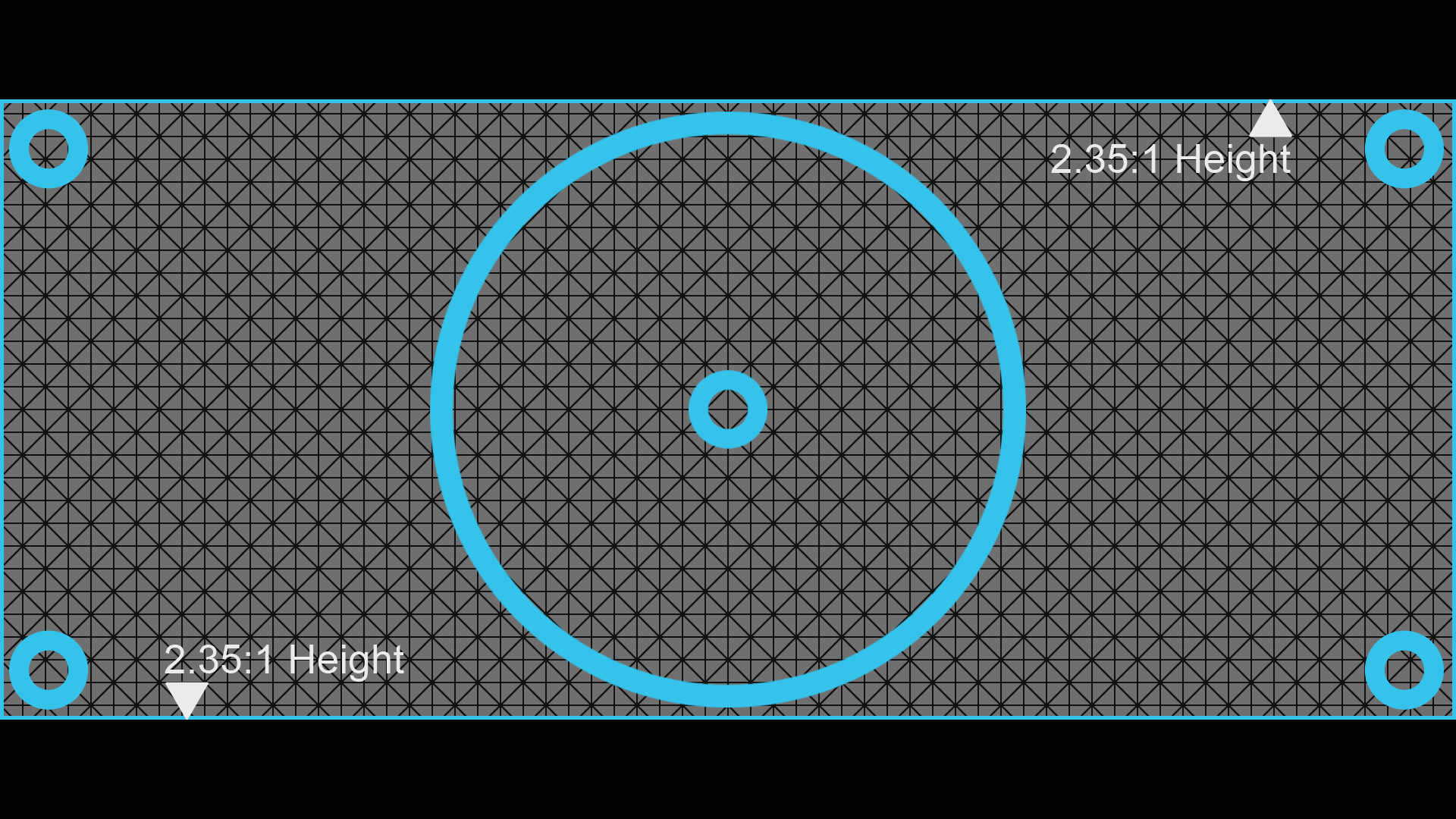

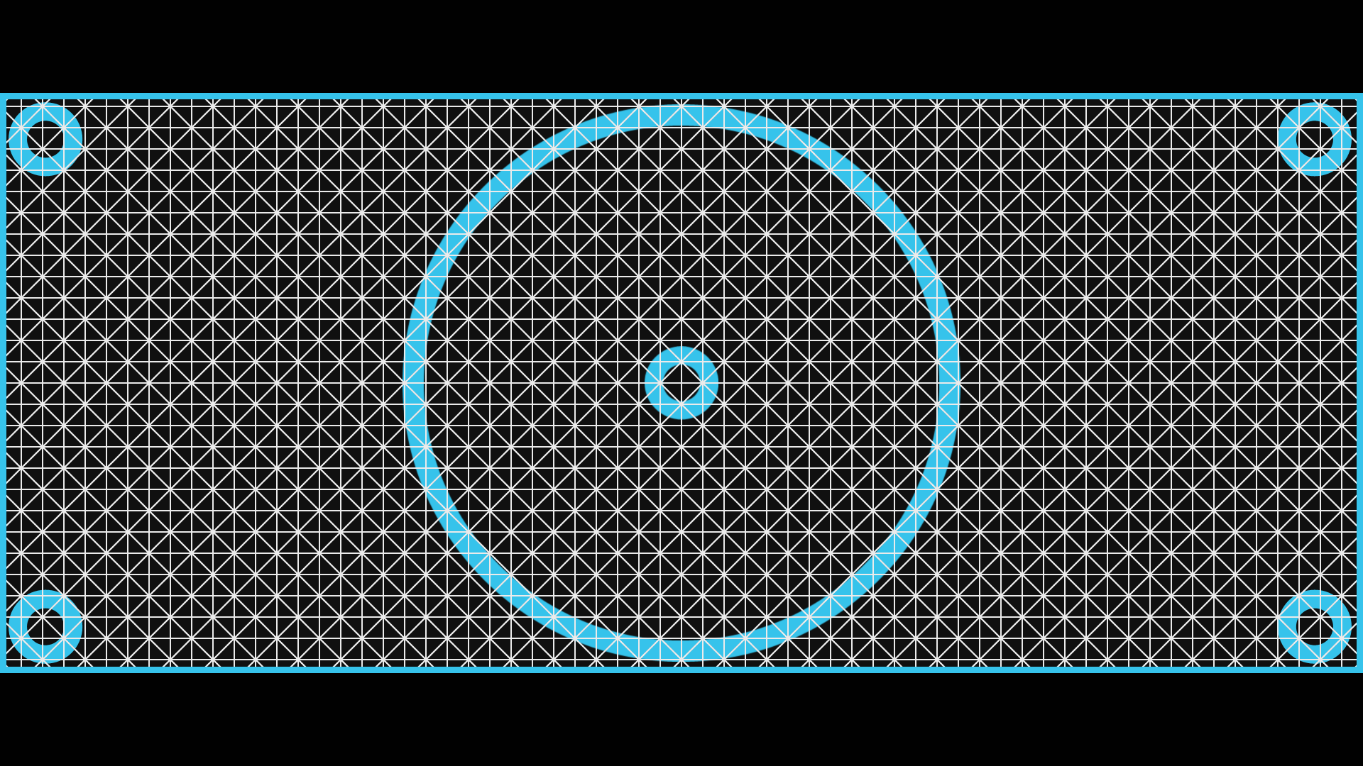

Here are the patterns I use. I had aluringreality who designed the AVSHD disc to make them for the blend.
 Filesize:  148.46 KB
 Viewed:  5397 Time(s)
 Filesize:  155.12 KB
 Viewed:  5393 Time(s)
