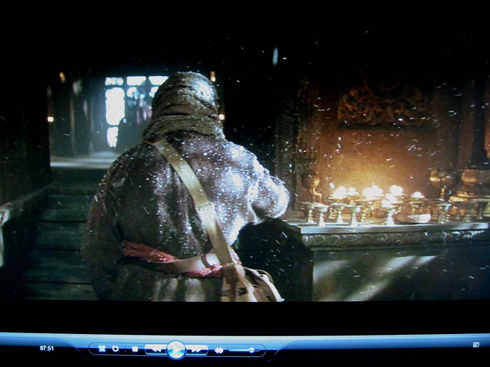

RogueChili wrote:
A fellow EE, looking forward to working with you! Andre, can you post a picture that clearly shows the streaking? Something similar to my post. We have to establish a reference, something to compare after the upgrade kit is installed. We’re working with a tough crowd here!
5th element starts with a nice one, only quite hard to capture the streaking .....
My 1292 is not too bad with streaking, but it would be great to get rid of it Thumbs Up
André

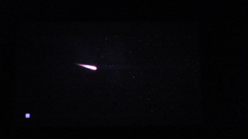

[quote="speedyandre"]
André
Great, I'll check it out! With and without mods.
This scene from Batman Begins is ugly on my 1292, both streaking and shadows. If you have it check it out, let me know.
[/img]
 Filesize:  156.23 KB
 Viewed:  12748 Time(s)

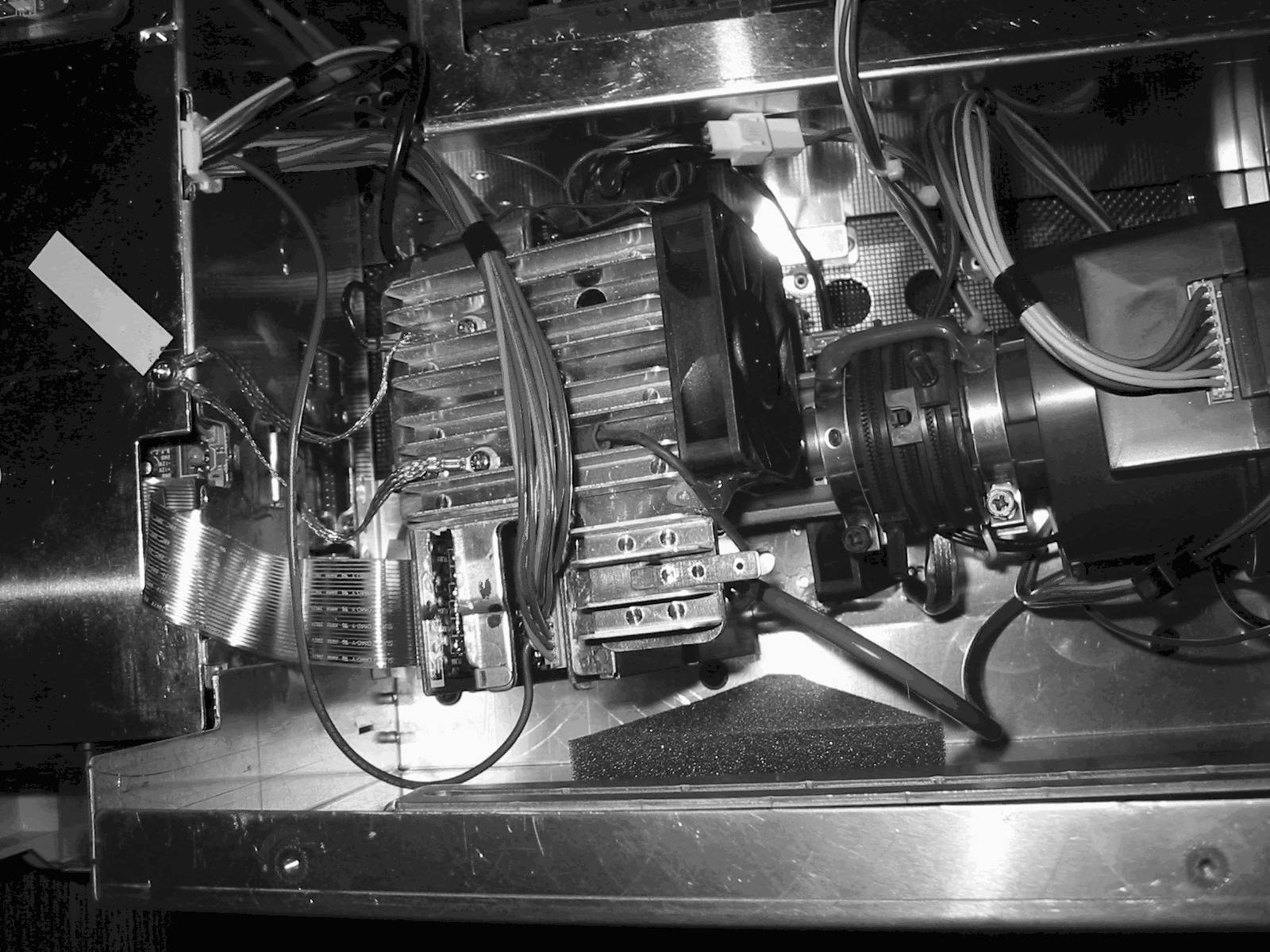

speedyandre wrote:
I wonder if I can speed down the neckboard fans when this mod is used.
Sony added these fans to minimize the streaking problem, I wouldn't complain if I could reduce the noise further ;)
André
Funny you ask that! Someone posted a poll on the cooling efficiency regarding covers on vs. covers off and it got me started. Well, that and all the slams about the noise from the 1292.
One thing I found is reversing the to main fans reduces the noise significantly. The problem is what effect this has on the cooling efficiency. I am in process of determining that now with trusty temp probe attached. If anything comes of it I will post.
speedyandre
Joined: 18 Dec 2006
Posts: 291
Location: Netherlands
Posted: Mon May 04, 2009 8:30 pm    Post subject:
The 2 exhaust fans on top should blow the air out of the 1292.
All other fans are blowing into the 1292.
When you reverse the exhaust fans the hot air doesn't go the right direction and maybe stays inside.
I have replaced the 2 exhaust fans for Papst 4412F/2GL and placed them in series to lower the speed.
This is only working well if you fake the fan protection by shorting the black (or blue) and yellow fan wires.
The fans of the PS are still unchanged because I blew a PS when I lowered their speed Twisted Evil
Other fans have blu-tack between them and the chassis to eliminate vibration.
My 1292 now has a noise level like a big tower pc, there's no roaring anymore, only hissing Thumbs Up
André
I'll be broke
RogueChili
Joined: 31 Mar 2008
Posts: 162
Location: Westfield, MA
Posted: Wed May 06, 2009 3:51 am    Post subject:
Speedy - During my experimenting I am using zener diodes to control the fan speed. If inserted in the positive fan lead the tach circuit will continue to work properly. One caution, the zener power rating must be considered.
So, with the original neck board fan removed, and replaced by two 12v micro fans, the temperature on the heat sink is lower than with the original fan and you can't hear the micro fans. More testing to do but looks promising! You can see the two fans in the pic.
