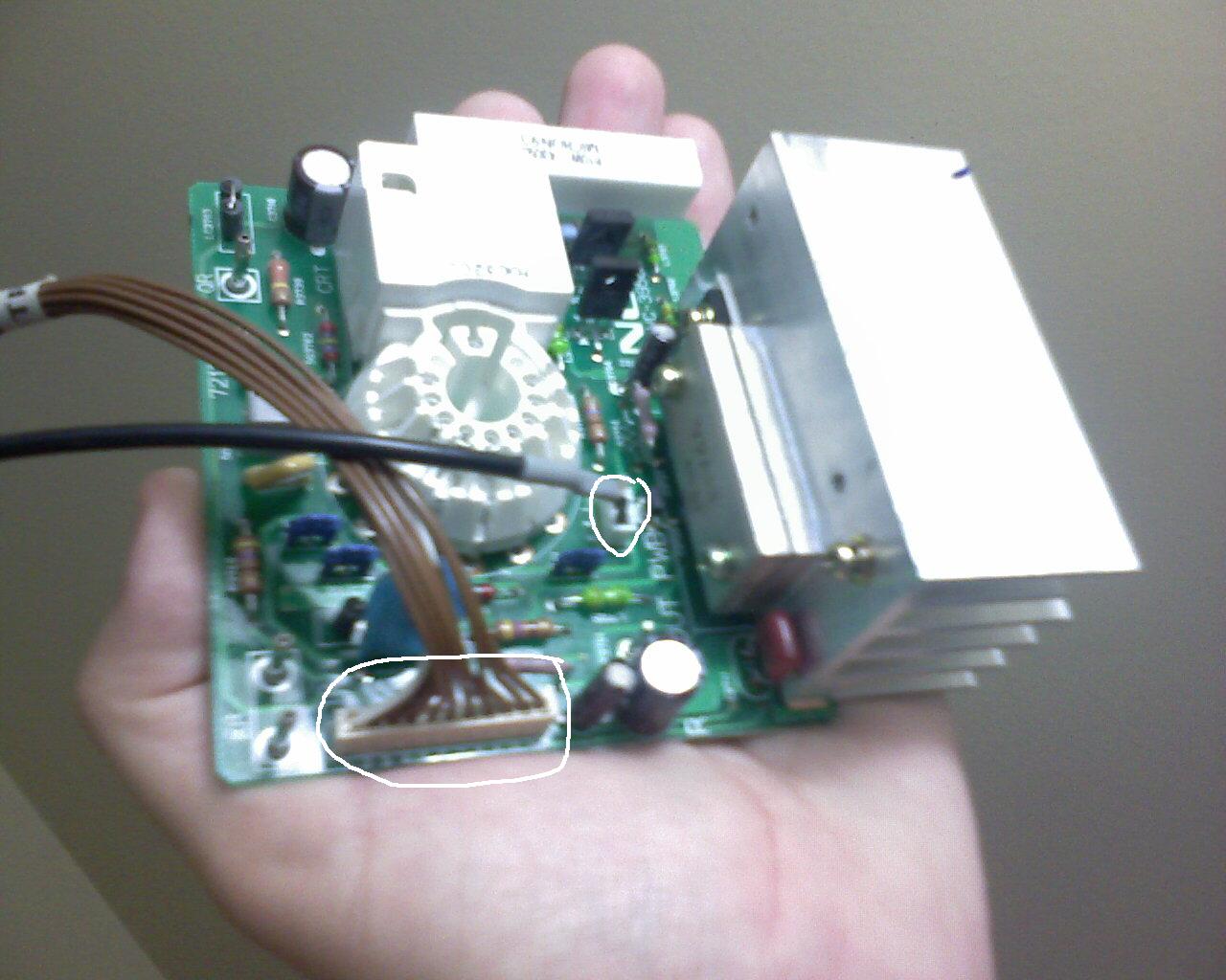

Posted: Thu Apr 02, 2009 6:10 pm    Post subject: neck board swap.
Before I will buy a new neck board I decided to swap the red one with the green. I removed the red tube neck board and was attempting to remove all the connections from it. Two connectors will not come off, are they soldered in or should I use some extra force to remove them? Can I test the projector with Green tube wires not connected, will this cause some ill effects? Attached is the image showing connectors I have the problem with. Thanks
