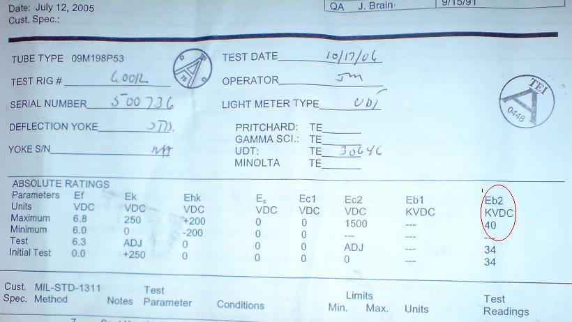

Mike here are the data sheet pics.
What can you get from theses mike? I can ask Aferg what Voltage the Triton 1080HD projector used for the HV supply value.

Posted: Thu Mar 19, 2009 9:42 pm    Post subject:
Mike these are not 40KV tubes, Aferg confirmed that in his E-Mail, and looking at the second sheet i have (did not take pic of it) it lists how the test are to be preformed. There is no mention of 40KV I will retype the second Sheet.
Notes:
1. The Cut off voltage is the grid No. 2 voltage required for visual extinction of an undeflected focus spot. This
is accomplished by adjusting the Grid 2 control with a fixed Cathode voltage applied.
2. The line width is measured at the center of the CRT, Both Horizontally and vertically using the merged line method.
3. Area brightness of a raster having the size indicated and the measurement taken with a photometer with a photometric
response curve. The photometer acceptance area is sufficiently large to measure several adjacent scan lines.
4. Is the peak or instantaneous value at the stated condition.
5. Is the difference between the recorded cutoff voltage and the voltage at the indicated conditions.
6. Normalize for a -50VDC grid one via reduced G2, with anode set at 20 KVDC, and raster fully scanning the phosphor area.
maintain 0 bias for less than 5 seconds.
7. Each CRT shall be subjected to a 4 hour minimum D.C. spot knocking prior to test.
8a. With heater voltage supply "off", connect the 9M198 to the test console. Set G2=0.0V, G1=0.0V, K= +250V.
Spark Trap shall be grounded for test.
b. Observe the Grid 1 leakage meter. The measure leakage should be 0:A
c. Turn the heater voltage supply to 6.3V.
d. Observe the Grid 1 leakage meter. The maximum leakage current allowed during the first 2 minuts of operation for a cold
start shall be 3:A. Record as S/SU on data sheet.
9. Set voltages and currents as follows. Burn-in to be performed for the maximum hours listed.
Set Anode voltage t 30.0KV
Set Focus voltage to GROUND
Set G2 voltage to 500VC
Set Filament voltage to 7.5V
Set Anode current to 200uA
10. When setting the 1500uA level apply a 50% duty cycle blanked signal.(This would be an on-time of 26uS for a standard 525 line raster.)
Set Anode current to 750uA. This approximates the drive conditions of 1500uA @ 100& duty cycle.
This is what the data sheet says for the test proceeders of the test records in the pics i posted.
Not sure if it helps.... I'll make sure from Aferg if these are definitely 34kv tubes.
EDIT: if you look at the pic of the data sheet you'll see on the right bottom of one pic 34 twice,
its in a column that has Eb2 and KVDC under the Eb2. I think that is the KVDC for the tubes.

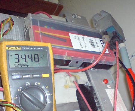

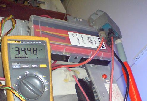

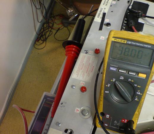

Posted: Fri Mar 20, 2009 8:05 am    Post subject:
OK. THIS IS SOMETHING THAT YOU SHOULD NOT TRY IF YOU DONT HAVE EXPERIENCE AND PROPER TEST GEAR!!!!
Here are results, HV selection jumper at 40KV position-> No hv out (probably different control pcb is needet. Not clm, that one that is inside of HVPS)
I started with measuring hv and hv regulation (pictures shows that there is no variation between Min/Max contrast.So regulation works perfect.
Then i tested what is max voltage that can be taken out of HVPS. It goes up to 38KV and if i try adjust that higher then there is OVP that limits it.
OVP was set to trigger at near 36KV when i tested that. Now it limits HV to 38.250Kv so there is not much room between Max HV/OVP trigger point, only 250v.
So this evening iīm gonna test how that old M8000 hvps vith 38Kv out works with those thomas tubes..Wish me luck Laughing

Posted: Fri Mar 20, 2009 11:05 am    Post subject:
There is that 40KV at Max section(inside red circle), test is done HV at 34KV

Posted: Fri Mar 20, 2009 11:47 am    Post subject:
Right Jarmo, but i think that is just a maximum that the tube will handle and not what it should be run at. Aferg has them set for 34.9 KVA on the old PJ they used.
And here they ran tests on them from 20KV up to 30 KVA if you look on the second sheet describing the tests , and the results are recorded on the first page. I think the 34 KVA below the 40 KVA is what they are finally to be used at. But try them at the 38 KVA and see what happens, maybe its too much and 34 is the correct value? I did not see the blooming problem on my VNB i used for the test and neither did Aferg. But i need to put on in and have a closer look, but i did use a magnifying glass to see if i could see the individual lines that are in each grid line and they were there up to 50 for sure and still there to 60 IIRC.
But i would be interested in your experiment !!

Ok i started testing by measuring HV at my main HVPS, it was 35Kv. Then i installed second HVPS that was adjusted to 36KV and connected only red, raster was smaller, about two inch horizontal and little less at vertical.
Blooming seems to start little higher contrast numbers and there is more brighness also focus needet readjust to lower.
So mike was right higher hv seems reduce blooming..But if i think to use higher Hv voltages then i run out of size control and also focus range is going to be problem.
So iīm going to put my main HVPS back and live with this little issue and wait those Frankenyokes to arrive Smile
Btw. while i was there, i measured resistanse at HV-splitter: From M8000 in-> out connectors 22Kohm and splitter from 97 7500 (8110) There was 3,3Kohm.. In theory that makes little more hv drop at high beam currents (older splitter)
But mine seems to be ok.
