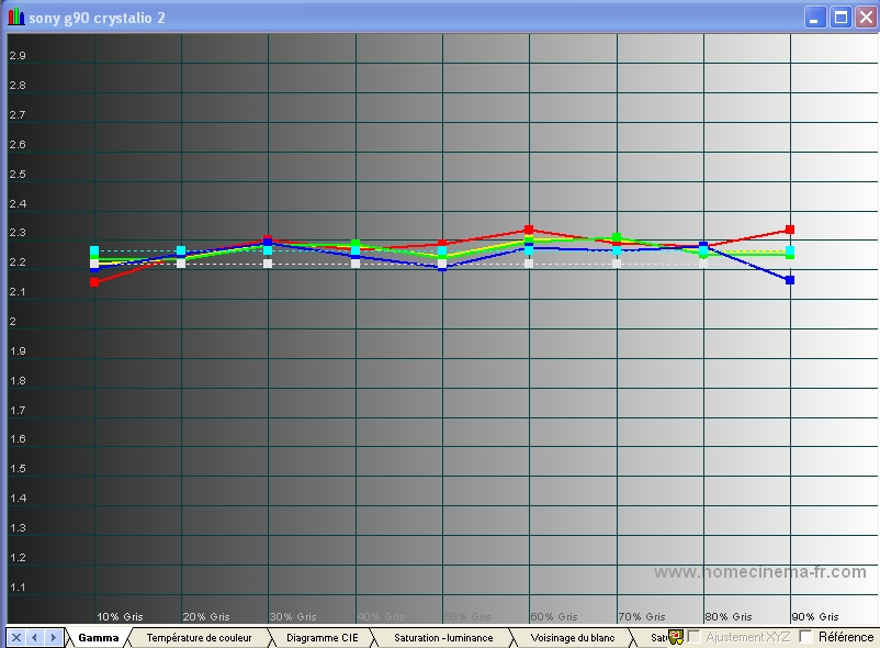

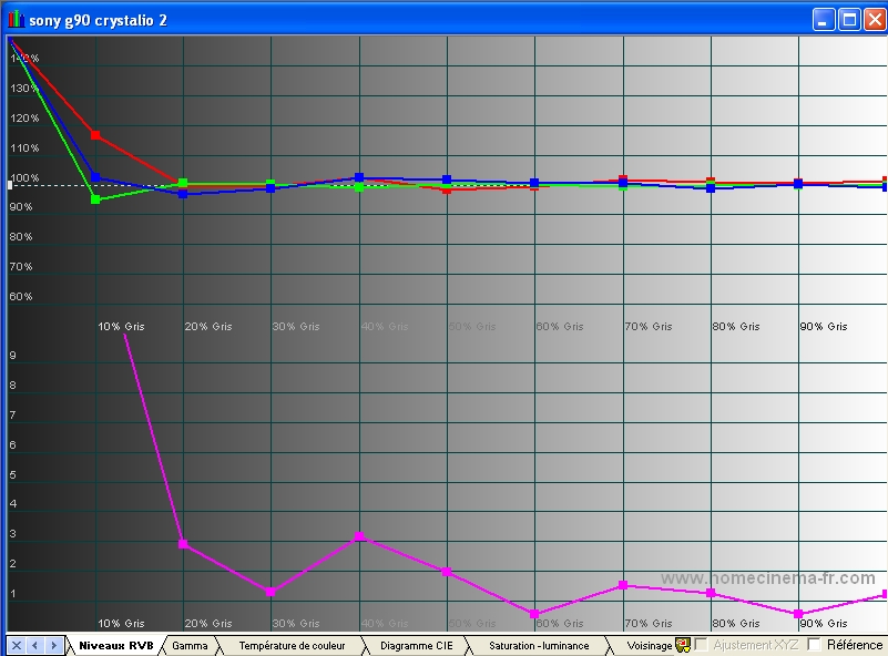

Hello, I made further steps this time with the crystalio 2 for correction.
I again used the spyder 2
 Filesize:  210.47 KB
 Viewed:  5721 Time(s)
 Filesize:  191.01 KB

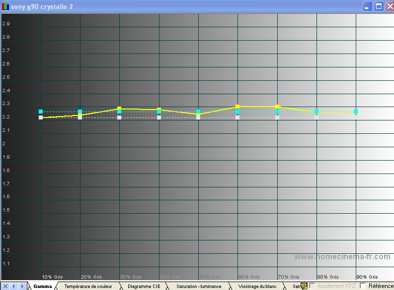

 Filesize:  185.3 KB

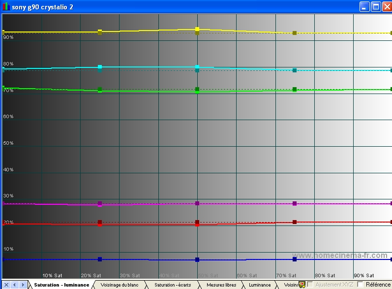

 Filesize:  191.05 KB

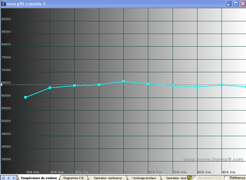

Posted: Sun Mar 22, 2009 11:33 am    Post subject:
Arrow
 Filesize:  162.66 KB
 Viewed:  5717 Time(s)

Posted: Sun Mar 22, 2009 2:01 pm    Post subject:
Looks great.
Ever consider trying gamma of 2.5 instead oif 2.2? If you theater is in a totally dark room you may want to try 2.5.
