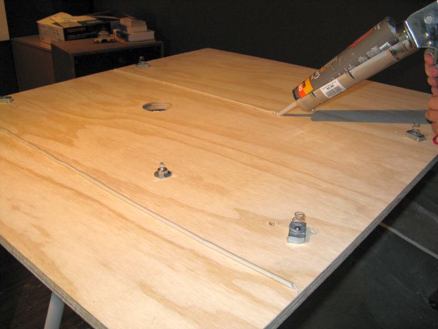

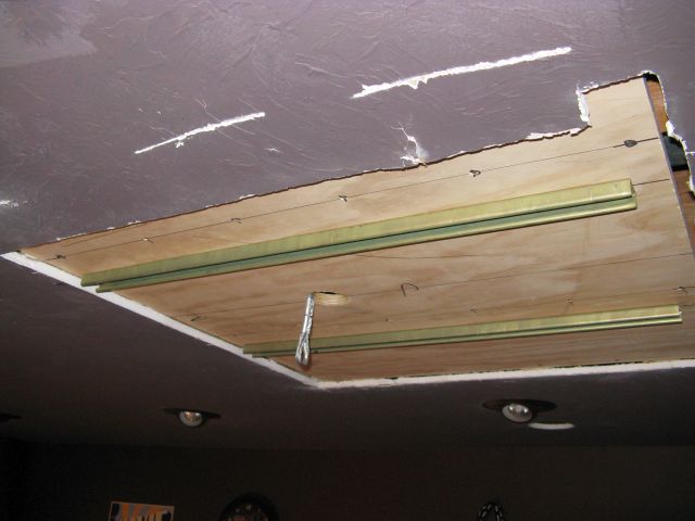

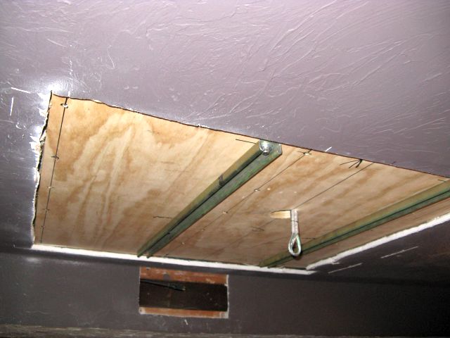

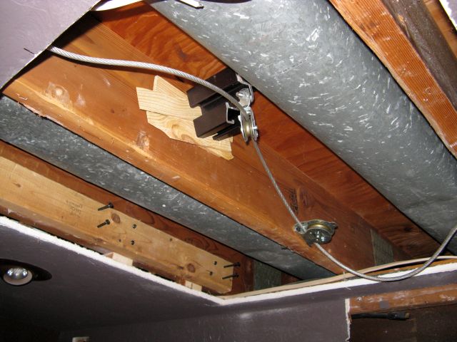

Okie dokie... This is Chip's mounting method. HOWEVER I still recommend picking up the center of an engineered timber rather than the bottom... that bottom rail is intended to be in tension longitudinally, not in pure shear straight down.
You can see the cable arrangement for the lift, and 2x4 sister joist which was used to allow the sheet-rock strapping and plywood to both have a full joists' width for fastening. (If the rock were cantilevered it would have never held a tape line.)
The plywood is 3/4" AC with no voids, and the sheet-rock is held off the joists 3/4" with strapping, making the plywood flush with the BACK of the sheet-rock. Those two sawzall slits at the top of the last pic were to remove several inches of strapping so the sheet-rock on that side is fastened to the plywood.
Screen alignment of the low-profile unistrut rails was accomplished with a laser level prior to fastening with a few dozen 3" sheet-rock screws. With the help of Chip and a single screw near the centroid of the plywood plate, this was actually pretty easy AND dead-balls perpendicular to my screen wall.
Finish (not shown) was accomplished by fastening new 1/2" sheet-rock over the plywood plate, taping and mudding conventionally, and then mimicking the plaster texture (boy howdie was THAT a learning curve for me!)
The low-profile 'strut rails are about 1/8" taller than the finished ceiling, 1/4" or so from smooth sheet-rock. Standing just barely proud of the finish lets the top mount slide back and forth and does not draw the eye (well, any more than a 200+lb projector hanging from the ceiling!)
Before anybody asks, the odd dogleg cutout in the ceiling (top-right corner of the last pic) is the location of the ceiling duplex outlet for the NEC 9PG mains input. This was moved for the Marquee 9500 to the front, also not yet complete in these pics.
FYI for anyone doing this: You can find good quality 14 or even 12 gauge IEC mains power cords as short as 12" online and at specialty electronics hobby stores.... I've got three more of them in my equipment rack making the short run to a full-height power strip adjacent to the rack. Clean, no bundles wire tied and hanging out everywhere, and they look better (IMO) than the old 'cut-it-short and replace the cord cap' act.
