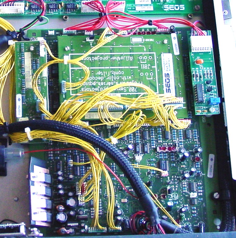

Posted: Tue Mar 24, 2009 2:03 am    Post subject:
huggy wrote:
Yes I do have Horizontal Linearity Mr. Green sh*t!!! I thought all this stuff was standard,no wonder it was so easy to geometry perfect. Thumbs Up
What does this horizontal linearity board look like? Part number? I have a 1209s SEOS convergence tray and it has two thin boards mounted one on each side of the COG location. Is one of those it?

Posted: Tue Mar 24, 2009 5:58 am    Post subject:
Hi Mark Very Happy
I only have the COG board in the tray and no other little boards beside it.
bbfarmht
Joined: 27 May 2006
Posts: 1273
Posted: Tue Mar 24, 2009 7:07 am    Post subject:
On the left hand side of the picture is the seagull correction board. The board on the other side I'm not sure, but I think it might be a SEOS board.
