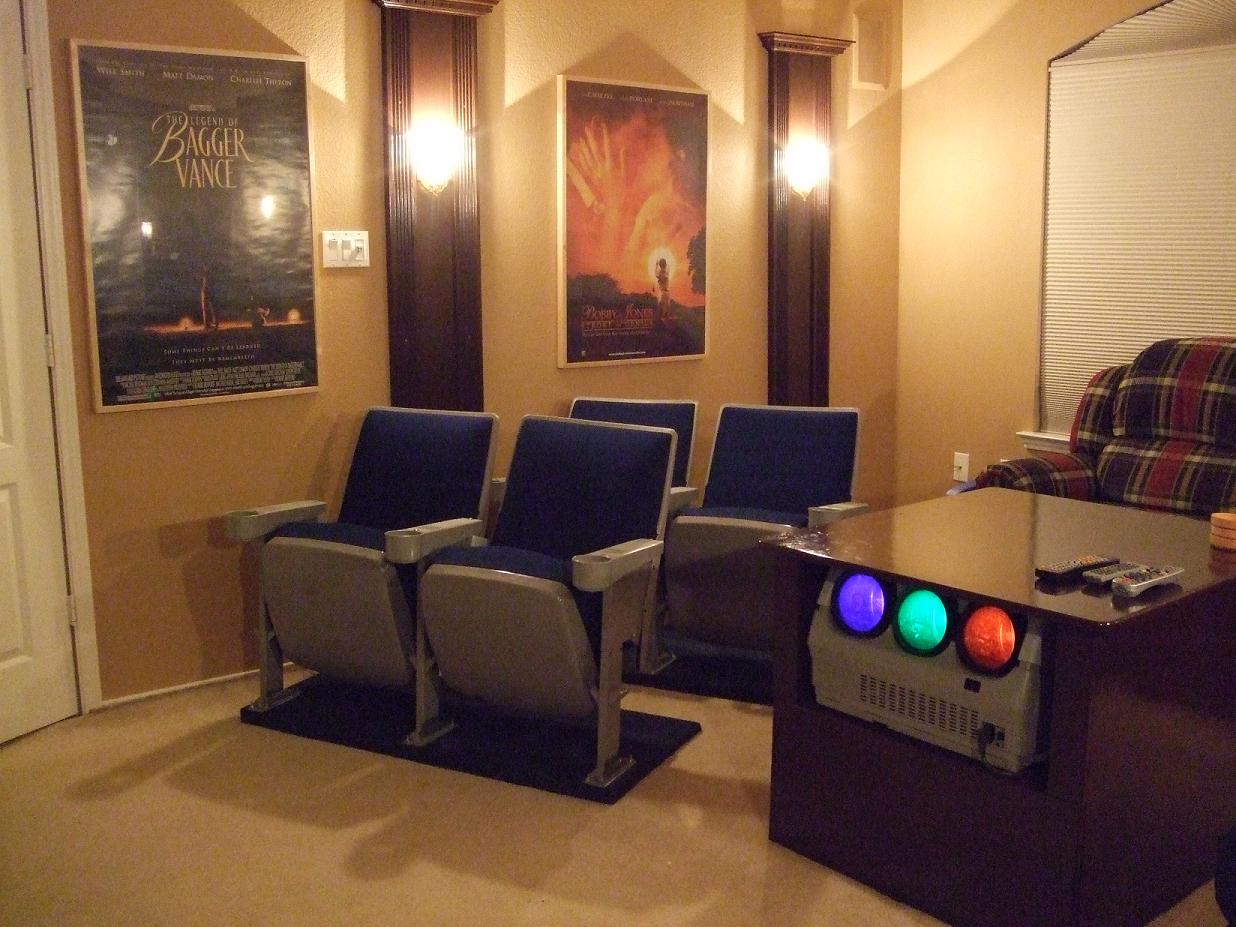

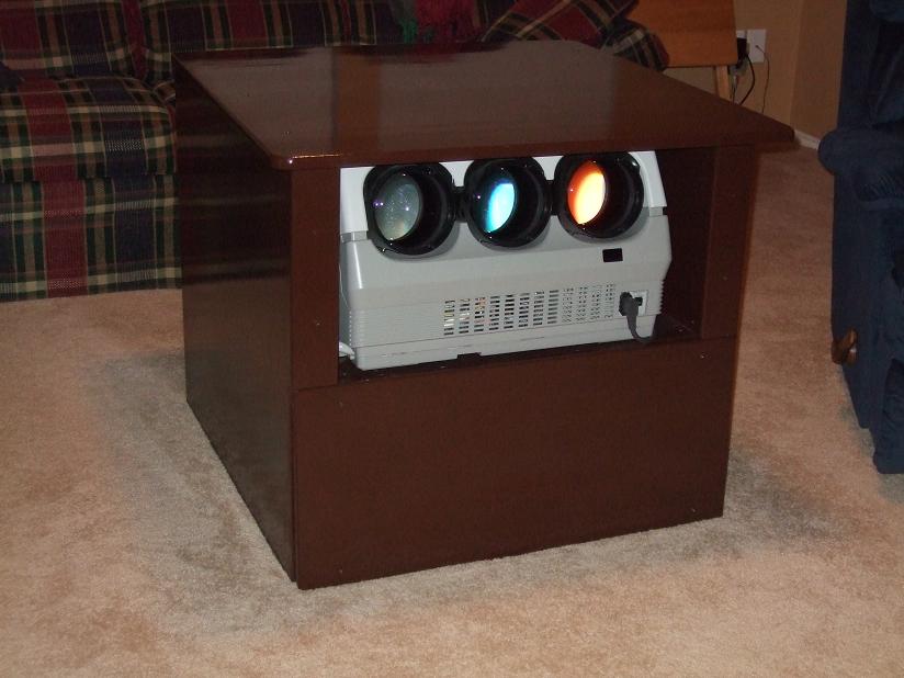

We had a CRT meet a few years ago in Dallas at a members house who had I believe a modded Barco 1209. Of course it threw a very nice picture but IMO my D50's is at least 85% as good for much less cost. I picked up a spare D50 with 1600 hours a few months ago off of CL for $160 so they are out there for cheap. I now have no worries about the amount of time my son plays Wii and PS3 on the PJ. I included a few pictures of the table I built for mine as ceiling mounting was not a good option.
Dan
