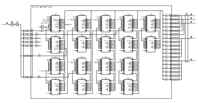

Posted: Thu Jan 29, 2009 8:14 pm    Post subject: Some more informations about CXD305-127R and CXD2309Q chips
Following Ron's post, to add informations about these SONY specific ICs, here is some more information :
First chip the CXD2309Q :
This chip is a triple 10 bits Digital to Analog Converter. On the G90, this one is used to generate the RGB tube G2 control (D/AR, D/AG, D/AB seeen on below schematic) for ABG operation. Here is its Block Diagram :
It seem's that this chip can still been found as spare today. Ron's found them on the Bay for $18. I've ordered some to be safe. FYI, I've also asked the seller about CXD305-127R availability, we never know Rolling Eyes
Second chip the CXD305-127R :
As pointed by Ron, this chip is *NOT* a DAC but only a DAC controler which is able to broadcast digital informations through three I²C standard like serial link buses.
The chip is mapped inside peripheral memory and use Address (A0-A7) and Data (D0-D15) microcontrolers buses that is common to all YA's CPUs (EXT BUS). This chip is selected to the correct address segment through its CE pin. It provides three serial communication links and some control lines :
- DCLK for all buses I²C common clock line
- DLD(0-3) for three "Load Data" lines
- DDATA(0-2) for three I²C like data lines
- PB(0-4) for 5 DACs ICs banks access
- D-RESET for DACs ICs reset
In fact, almost all the G90 adjustments analog voltages are generated from DACs located on DE board. And all these DACs are driven by this single CXD305-127R that is responsible of the broadcast of 'almost' all the parameters used to set the G90 operations. That is why a failure of this single chip is a real disaster for the owner as it makes the unit completely unusable Evil or Very Mad Evil or Very Mad
This chip is only 100% digital and was probably made using a generic CPLD core as this CXD305 ref is used with several different suffix :
CXD305-101R CMOS signal processor http://datasheet.digchip.com/000/000-1-CXD305-101R.pdf
CXD305-110Q
CXD305-114Q
CXD305-116Q
CXD305-122Q
CXD305-127R
Personnaly, I don't think that this chip have a firmware but maybe this CPLD was fused programmed during manufacturing process (ROM) using a specific 'program' that internaly hardwired all the necessary logic functions inside the CPLD. Maybe the reason of this chip failure is due to its 'programmability' ; some fuse may have changed their state while the chip gets old ??
If we want to have more information, we need to find is datasheet document (maybe from Sony design team members ? I'll try this with one the Japan G90 engineer man I know, not worth to ask !)
Here is the complete schematic of these two chips inside the YA board :
John

the diagram above shows IC421 connection to "DAC". Is there a diagram showing the other IC the connections to "DAC" ?

Posted: Fri Jan 30, 2009 10:48 am    Post subject:
"DAC" buse is the set of I²C like connections between the DAC controler and the DE board where most of the DAC chips of the G90 unit are located.
I can post the DE board block diagram to make things clearer if needed.

Thanks, I am curious to see how the lines are distributed amongst the DAC's.
So, basically we have a multi channel serial port with device select decoding and timing control. It seems a generic PLD can be programed to do that?

Here's a picture of the DE board. A little blurry though. How do you guys get a good pic to put here from a pdf page? I've been wrestleing with that for some time now.
[/img]
 Filesize:  58.21 KB
 Viewed:  12956 Time(s)
Posted: Fri Jan 30, 2009 5:59 pm    Post subject:
On A mac you can select part of the PDF image and select it then save it Jpeg or Tif Gif etc not sure id acrobat can do the same as Preview on the Mac.
kschmit2
Posts: 1141
Location: Heidelberg, Germany
Posted: Fri Jan 30, 2009 6:34 pm    Post subject:
[/img]
I usually open the PDF file with Photoshop. It'll open a dialog that lets you select the pages, and allows you to set a DPI/PPI value which it uses to render that page into a bitmap file.
I usually start with 300 DPI, and increase it where required.
If the file contains vector graphic elements you can pretty much render them as large as you want.
The G90 schematics are vector graphics iirc.
Kai
