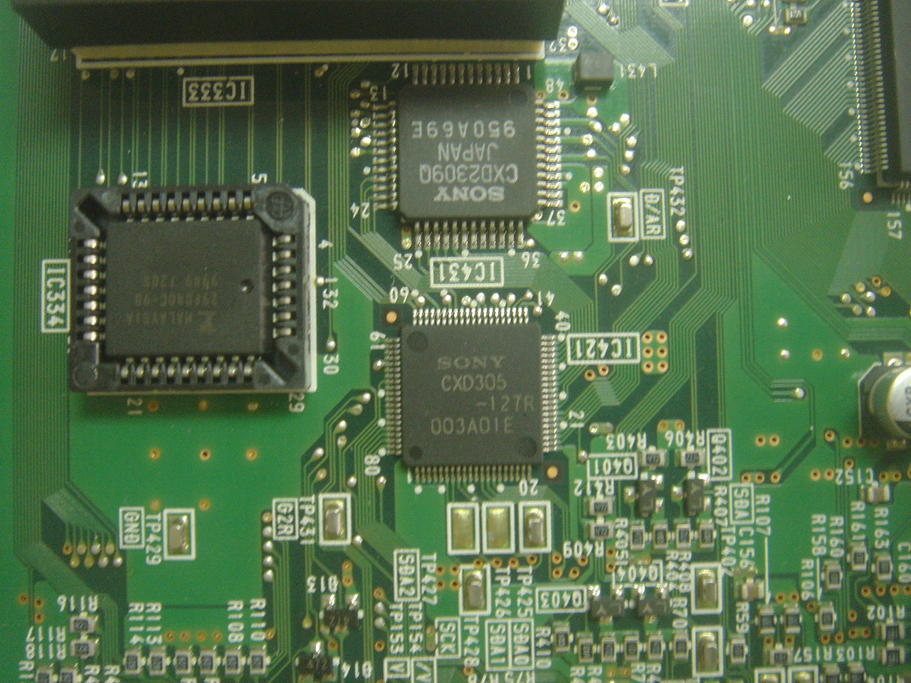

Posted: Fri Apr 24, 2009 2:51 pm    Post subject:
And the chip number of yesterday's 'bad YA board' email is.....
 Filesize:  308.76 KB
 Viewed:  8924 Time(s)
CIR Engineering
Joined: 25 Aug 2008
Posts: 4269
Posted: Fri Apr 24, 2009 2:55 pm    Post subject:
Surprise surprise Evil or Very Mad
I am so glad I have a YA here with a different IC421 serial number... my parts machine with 7000 hours.

Posted: Fri Apr 24, 2009 2:57 pm    Post subject:
Too bad the number of G90s out there aren't higher, this reeks of a ripe class action lawsuit.
CIR Engineering
Joined: 25 Aug 2008
Posts: 4269
Posted: Fri Apr 24, 2009 3:02 pm    Post subject:
We are going to have to come up with a viable substitute. The ironic part is that low hours machines are more likely to have the problem IC421...
Earlier serial number machines have different IC421 serial numbers and the earlier machines tend to have high hours on them. My primary G90 only had 600 hours when I got it (now at 1100) and I was so happy to have a low hours unit. Now it seems that high hours has a much better chance of running reliably for even longer. My 600 hour machine has the bad serial and my 7000 hour machine has a different serial.
