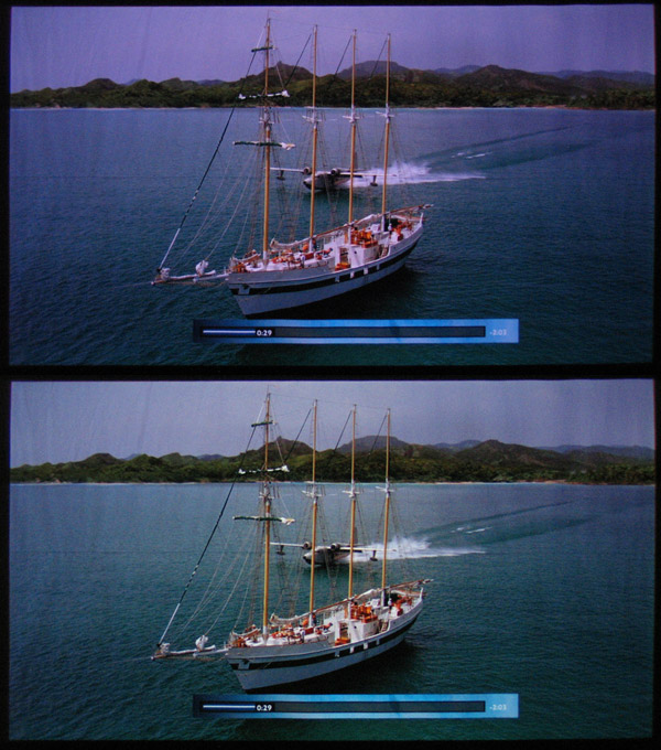

It alive, IT'S ALIVE!!! Smile
I hung some BOC from the ceiling (temporary), did a quick table-top setup (also temporary) and dropped in a couple BluRays. It works! And it looks pretty good for a not-so-thorough setup.
The image above is at 1080p60 using HDFury2 and my BD player (Btw, my camera really sucks. The picture looks better than this). The screen size is 99" wide. It turns out I'm not going to be able to hit the suggested TD (actually, it depends on which version of the TD formula I use) so I won't be fully maximizing raster. I have very little wiggle room for projector placement, and if I bring the screen closer, it'll be too far into the room. Oh well, as it stands my quick setup is projecting beyond the burn area put on by the previous owner, and it's noticeable in bright scenes, so I have to bring the image in a bit anyway. Just kind of a bummer.
BTW, that ACON is one *handy* little accessory. I went into the service menu and did a full reset, and of course everything was out of whack at that point, and I was dreading having to converge the whole mess. The ACON isn't perfect, but it certainly does most of the heavy lifting, getting you 85% of the way there. Can't imagine owning a pj withone one. Smile

Wow, first weekend home with your new machine and you have a nice watchable image on a bed sheet, already. Kudos!
It could just be the camera, but it looks like you could use quite a bit more green (or less magenta - as in less blue and red), but other than that - NICE work!
Here's your image, and one I adjusted in Photoshop to have less red and blue... Notice how the whites on the boat are more white instead of pink.
Thanks. It's a testament to the helpfulness of the guided setup on the Marquee as well as the info found on this site.
It's very possible my colors are off. I'm no where near the point where I'm ready to do grayscale calibration, and I don't know how good these pj's are "out of the box". Come to think of it, I haven't noticed any settings in the menu for adjusting cuts/drives on the individual primaries. Where is this located on the Marquees?
Also, my camera is old and sucky. It's a Canon PowerShot A95, 5MP. I'm sure there's a proper way to set the camera to take screen shots but I just used "auto".
Posted: Mon Feb 02, 2009 5:16 am    Post subject:
On the Canon G2 ( 4mp ) I use for my screen shots I use TV ( time value ) to shoot my TV ( RPTV Smile ), try a multiple of your refresh rate. Depending on the scene I use 4 seconds, 2 seconds 1 second, 1/10th. 1/30th etc... Play around with it.
