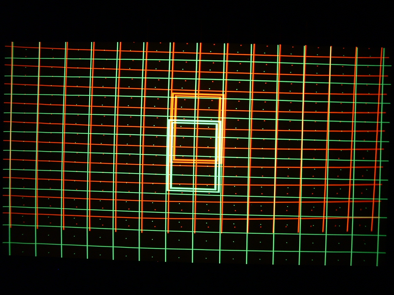

Posted: Wed Feb 11, 2009 12:59 am    Post subject:
"Like I said earlier, go into any converegnce menu and push ZERO, turn contast down a little, and see where the grids are on the tube. I bet the red is way up towards the top. Also look to see how tall each grid is, they should be close to the same height relative to each other.
Here is the (not-so-great)photo from the "zero option"
What do you think?
 Filesize:  375.61 KB
 Viewed:  5054 Time(s)
home theater provided by soft drink industry
Posted: Wed Feb 11, 2009 1:14 am    Post subject:
Yepp the red looks way off. it needs to be mechanically centered so you dont use the electronics so much , having it that much off from the green will cause excessive strain on the convergence circuits and scan yokes circuits. you need to go in there and physically move the focus coil by loosening the three brass wing nuts and removing any hot glue used to hold it in place, if there is no hot glue then it will be easier but after i recommend putting some on there to hold in place better. Go to times marquee site, I think there is an explanation on how to do this. also add the blue into this pic so you can see if that needs adjustment as well. One piece of advice if you can use an external grid pattern while doing this it would be better as the timing from your actual source will be different from thew internals.
It is also skewed a bit, not on the horizon like the green is. That is a bit more involved and if your not comfortable getting near the open wires on the scan yokes dont do it. Leveling the scan Yoke is also explained on Tims Site.
