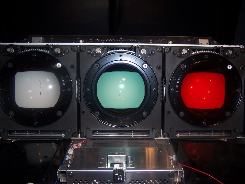

Man! What is the deal with the number of G90s turning up with deflection burn in all three tubes?!!!!!!!!!!! There are supposed to be a ton of protect circuits to prevent this very thing from happening. Something is definitely flawed here!!!
I don't need to remind you of the less than 200hr unit I got burned on in the pic attached.

here is the marquee's burn I don't thin we ever nailed how this one occurred but i think it have to be a deflection coil fault.
Naaah... That's a pubic hair on the inside of the glass! Somebody at E'Home was gettin they freak on on the build bench!
