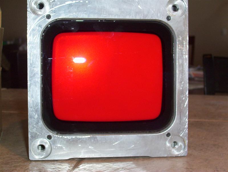

Ive done it, but be careful because it's very easy to add too much color. Good news is after 2 years of sitting on a shelf the Dye is still fully emulsified.

where did you buy the dye?
Posted: Sat Dec 20, 2008 9:19 pm    Post subject:
I forget where,but it was a musical instrument builders supply place. It's called Stewart Mcdonald Colortone Concentrated liquid stain. Cherry Red and Bright Green. It one takes 1 or 2 drops of each with green being the more concentrated (use less).
http://www.stewmac.com/shopby/product/5032
