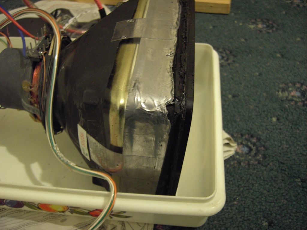

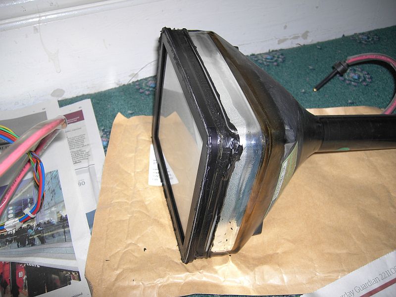

A few pics to clarify:

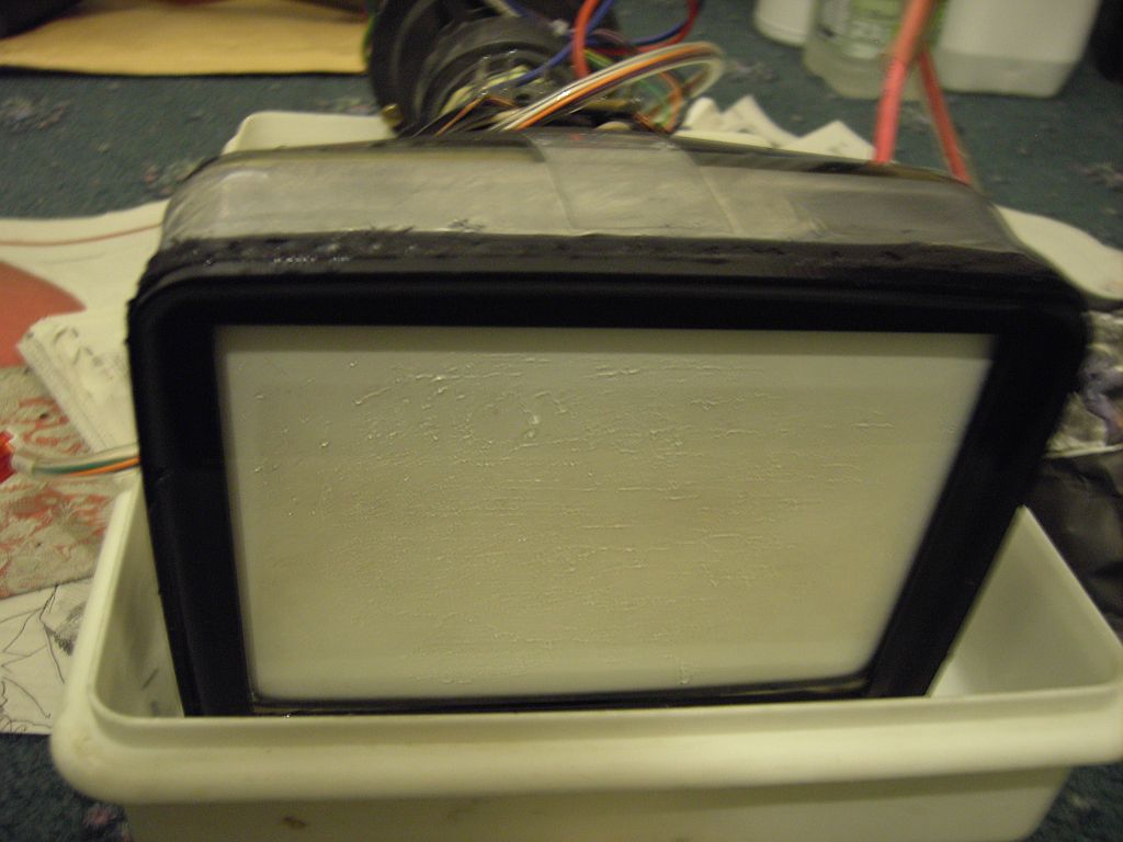

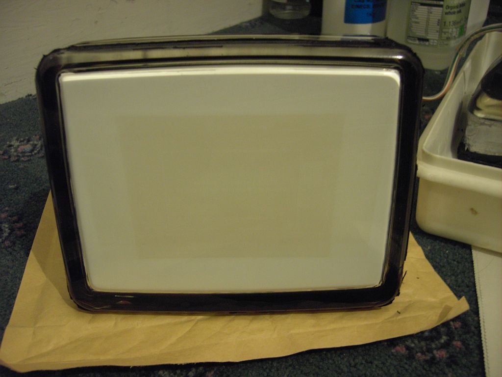

side view of new tube, nothing to indicate what it is.
 Filesize:  107.88 KB
 Viewed:  8206 Time(s)
new tube, it had sony elite written on the top of the lc chamber. It also has the rectangular piece stuck to the face of the tube covering the edges not stuck in the lc chamber.
 Filesize:  89.64 KB

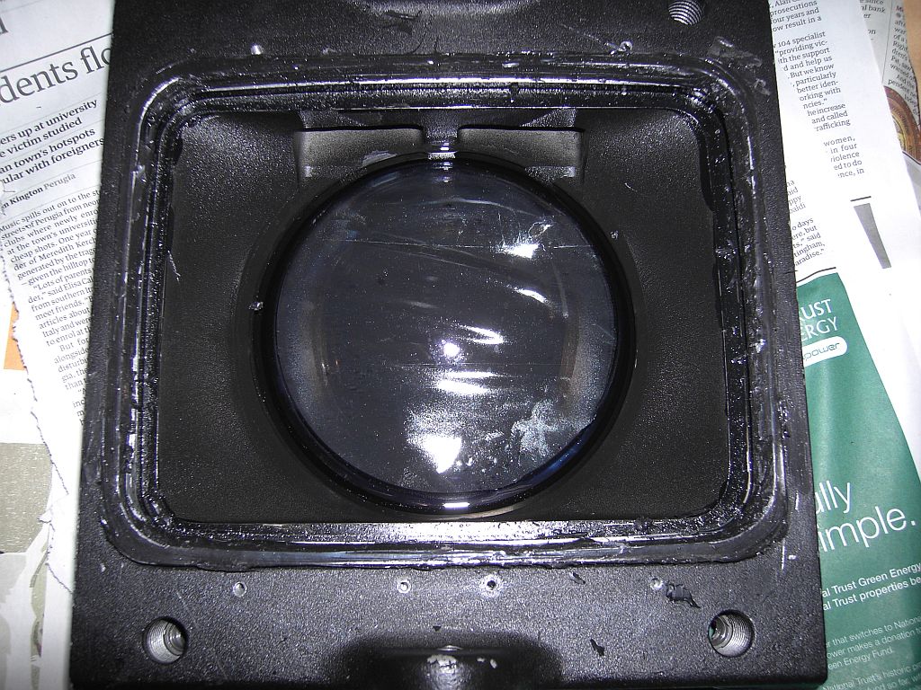

fungus lc chamber with no rectangular piece in it. This is for the new sony tube ( I think its a sony tube )
 Filesize:  236.21 KB

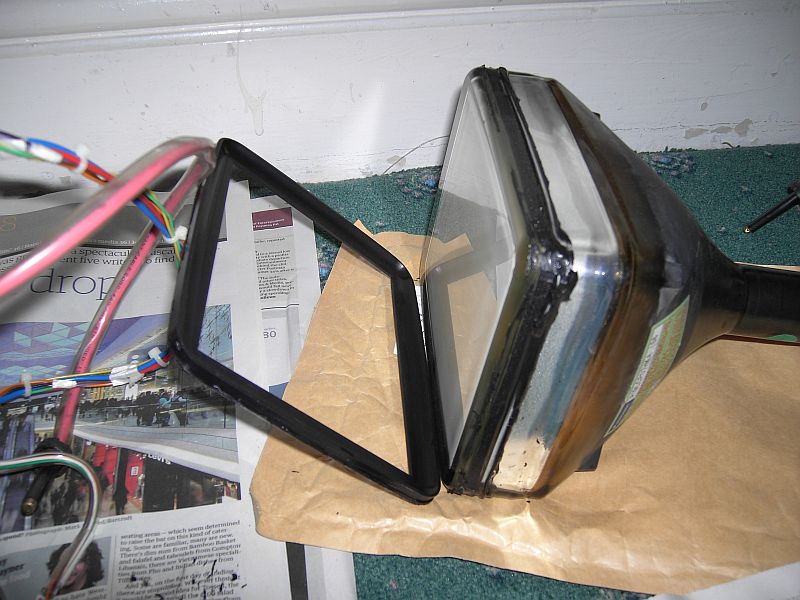

the third piece that is on the other tube but still stuck to the old lc chamber.
 Filesize:  152.49 KB

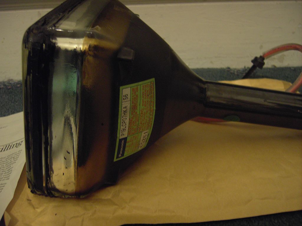

side view
 Filesize:  84.65 KB
p19 old green tube
 Filesize:  84.1 KB
The more I learn
the less I know.

Start bottom up with the pic it may make more sense, sorry it uploaded in reverse order to what I expected. If you look at the new (fungus) lc chamber it has no rectangular piece in it, the piece is stuck to the frost of the tube, the old lc chamber does have this piece stuck the chamber and not the tube though so I am not sure wether its meant to be stuck to the tube or the chamber or both?

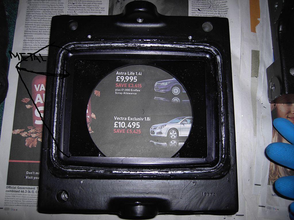

The piece I was wondering about.
 Filesize:  317.75 KB
 Viewed:  7234 Time(s)

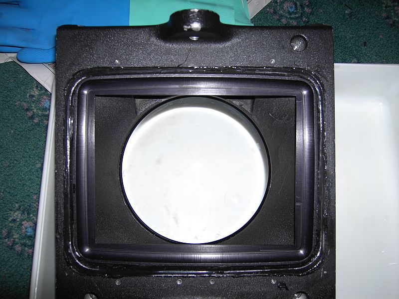

lc chamber with no perimeter piece for the tube to rest in.

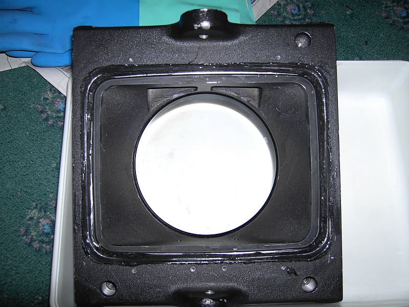

 Filesize:  114.16 KB
 Viewed:  8138 Time(s)
lc chamber with rectangular perimeter piece for the tube to rest in.
 Filesize:  103.57 KB

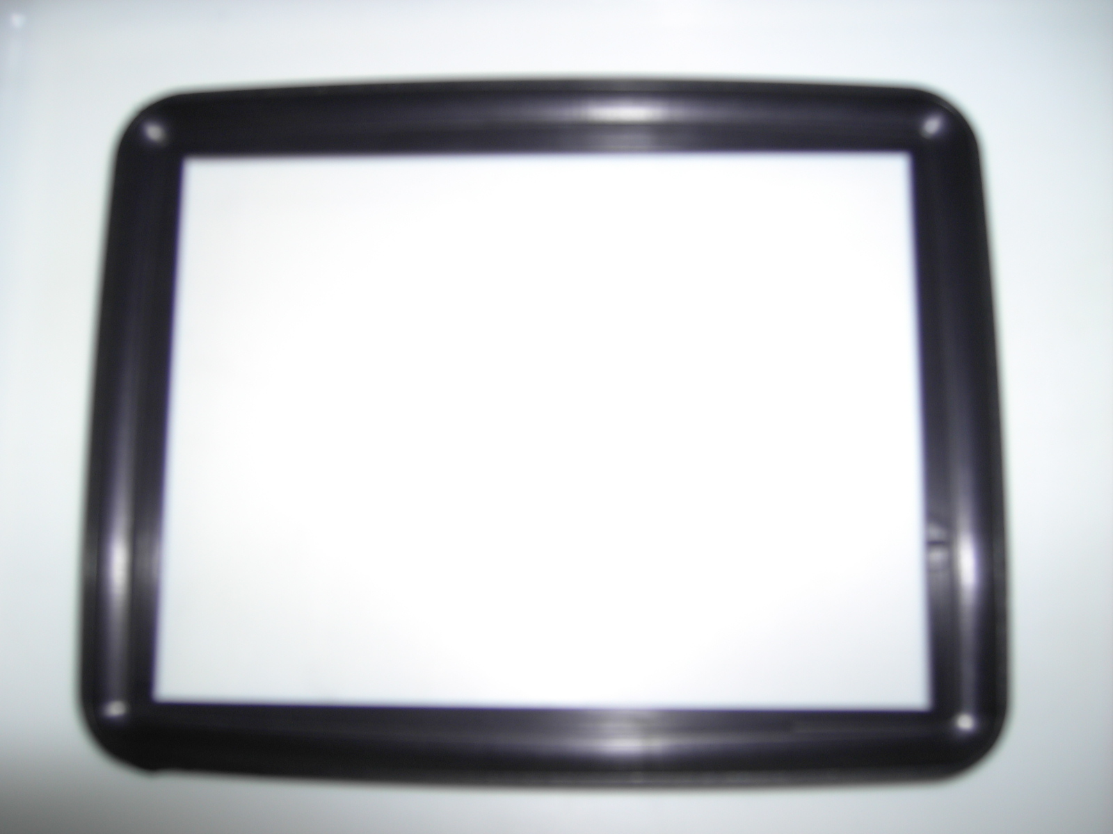

this is the rectangular piece I was on about.
 Filesize:  152.49 KB
thats the metal perimeter piece just resting next to the old mec tube. Its the black rectangular piece.
 Filesize:  101.08 KB
mec tube with perimeter piece on, this piece seems to center the tubes face, this piece was on both lc chambers, actually one was stuck in the lc chamber and the other came out with the tube. Not sure if it should be on the tube or the lc chamber as a rul

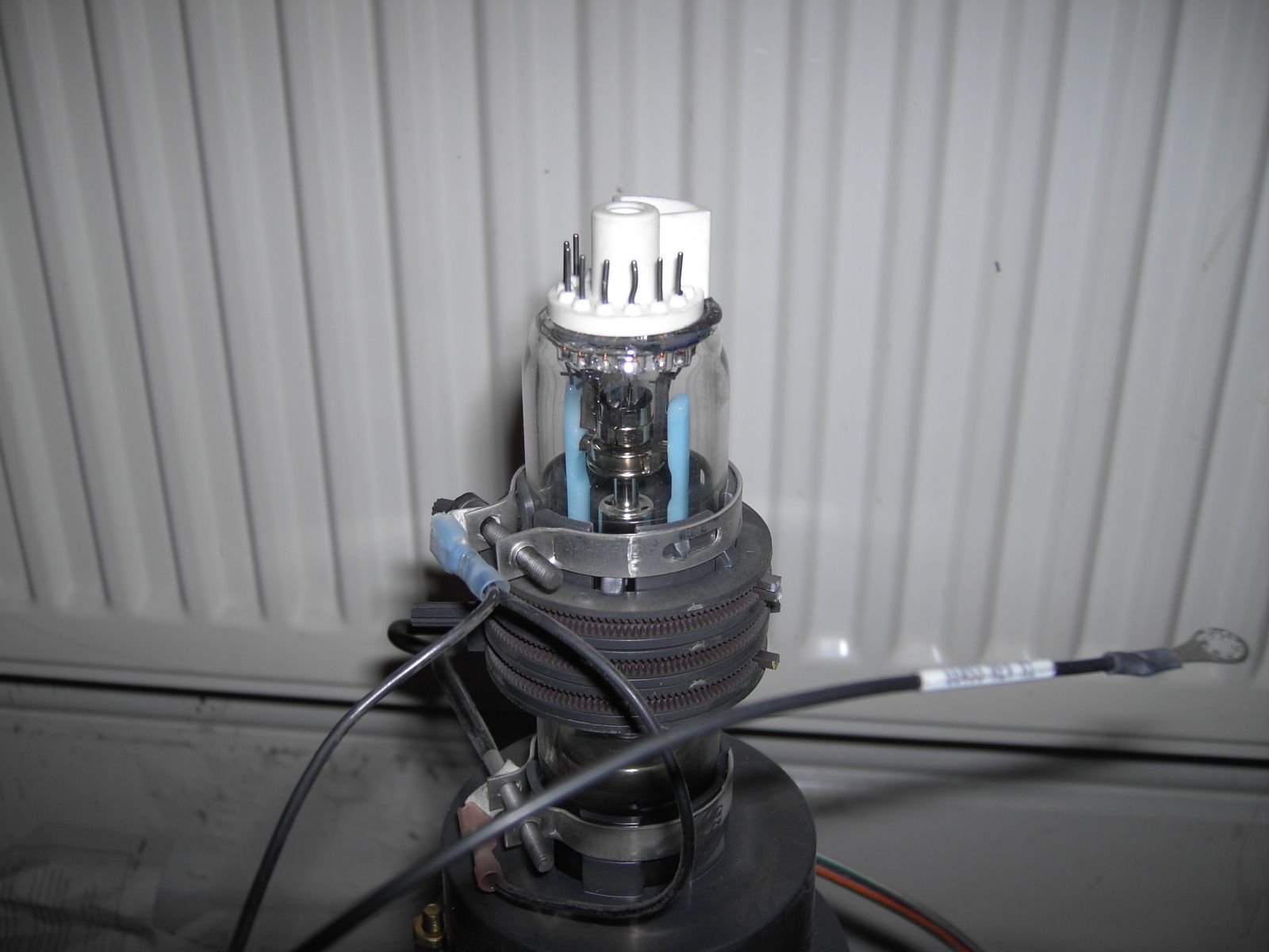

blue blue guns tube, still do not know what tube it is!
 Filesize:  129.86 KB
 Viewed:  7236 Time(s)
The more I learn
the less I know.
Posted: Thu Dec 18, 2008 12:07 am    Post subject:
Looks like a p19 tube maybe. I have a p18 here and it has the same guns, and lower metal tube that the blue pieces are connected to.
