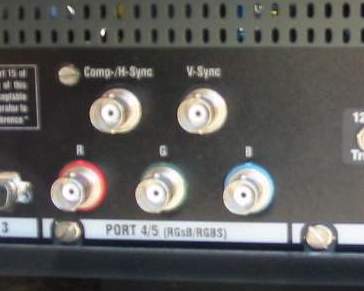

jkruger
Joined: 24 Oct 2007
Posts: 2435
Posted: Thu Dec 11, 2008 1:52 pm    Post subject:
It should be connected to the bnc connector labeled Comp-/H-Sync.

Posted: Thu Dec 11, 2008 10:20 pm    Post subject:
Do the green LEDs on the RGB switcher board change when you change inputs from 1-5? When in video mode feeding a composite video signal, does the green 'video' light stay on? you might have an RGB switcher board issue.
Now I think I understand,and below is exactly what I have done
Connected the composite from my set top box to the Comp-/H-Sync of the pj.
Switched on pj and noticed that only 3 led's are lit,they are
1-hdtv
2-c.vid
3-rgb
I did change inputs from 1-5 and noticed that all three including the c.vid led remained on with no change.
