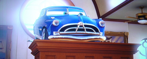

I couldn't resist with all the talk about expensive projectors and scalers. This is a screen shot on a 100" diag screen. It is std def scaled to 1080P from the armpit of all scalers (TAW Rock+SDI) and projected by the butt end of all projectors (AmPro 4600HD). The image was provided by a SDI modded DVD player.

Chip,
That screenshot looks really bright, is that how it really looks or is the camera doing it? 100" Diag also seems small for a 9" machine, is there a reason you went with that size?

dude you don't have to convince me that the Ampro 4600 has a killer image, I think that is obvious
post some big screenies for us Wink

No that's just the lower intestine. I think I got the butt end of the stick. Laughing
