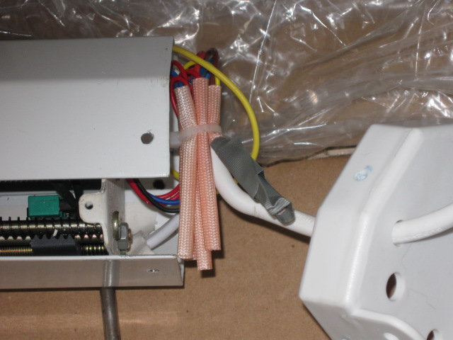

got my card yesterday and it works like a charm i fixed my screen too. copper wiring inside the screen hit the chassis.
 Filesize:  90.11 KB
 Viewed:  14295 Time(s)
